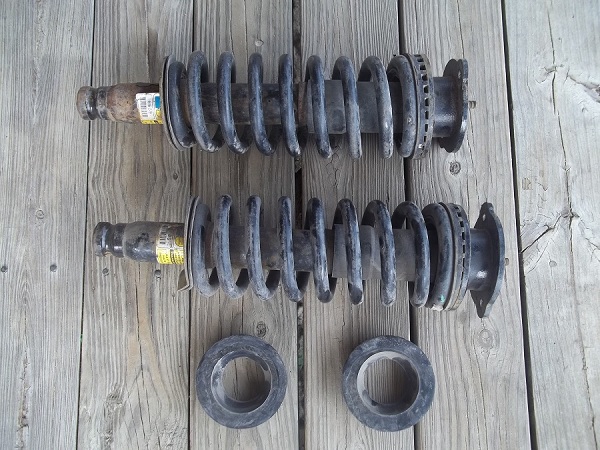

Look what the guy in the brown truck brought me this afternoon.
I stopped by Advance Auto and picked up a few 1 1/4 3/8 bolts with locking nuts.
They need a little cleaning and maybe a coat of flat black and they'll be good to go.
Hopefully I get it installed tomorrow!

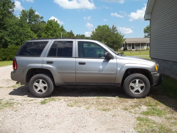

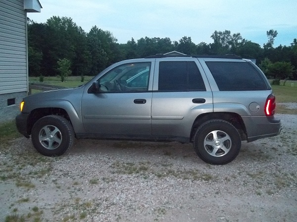

by navigator » Sat May 14, 2011 10:19 pm
Ok, I got the lift on. Woo Hoo. My wife was like "is that all?" I told her we could get a body lift to add to it for another $400. She likes jacked up trucks etc. Maybe later :-)
I had this great plan to take a lot of pictures as I went and document everything but that didn't work out too well. I got all greasy and didn't want to mess up the camera.
The RC lift went in pretty easy once I kind of figured everything out.
I bought a used lift with the spacers already attached to a stock springs and struts so I didn't have to mess with compressors etc.
The main hangups were that you have to take the bolt out of the lower strut mount in the front to get the strut out, it took me a few to figure that out. I also needed more travel and tried to disconnect the end links but they just kind of spun and wouldn't come off then I remembered someone posting about disconnecting the sway bar. I ended up loosing the mounting bolts until they almost came out and that gave me enough play. I think it might work better if you disconnect both sides at the same time and then put both struts back in place.
The rears were easy, I just moved one of the brake lines from it's mounting location on both sides, disconnected the rear shocks and lowered it down with the jack slowly until the ebrake line was pretty tight and the springs came out pretty easy. There was a thin rubber piece on top of the spring that I had to remove and I put the spacers in and put it all back together.

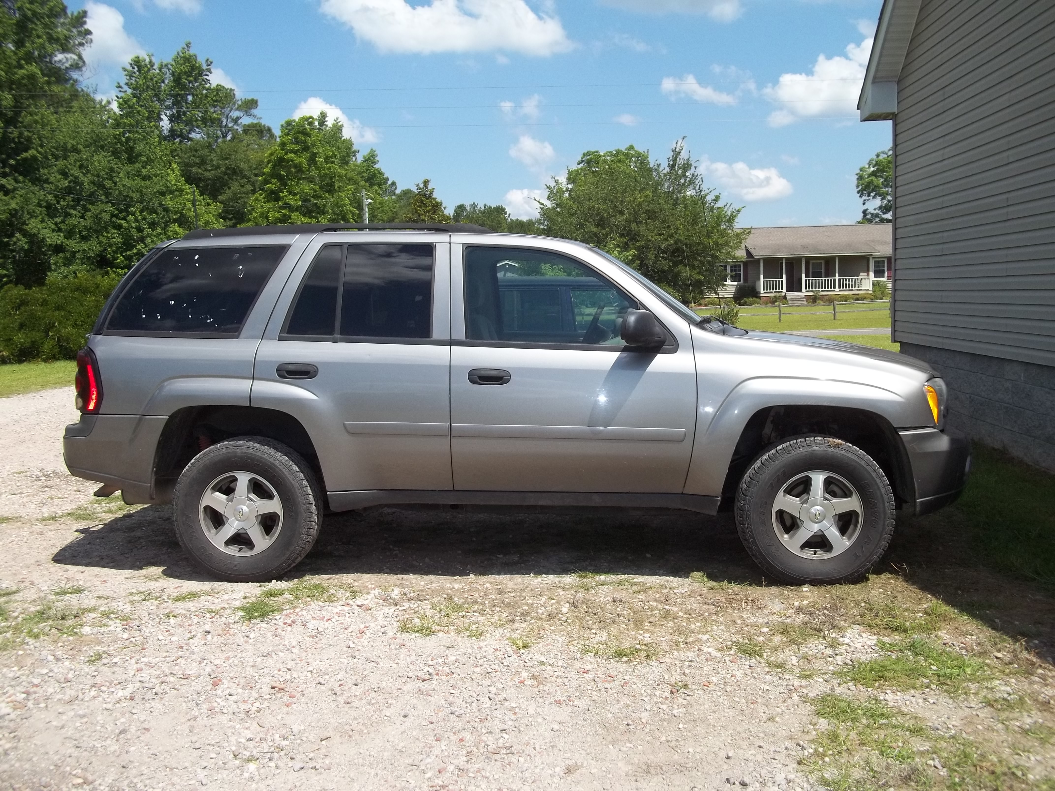

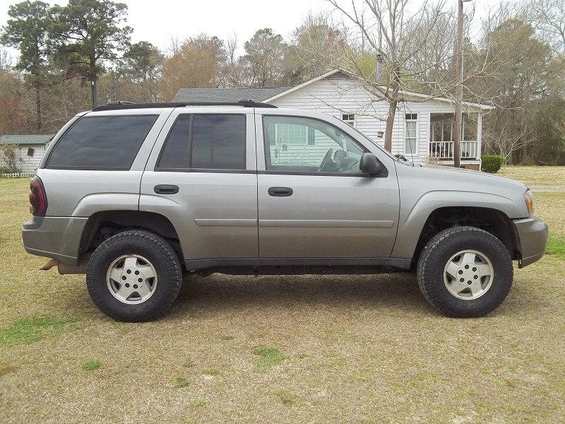

by navigator » Sat Feb 11, 2012 6:38 pm
Updated pic with the Mark's top spacer and Z71 springs. I'll try to get a better pic later

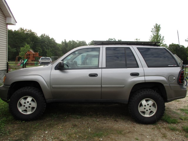

by navigator » Thu Apr 04, 2013 8:06 am

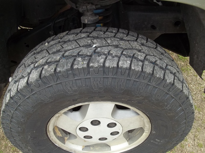

I got my new tires installed yesterday, Toyo Open Country AT2.
The tire guy said "they call for 80lbs but I only put 60lbs in it." I rode about a mile up the street and dropped them down to 45. They ride well and are pretty quiet, just a slight hum at highway speeds. I'll do the chalk test later to see where my air pressure needs to be.
This is also the first pic posted with my "new" Tahoe wheels and the Zone Body Lift.
Roughly 4.5" of lift in the front overall and about 4" inches of lift in the rear overall.
They are actually meatier than I thought they would be from looking at pictures online.
