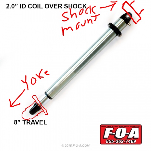

Well, any machine shop could turn an adapter, just measure a stock shock bottom and mimic it, then thread it for the shock. Should be reasonably inexpensive.
by bartonmd » Tue Nov 03, 2015 5:58 pm
v7guy wrote:Why hasn't one of us taken a generic rod ended shock, made an adapter for the yoke and welded a shock tab on a round plate that bolts into the stock location? You could probably do it for 2/3rds the cost of the radflos. May not be quite as good, but should be worlds better than our current options.
If I understand you correctly (maybe need some bad MS Paint?), that won't work because there can't be a hinge in between the upper strut mount and the lower control arm.
by v7guy » Tue Nov 03, 2015 6:58 pm
Basically mimic the Radflo setup is what I'm saying, all the rod ended shocks I've messed with had a thread on the shaft end of the shock and the rod end was screwed onto it.
I'm just saying, unscrew the rod end, and screw on a yoke adapter that was turned in a lathe. It'd be a simple piece to machine. Bet you could get a couple made for under $100
If that's not making sense I can scribble something up.
by bartonmd » Tue Nov 03, 2015 9:40 pm
Oh, I gotcha... I thought you were talking about attaching something to the factory forged iron piece, and having a normal rod-end style double-shear through-bolt setup.
Yeah, the only thing you'd really have to watch is how structurally strong the struts are in the rod. Factory has the rod at the top side for a reason, and it has to be quite a bit stronger to be in the middle, not the high-leverage (low load) end.
by TBYODA » Tue Nov 03, 2015 9:57 pm
Something like this.
