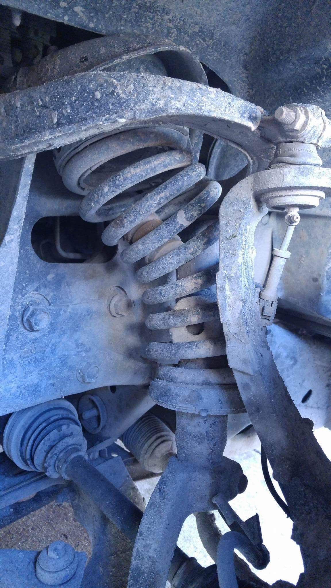

If you shocks or sturts are worn out they won’t dampen the spring bounce. In the front they could wear out the lift bushing and it fails then snap the strut like this.
by cpyonker » Fri May 04, 2018 7:25 am
Right, but would replacing worn out ones lift the front a little bit?
cpyonker
Posts: 303
by ETB1 » Fri May 04, 2018 10:55 am
The strut itself doesnt give you lift only dampens. The spring gives you the lift.
