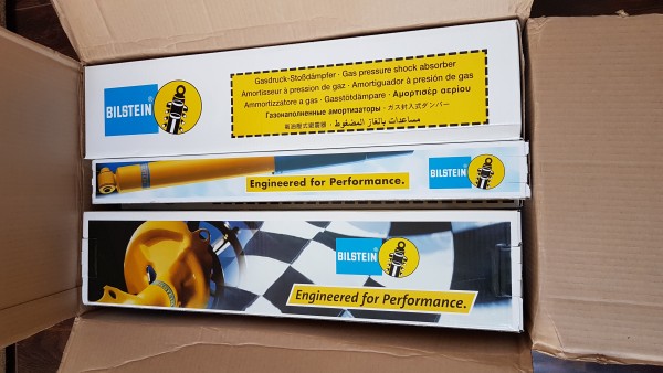

by TBLAZER_02 » Sat Jun 03, 2017 6:23 pm
The only reason I got the moog springs is because they seemed to be close to what was in there originally (885) ... BUT ... on another note my bilstein came in today yaaaa ... Just waiting for my rough country lift and my springs, wheel hub and brake kit from rockauto
Bilstein have arrived
