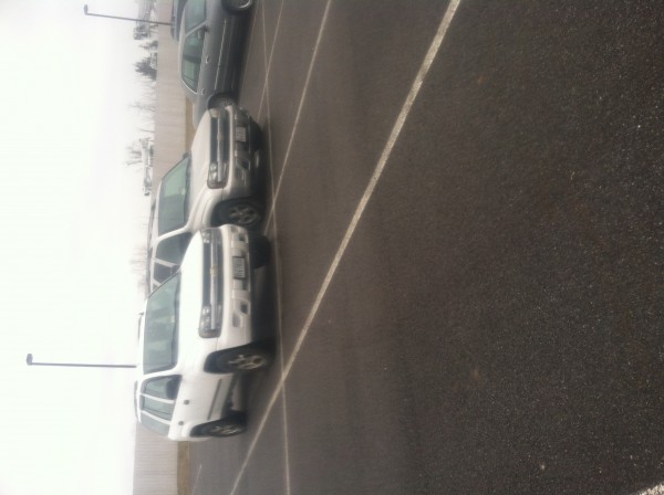

by TheHungriGerman » Tue Nov 29, 2016 11:33 am
I used 33 inch dick cepek extremes 2.5 inch spacers in the front along with moog 81112 Springs in the front and moog 81069 Springs in the rear. Image
