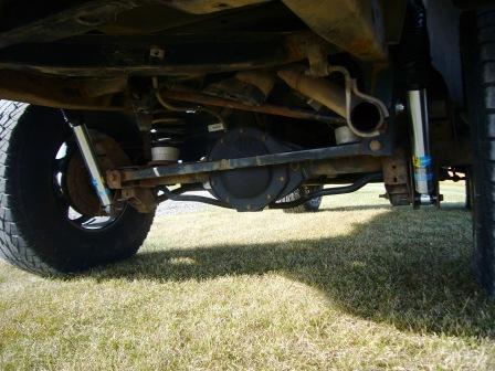

With Mark's 3" lift, 2" on the back I chose to extend the mount rather the use an adjustable bar. This mount extension keeps the bar near horizontal and the wheel movement as vertical as practical. This is a prototype to be tested but so far so good.
I measured up the frame mount and found 3" x 4" 3/16" wall rectangular tubing would fit snug on the 3" side.
To restrain rotation of the mount, a top hole and 16 mm bolt was added. A hole must of course be drilled into the frame. I used an 11/16" bit. All hardware is 16 mm.
The frame mount is angled inside which I measured was approximately 1/2" over the 2" suspension drop(lift) Therefore the hole for the bar is 1/2" farther outside from the original mount hole on the angled extension. Not parallel to the tube edge.
I had heavy wall aluminium tube available so I made a spacer for the stock bolt location. A smaller diameter solid spacer would be more appropriate.
The washers are added to take up the space between the bar end and the extension.
Interest? :)

Genius. Sheer genius. Have you aligned with this setup?

by fishsticks » Tue Sep 18, 2012 3:08 am
Nice Bilsteins... :mrgreen:
I guess my only concern would be the first time you side load the rear axle. That bracket seems like it might try to bend up near the top bolt without being fully welded in.
It may be that you never have a problem though. Looks good.

by TangoBravo » Tue Sep 18, 2012 3:15 am
Nice job. Keep us posted on any negative effects, but from what I can see you shouldn't have many. How hard do you wheel? Im very hard on my TB and so my only concern would be overall strength and durability of the relocation hardware, it seems like it would do fine. What's your opinion on this holding up to heavy wheelin?

by Lauron » Tue Sep 18, 2012 10:26 pm
Jeff, thanks for the complement but these type of extensions are pretty common. But, the concerns are valid with any new product, it does take some testing and design improvements should they be necessary.
The upper bolt is backed up with a large washer so it will take a lot to pull through but everything can break!
To your question of alignment, the wheel offset is very close, not the 3/4" offset without an adjustable.
