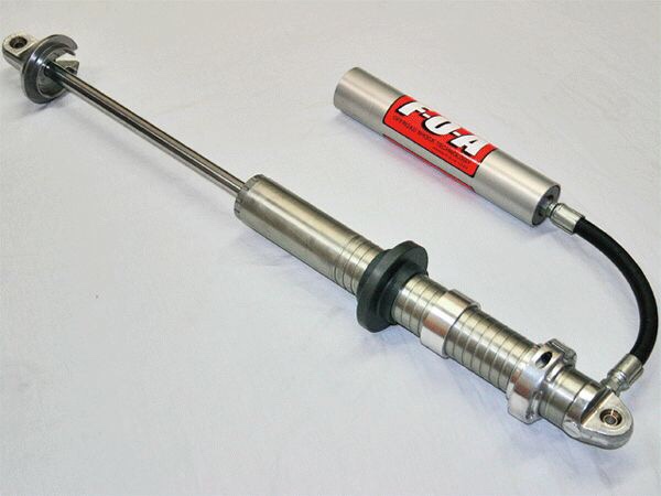

Make you own coil over say from a FOA shocks or some other type like this and just pick your spring rate. Would just need to mill top shock mount and the bottom mount that attaching in the yoke. The end of these shocks unscrew and should be pretty easy for metal shop to make the ends. A few of us have talked about it and think you could make a set for about half.

TBYODA wrote:Make you own coil over say from a FOA shocks or some other type like this and just pick your spring rate. Would just need to mill top shock mount and the bottom mount that attaching in the yoke. The end of these shocks unscrew and should be pretty easy for metal shop to make the ends. A few of us have talked about it and think you could make a set for about half.
I even have a set of strut mounts I grabbed from the Pull A Part for that reason. Anyone with a lathe and a brain should be able to make the lower mount.

A couple people did that with some other coilovers before Radflo jumped in and made a solution for us, and the ends of their shafts broke. Obviously, the stock setup is the other direction, because the larger bending force is in the middle, where the offset and damper meet, not at the top. I think the only reason the Radflo works and the others didn't is that they use a 5/8" rod and full diameter threads, whereas the other ones used cut down threads. I think I'd also want the aluminum to go up the shaft a little bit, vs. stopping at the base of the threads, for more support. (i.e. a counterbore)
by Jrgunn5150 » Fri Mar 04, 2016 5:36 pm
I'm not sure I'm following, although I did see where Roadie had a Icon coilover for awhile and it busted at the bottom.
My idea was simpler, just turn a piece of steel to fit in the lower strut mount, then machine a mount for a "Normal" eyelet on the top (where the bottom of the shock would go). One piece of billet, easy peasy. The upper mount should be pretty easy and straight forward. Finding a coilover that's appropriate might be more difficult.

You can't do that, though, with the lower strut mount. The lower mount needs to be solid. The joint between the offset that goes around the half shaft and the lower mount of the strut is floating, so the joint needs to be something that can't bend in any direction.

I already have plans scribbled down, it's something I've had sitting on the to do list for I think easily over a year now.
The FOA shock has a .75 shaft, so I assumed it would hold up as well as the radflo shock.
Putting a counter bore on the adapter was kinda a given in my mind cause you wouldn't really want to put all the stress in the threads. Maybe it would be fine, maybe not, wouldn't be a big deal to add the counter bore so it seems silly not to.
The upper mount can be as simple as a piece of plate that bolts to the body in the stock location, with a rod end shock mount welded on. Or a pretty machined piece like the radflos.
If we're talking about a rod ended shock like the foa or radflo, just bolting an adapter onto the rod end would probably amplify any side loading and make the assembly extra long and if you were machining it to fit around the rod end mount of the shock to make it rigid like it needs to be it'd be extra complicated. In my mind it would just be easier to thread the adapter and screw it onto the shock rod. But I may be misunderstanding too LOL
When I was toying with the idea originally I found I could get a lil more angle outta the CV and the balljoints (after the upper was flipped) and the tie rods, but the shock was the limiting factor, I dunno if in practice you can squeeze another .5 inch or a full inch outta it, but there was more available on my vehicle.
