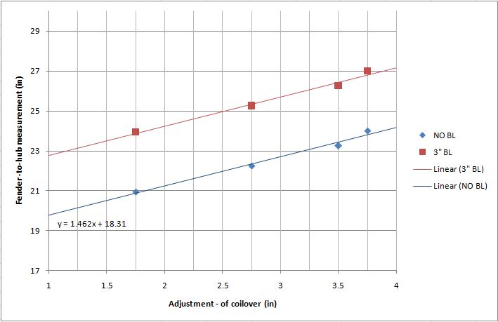

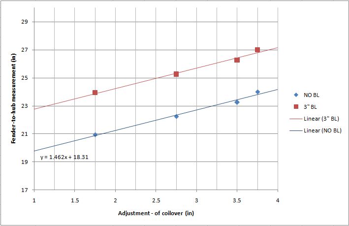

Once we get some more measurements, we can hone this chart in to be more accurate, but based on the measurements so far (Mine, Eric's, and Mike's), the following chart seems to be accurate.
Anyone else who has put their radflos on, please update this thread with a good measurement of your spring adjustment, and the measurement from your hub center to your fender's bottom lip.

by TBYODA » Wed Dec 18, 2013 9:07 pm
James do you care about how they come from radflo?
by Trail X » Wed Dec 18, 2013 11:04 pm
Sure, that's a worthwhile point on the chart.
by TBYODA » Thu Dec 19, 2013 12:43 am
MikeKey also took before measurement of the screw threads, from picture I see about 1 1/4". I got 1 3/8". Could call this stock. ;) Hub to fender on driver side 21", passenger side 20 15/16". I have no armor, no steel bumper, no body lift. Hmm my numbers don't seem to fit the chart.
by Trail X » Thu Dec 19, 2013 9:07 am
I got 1 3/4" as shipped, that's what Mike's picture says too. That would be a lot closer to 21in. Did you take a picture of your measurement? I'm wondering if you didn't measure it per the datums set earlier in this thread.
by Trail X » Thu Dec 19, 2013 9:12 am
Updated with Yoda's as-shipped numbers.
by TBYODA » Thu Dec 19, 2013 11:10 pm
JamesDowning wrote:I got 1 3/4" as shipped, that's what Mike's picture says too. That would be a lot closer to 21in. Did you take a picture of your measurement? I'm wondering if you didn't measure it per the datums set earlier in this thread.
:facepalm: Sorry read all the "standards" but typed in what I measured when I got them, which was not per the datum. :wallbash: I got the same 1 3/4".Gotta love the road salt NY uses. LOL

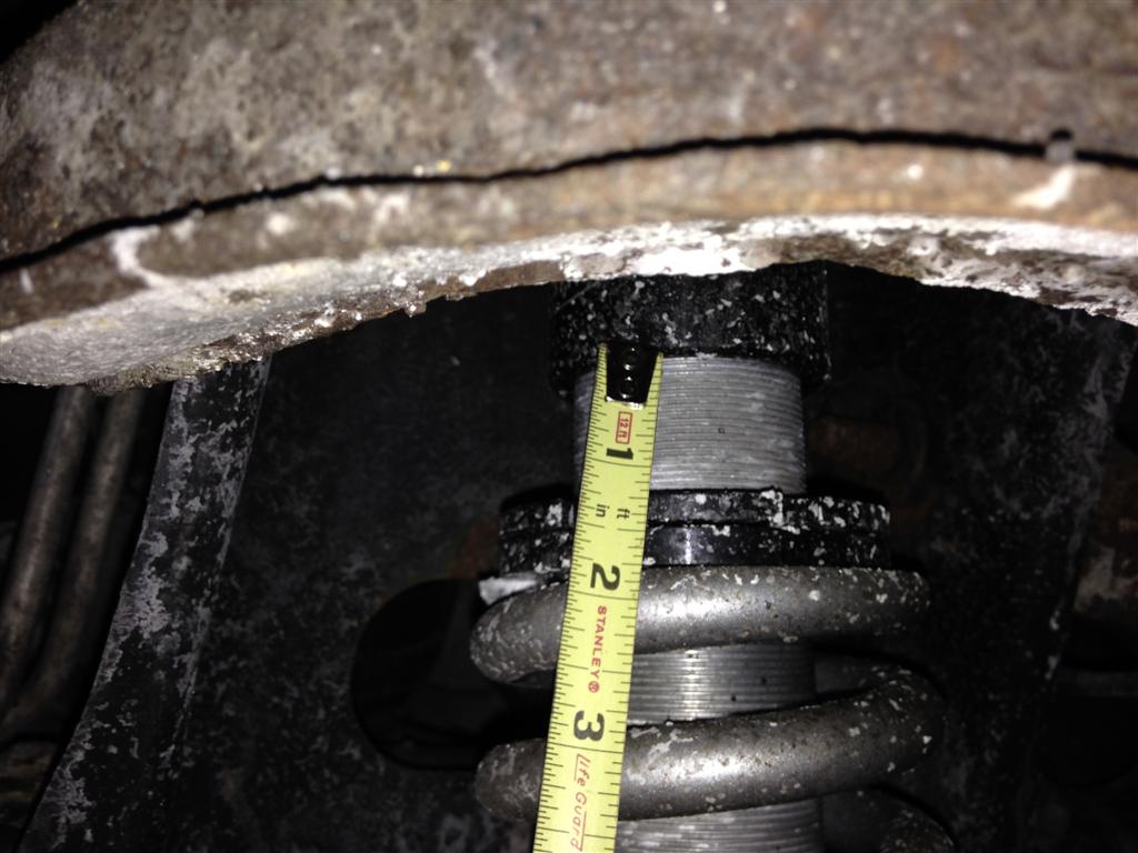

Got around to installing mine today.
NOTE: I have an LT which has an additional plastic shroud around the fender wells, so this may skew the measurements slightly. I just took a measurement of the plastic and it is about .25", and while the shroud is tight on the fender well, there is no guarantee that there are no gaps between the shroud and the fender well.
Weight:
No body lift, stock bumper, MDB rad skid, MDB oil pan skid
Before:
'83 springs, Bilstein Shocks, Liftmeister 3" spacer
After:
Radflo at 3.25" (see picture below). The picture shows just shy of 3.25", but when I tightened the locking ring on, I took it to 3.25".
All measurements are made with the tire mounted. I measured from the hub center to the fender. For the with weight measurements, both front tires are on the ground. For the without weight measurements, both front tires are off the ground. This should take the swaybar being connected out of the equation. The measurements between driver and passenger sides were surprisingly the same.
Measurements:
Before with weight: 21.5"
Before without weight: 23.5"
After with weight: 22.75"
After without weight: 23.5"
firefox2501

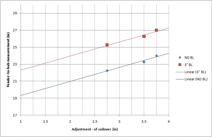

So far, Kyle's numbers are exactly the same as Eric's, and Mike Firefox's are right inline too. MikeKey, yours look higher than the trendline from what I can see.

by Trail X » Thu Feb 06, 2014 4:03 pm
Matt, that helps me zero without your hub center to fender height... but at the same time, you've got an envoy, which fenders may skew the whole thing. Do you know the difference in fender height between an envoy and a TB?
by Moots1288 » Thu Feb 06, 2014 4:05 pm
JamesDowning wrote:Matt, that helps me zero without your hub center to fender height... but at the same time, you've got an envoy, which fenders may skew the whole thing. Do you know the difference in fender height between an envoy and a TB?
I will tell you when I get home. Not stock but I will give you my measurement.
