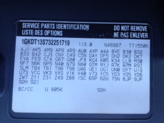

I've looked under my Envoy, and it looks to me like I have RF pink, and LF dark green, springs. I can't confirm with my RPO codes though. They don't match up with anything. Here's my RPO sticker. Any info you have about it would be appreciated.
EDIT: Posting RPO sticker. Any info about the springs you can provide is appreciated. Any other interesting facts you see about my truck would be cool to know as well.
TIA.
RPO sticker
photo (1).JPG (35.72 KiB) Viewed 126810 times
