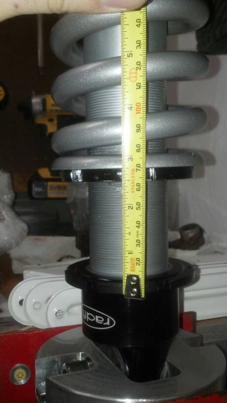

So I decided after a week of looking at it that I am going to reduce these down to 3.50 from 3.75. Some times it looks like the front is sitting a tad higher than the back, other times it looks level. And I started thinking about how it might look with more weight in the rear.

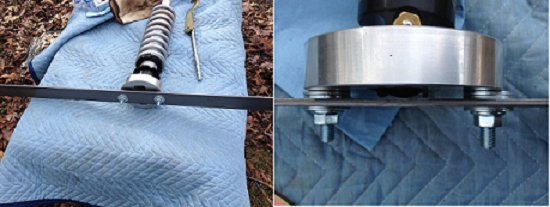

Adjusted the my RadFlo's today, In order to hold them for adjustment I match drilled a 2"x36" piece of flat steel, shimmed with a couple washers to clear the shock and start turning. It looks like one full turn equals 1/16 of an inch so take your time and try not to slip the spanner. It's easy to bugger up the treads. We're looking at a couple days of rain here so once I'm able to get back on it I'm gonna flip the UCA's, new upper & lower ball joints and install radflos.

Ok. As far as how to measure... I don't know What my problem was that Night... Haha. Measuring the way we've decided on... I'm at 4.25". As far as droop... I was equally wacked in the head. There is a line on my wheel hub I measured from. I measured 27" with and 27.5" without weight. No wonder it seemed to top out.
Ok. I went from 4.25 all the way to 3.5". I lost only 0.25" at the fender. I want to drive it this way but I might be following Mike all the way to 3". Let us know how that works.

Adjusted them to ~3.35" (from top of spring to black cap)

Set mine at 3.25"

I have them set a hair over 3.5". I was at 41" ground to fender, now sitting at 42.5". My down travel limit is 44" and there is no CV bind. I am thinking of trying the small spacer on the outside and see how it does.

I found my numbers to change dramatically when I started measuring from the center of the hub. I thought I had like 1.5" of down travel when in fact I had like 0.5" when I was cranked way down. If you don't mind, check at the extended vs vehicle weight measuring from the center of the hub. I think I was including some of the tire and other flex that I shouldn't have been.

Set mine to 2.75". Got 22.25" hub center to fender (no BL), right where I wanted to be. I didn't measure extension distance, but I knew I was in the clear.
