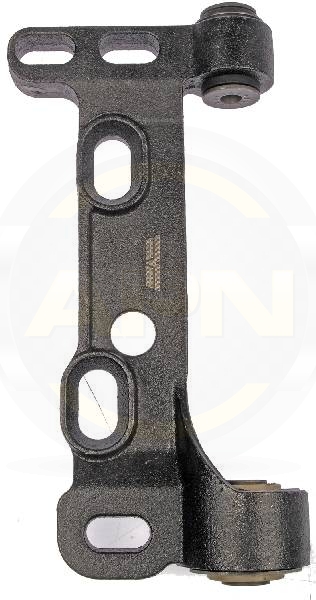

On my previous alignment, we only pushed the LCA out to correct the camber. I would like to correct the caster, currently at -1.85 and -1.95, to the positive spec. Before I take the TB to get it aligned, I was wondering just how much caster correction is possible with the stock LCA mount. From the discussion, it sounded as if most could not get back to spec even if the alignment shop knew what they were doing.
The Roadie wrote:How again did you move the LCAs around? Mill the slots larger?
Has anyone milled the slots in the LCA mount bracket to increase the caster adjustment? Which holes? How much was milled and how much increased caster adjustment did you get over the stock range ?

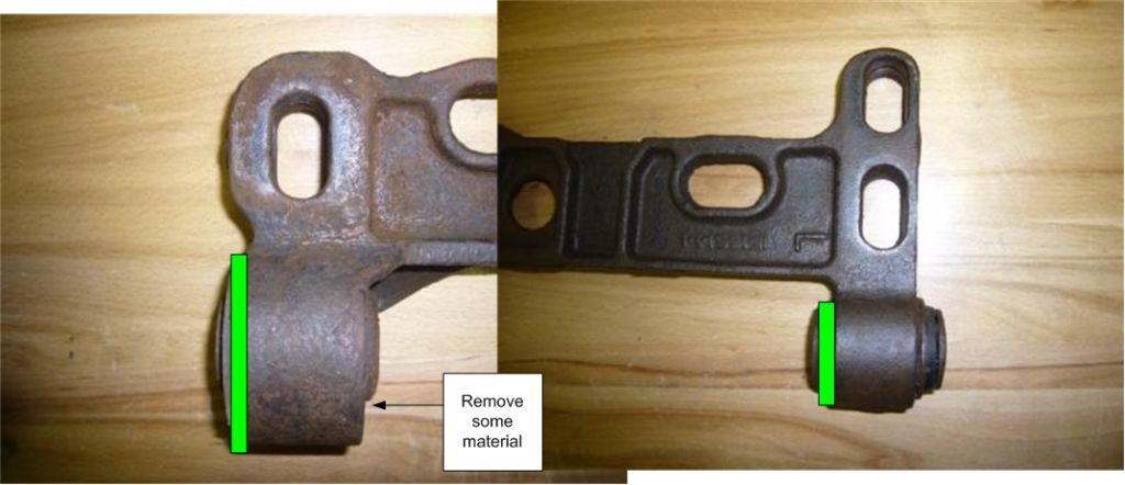

by Lauron » Fri May 24, 2013 10:50 pm
Guys,
I am finding out that some of you who have flipped the UCAs are accepting either negative caster or positive camber because there does not seem to be enough adjustment in the lower A arm mount to get both correct.
I did not get a response to my last email so here is what I know and propose as a solution.
1. The rear dual holes in the lower mount are too thin to mill any significant amount to increase adjustment. I calculate I need to move the lower mount at least 5 mm forward to change the caster from -2 to +4 deg.
2. The bushing pivot ends are quite beefy, so some material could be removed from their ends with out risking a failure.
My proposal is to press out the bushings and re-install with 6 mm (1/4" ) spacers to shift the A arms forward. The large front bushing only sticks out 7 mm on the inside so it will be tight with the A arm. I will probably need to remove some material from the inside edge of the lower mount pivot to ensure the lower mount does not touch the A arm. The rear bushing has greater off set so it will have less of a contact risk. The rear bushing will have to be installed from the opposite side (the inside). The attached composite picture shows where the spacers would go.
Anybody see a problem with this?

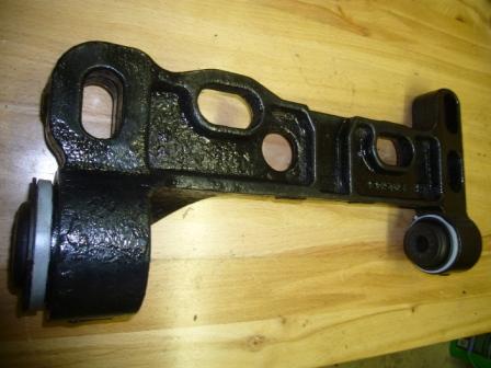

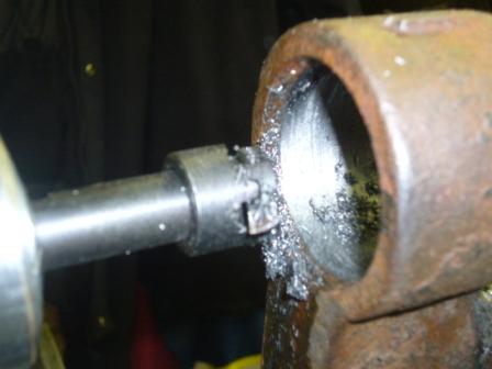

Adding the spacers was a little more complicated than expected and I did not get the result expected.
First, the rear bushing is stepped so to install the bushing from the inside direction required milling the step out of the mount. Not a big deal but then it is only tight on the inside edge. So I epoxied the bushing into the mount.
The finished product shows the the 1/4" spacer on the large bushing (front) and the 1/8" spacer on the rear. This results in the same bushing position as stock but both bushings are now offset by 1/4" forward. This should have resulted in a 6 degree positive caster improvement.

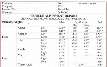

The TB actually drives better now. The steering is easier to return to centre and a previous pull is gone. But the caster is worse :o
From the previous -1.9 caster we could only get it back to -2.63 and -3.1. So we lost ground.
I am baffled. Either the previous alignment numbers were bad which adds up because it was harder to return the steering or something else has changed?
Anyone have any ideas what else could cause a shift in the LCA position? The ball joints and bushings are tight.
