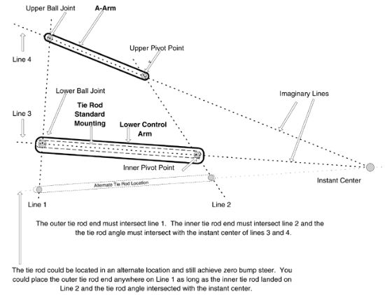

The bds drawing and discussion may help. The principle is the UCA, LCA and Tierod must line up at the instant center with the outer and inner pivot points also lined up to avoid bump steer. With unequal length arms, I believe zero bump steer only happens at one position over some range of travel, not full suspension travel.
So, if the LCA is moved out, the inner tie rod end needs to move out as well. Of course the outers are not moved from their alignment.

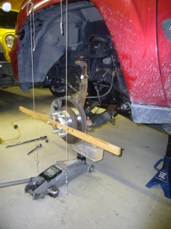

To measured the change, I bolted a straight stick horizontally to each of the hubs and measured the distance between drivers side to passenger side front edge and rear edge of the brake disk. To keep the measuring tape straight I used a level from the stick down to a constant height. Since the wheel(disk) moves in and out with travel the change in front to rear provides a distance change to calculate the angle change over the disk width (13.5").
I know this is definitely something I should have gotten a picture of. I will do it on the next check.
A little trig (arcTan) and the compression of 2" caused a 2 degree toe in change and the up travel of 5 1/2" resulted in just under 5 degrees toe out. As a check this was 1.6" of front to back total change at the disk edge.
A total of 7 degrees change was obvious to see with the 3' long sticks I was using. So for highway travel 1 to 2 inches of travel results in 1 to 2 degree of change in toe angle. Too much and noticeable to drive on the highway? Anybody know if this is significant or not?
This was with the UCA flipped. To return the UCA back to stock, I would have to realign the LCA before I could re-measure toe changes.

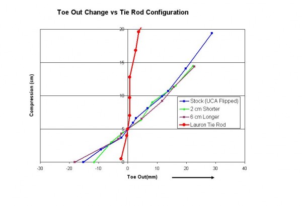

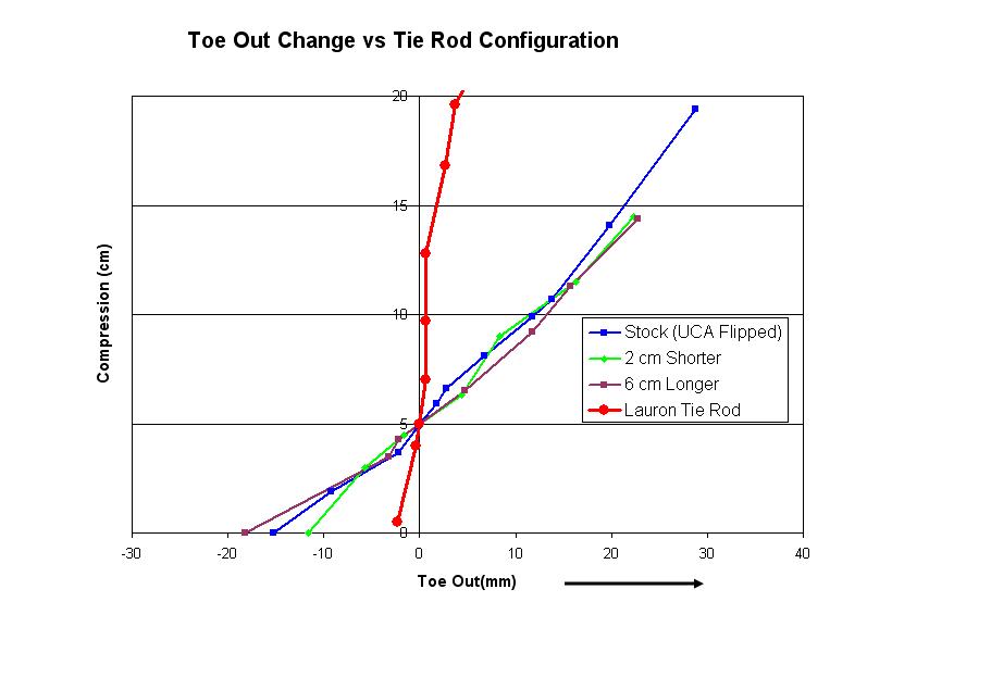

by Lauron » Fri Dec 14, 2012 10:57 am
Been a while sorting out a solution.
First my alignment specs were:
Camber -0.72, -0.61
Caster -1.85, -1.95
Toe in 0.1, 0.1
So caster was out of spec and I hope to have it corrected or at least improved with the next alignment. We only pushed the LCA out.
As I previously suggested, I was getting bump steer while most of you did not have a problem. I cannot explain the difference but once I saw it, it was significant . The first pic is the way I measured the amount of toe change. I measured from the stationary strings to the marked board(front and rear edges of the brake disk). It is not real accurate but did direct me to the solution.
The chart shows the toe change for 4 configurations:
1. Stock is with the flipped UCA where I felt the bump steer.
2. 2 cm shorter would have been the solution of using a spacer between the inner tie rod end and the steering rack. This was the solution I thought would work because the UCA was moved out about the 2 cm. To my surprise minimal improvement.
3. 6 cm longer - so now I started the trial and error search. I could have tried to draw it up but this was easier. The longer tie rod would have meant shortening the steering rack - not a nice solution. Fortunately it didn't work.

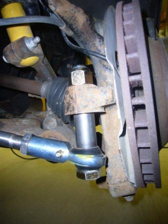

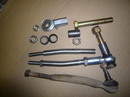

4. Ultimately, I found lowering the outer tie rod end gave improvement and I landed on a 35 mm drop of the stock tie rod. The Lauron tie rod is presented in the chart and is shown in the last pic.
The solution is a Q1A 3/4" female greaseable rod end with 3/4" Seals-It seals. This rod end has 24 degrees of misalignment. I calculated I needed 21 degrees. To lower the rod end I machined a 3/4" tube spacer 40 mm long. The Q1A rod end is narrower that the stock end. This spacer caused the heim to only achieve 15 degrees of mis-alignment. In hind sight, a bigger rod end with misalignment spacers down to 3/4" could be a solution. Since I had these, my fix was to bend the rods.
The rod is 3/4" 4140 rod threaded to 3/4" fine for the Q1A end and 14 mm fine for the stock inner tie rod end, both right hand thread. I had the rods bent to just over 8 degrees to get back to approximately 24 degrees of misalignment on the downward extension of the suspension. No binding with compression of the suspension.
I have only driven it once but the bump steer is gone.
Concerns: lowering the rod end will increase bending on the spindle and the 3/4" grade 8 bolt and spacer clamping on the rod end inner ball face could loosen up and wear. So I will have to sort out high high I need to torque the 3/4" bolt. I do believe the outer end is far stronger than stock so the inner tie rod ball end will be the weak link. Time will tell.
So I do have a request of the members if your are pulling your front springs is to cycle your suspension and measure the amount of toe change. If I would have know it, I would have measured the stock change but I can't go back now.

by Lauron » Fri Dec 14, 2012 11:03 am
Lauron Tie rod installed.
