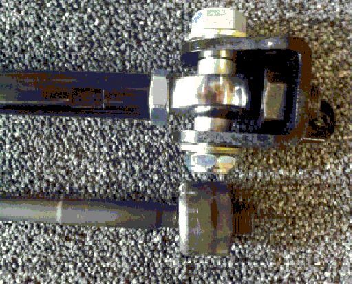

I tried moving the steering rack lower, by removing a rack bolt. This did not help. When I loosened the inner tie rod end leaving one thread engaged in the rack, I got an improvement. This pushed the pivot point out about 1/4". So my conclusion is the inner tie rod pivot point needs to be moved out board to compensate for the LCA being farther out. Anyone else observed this?
A possible solution: an adjustable inner tied rod end. The inner tied rod end screws into the steering rack with a 18 mm x 1.5 mm pitch thread. I propose to use a matching 18 mm female clevis attached to the steering rack with an 18 mm stud. Stud length to be determined. The attached FRP example is a poor boy example but I propose to use a solid clevis The clevis, unless something is available, would be custom to match the heim. To strengthen the tie rod, I would bump the rod size to 16 mm expecting to match up a male heim with a male outer tie rod end through an adjustable straight tube with weld in left and right hand thread tube adapters. I was looking for something like the attached Moog end to match our spindle.

by Trail X » Tue Sep 25, 2012 8:49 am
Interesting... so your theory is that there is significant enough of a difference between the locations of the tie rod inner joint and the lower control arm inner joint that it creates significant roll steer?
I'll be honest, I have my UCAs flipped, and I've never really had any complaints, but I do agree that mine doesn't track great in heavy crosswinds.
Anyways, the basis of your solution is in extending the inner ball joint pivot point away from the rack, right?
