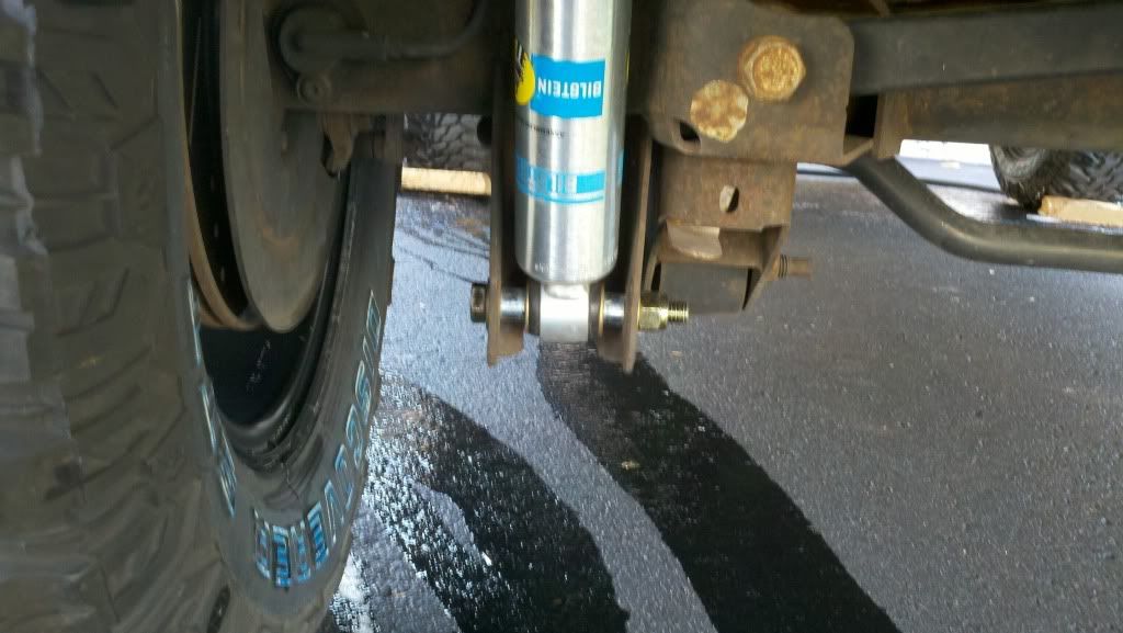

by Lauron » Sun Feb 03, 2013 6:11 pm
Cody, what size bolt did you use? The Bilstein uses a 1/2 sleeve and then a 1/2" bolt is required.
I ended up making 1/2" ID spacers with washers to centre and tighten on the bushing inner metal sleeve. This allows the shock to pivot in the mounting bracket. I initially installed the shock with washers but this did not allow much flex and I was worried I would wear out the shock prematurely.
This pic shows the shock mounted "upside down" because it collected water inside the boot when I had it mounted boot up. This position avoids contact with body of the shock with the mount that some have experienced. I have not yet flipped them back over, boot up, with a hole in the boot to drain the water.
Ron

by fishsticks » Sun Feb 03, 2013 9:46 pm
5125s are pressurized gas shocks. It's fine to run them rod down.
