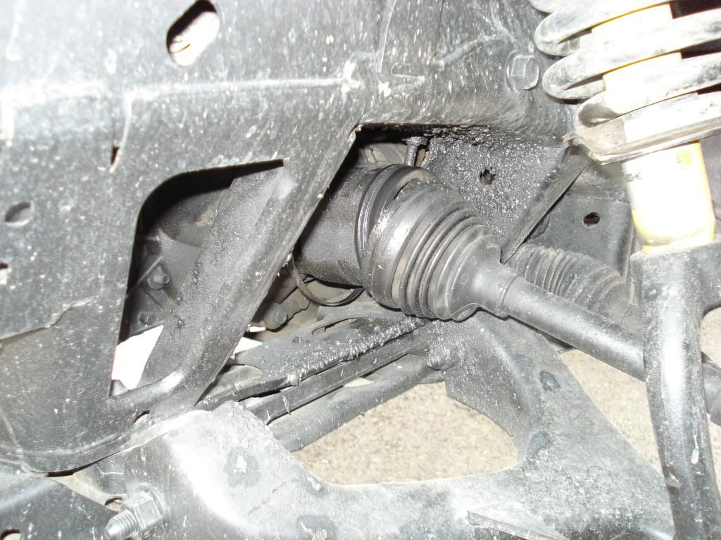

So I got my truck back from the paint shop .... but have a new issue . The day I dropped it off I had heard a tick tick tick as I drove and was like I'll look for that noise later . Well on the way home it bugged me and I pulled over and found this ...
How long can I drive with it like this and what the costs involved ????
These are the original CVs and boots so I've been LUCKY to this point . Kinda IRONIC that a couple days after I lift it to the max this happens :(

if the boots not ripped and just slipped off you could do what alot of us have done
and get large dia hose clamps. i would inspect it good tho and clean and re pack with
grease. if its shot get some cardone axles,they are working out great for me and alot
of others here. same thing happened to me right after i lifted. and yea im diggin the paint

by Trail X » Fri Mar 25, 2011 8:36 am
JamesDub wrote:... I had heard a tick tick tick as I drove ...
The "tick tick tick" indicates issues greater than just a boot.
I wouldn't drive any longer than to home depot to grab a hose clamp. The inside of the boot will get torn up otherwise.
And I don't think ironic is the word you're looking for... I think it's "expected".

by JamesDub » Fri Mar 25, 2011 5:42 pm
Thanks guys . Satin black pwder coat will be on the rims soon .
Since I work at Lowes I'll grab a hose clamp and try to fix it today .

by HARDTRAILZ » Fri Mar 25, 2011 5:44 pm
Don't forget some cv grease to replace any that has came out.
by BSalty » Fri Mar 25, 2011 7:56 pm
Wow you lucked out big time. Mine didn't last past the 2 1/2" lift for 2 hours b4 popping off. BTW it was only $23 (I think) per side for new boots for me. I upgraded to the longer ones in poly. It was a 1 day job first time.

by JamesDub » Sat Mar 26, 2011 4:53 pm
So I have been muscle-ing this damn boot and cant get it on . And yes I have searched for any tips or tricks before asking this .
Do you all have a trick for this ? I tried jacking under the lower a arm to get the CV shaft at a more level stance but the truck lifts off the jack under the frame . Just a tad worried about the jack moving and me being squished under the TB .

by djthumper » Sat Mar 26, 2011 5:14 pm
Maybe try a heat gun to warm it up more so it will stretch easier. It could be they are now just too short from drying out.

by JamesDub » Sat Mar 26, 2011 8:20 pm
Damn I just barely got the top on for the first time and it F-ing slipped back off . I'm about ready to have a small breadown :hissyfit:

by Trail X » Sat Mar 26, 2011 9:10 pm
Time for new boots. The stock boots may just be too stiff for big lifts.
by fishsticks » Sun Mar 27, 2011 1:00 am
JamesDowning wrote:Time for new boots. The stock boots may just be too stiff for big lifts.
Poppycock. :finger: I'm still using the stock boots.
Try knocking the CV tripod out of the diff. Bushing should be easy to get on then.
