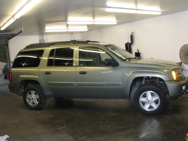

About a year ago when the truck was still my dad's I put a set of the Monroe Quick Struts on the front when it hit around 100k. I had been noise diving during braking and wallowed pretty bad in the corners. The Monroes fixed that but, it also left the front end sitting about an inch lower. He was ok with it since it drove better to I let it go.
I don't have a pic with the Monroes on but, imagine an inch lower than this.

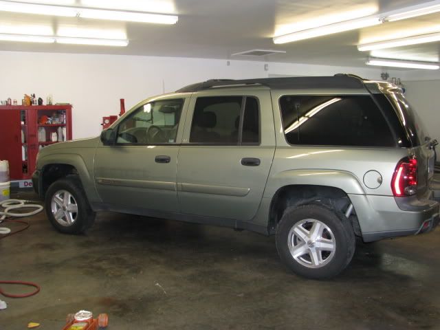

When I got it from him I knew I was going to need to address the issue. So, last Saturday I ordered Mark MC's 3" kit. It got here this Friday but, that's only because of the holiday. I glad my dad's a pack rat because be still had the factory springs and struts in the garage. I ended up using the Monroe struts but, junked their spring and put the factory springs back on. Whole thing start to finish took about 4 1/2 hours not including the trip to and from AZ for the spring compressor.

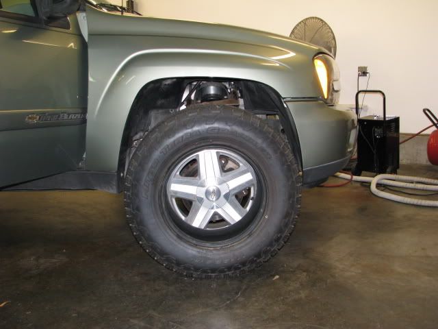

tallest part of the wheel well 36 7/16" front and 36 3/16" rear
idea of what it will look like with the 265/70/17 Nitto Terra Grapplers
