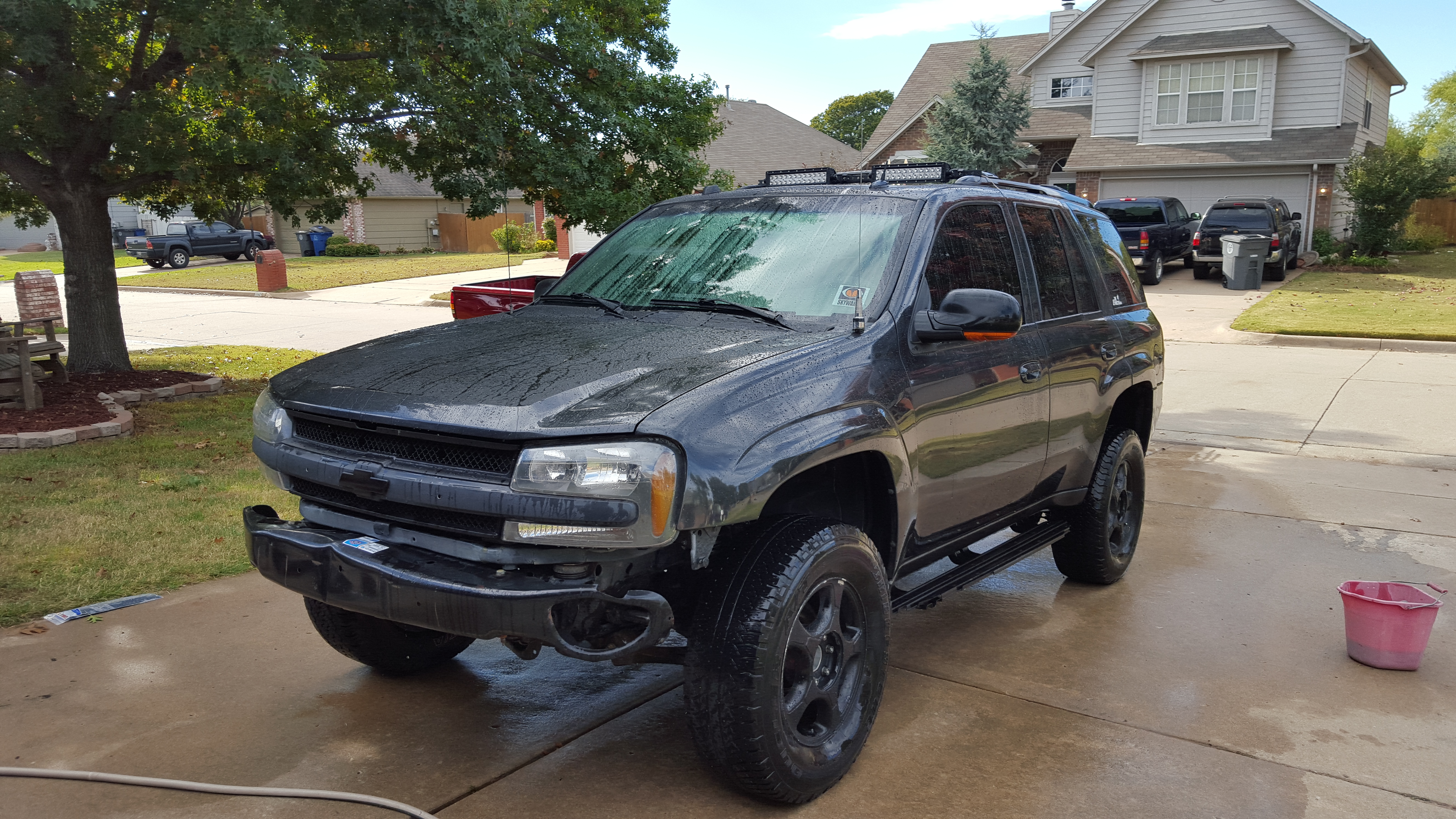

by eschy1990 » Mon Dec 07, 2015 9:33 pm
here it is today worn set of 265's
this is what it looks like with 265/70/R17's with Mark's 1.5" spacers

by Rickalicka18 » Mon Dec 07, 2015 9:44 pm
Looks good man! I think 275/70/17s be great. But like i said before, aftermarket rims will do a world of difference if you're looking for more of a wider stance and will also give you the ability to put wider tires on in the future. Personally, I'd buy new rims and tires at the same time (which is what I'm actually doing haha).
