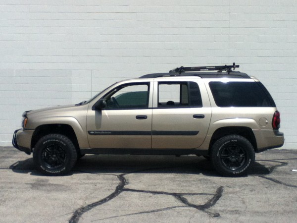

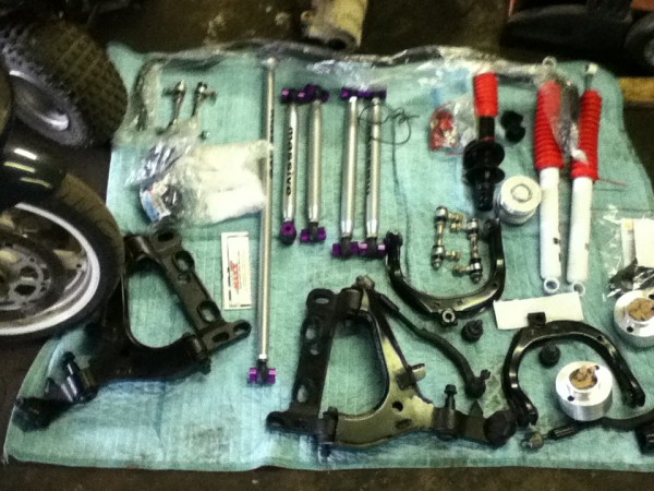

by kcb58h » Sun Sep 13, 2015 12:39 am
Goldilocks is a '04 2wd LS EXT. She has 3" LM spacers and 87s up front and 2" spacers and 83s rear. This landlocked whale rides on American Racing Marin 18x8s, with correct backspacing and offset, and stock 6x5.5 bolt pattern that lets her squat on 265/65/18 (31.6") BFG A/T TA KO2s without spacers. I have had zero rubbing issues but my off roading is limited to bunny slopes and fire road doubletrack. The only plastic surgery the Old Gold Manatee needed was 3" of the forward of the front wheel well liners removed. (Which exposed my aux lights to mud.)
Then she got Massive's GMT-360 rear end, a Hotchkis front SB kit, and S-Maxx SBELs all around. Instead of new suspension rubber up front, Lady GoldBrick got 4 new BJs, upper and lower FCAs and......... Now I'm just showing off 'cause of the "Radflo Envy" I'm suddenly experiencing. Those things are industrial works of art.
Alas, my GoldenRod is no longer the luxo-cruiser she once was. The 87s are much firmer than the 83s they replaced and it shows. Road trips are bothersome after 4-5 hrs of feeling every tar strip on the interstate. I don't know if the 'flos are more forgiving. This thing is 2wd - no CV issues for me to worry about.I have only myself to blame for foolishly choosing 18" rims. I did it to avoid spacers, but 70 or 75 series tires on smaller diameter rims would have compensated for some of that harshness.

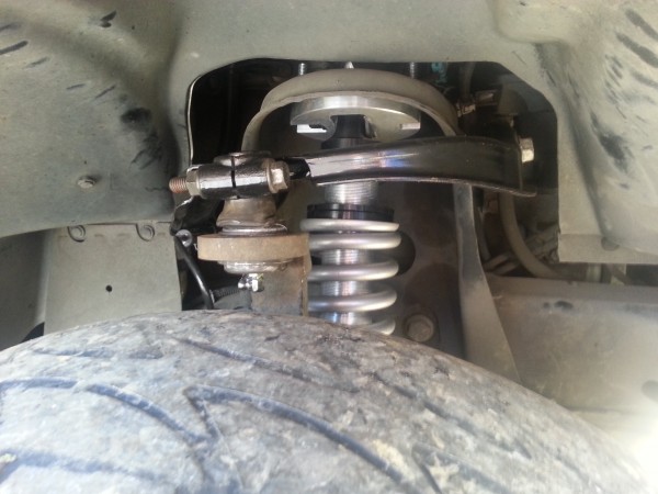

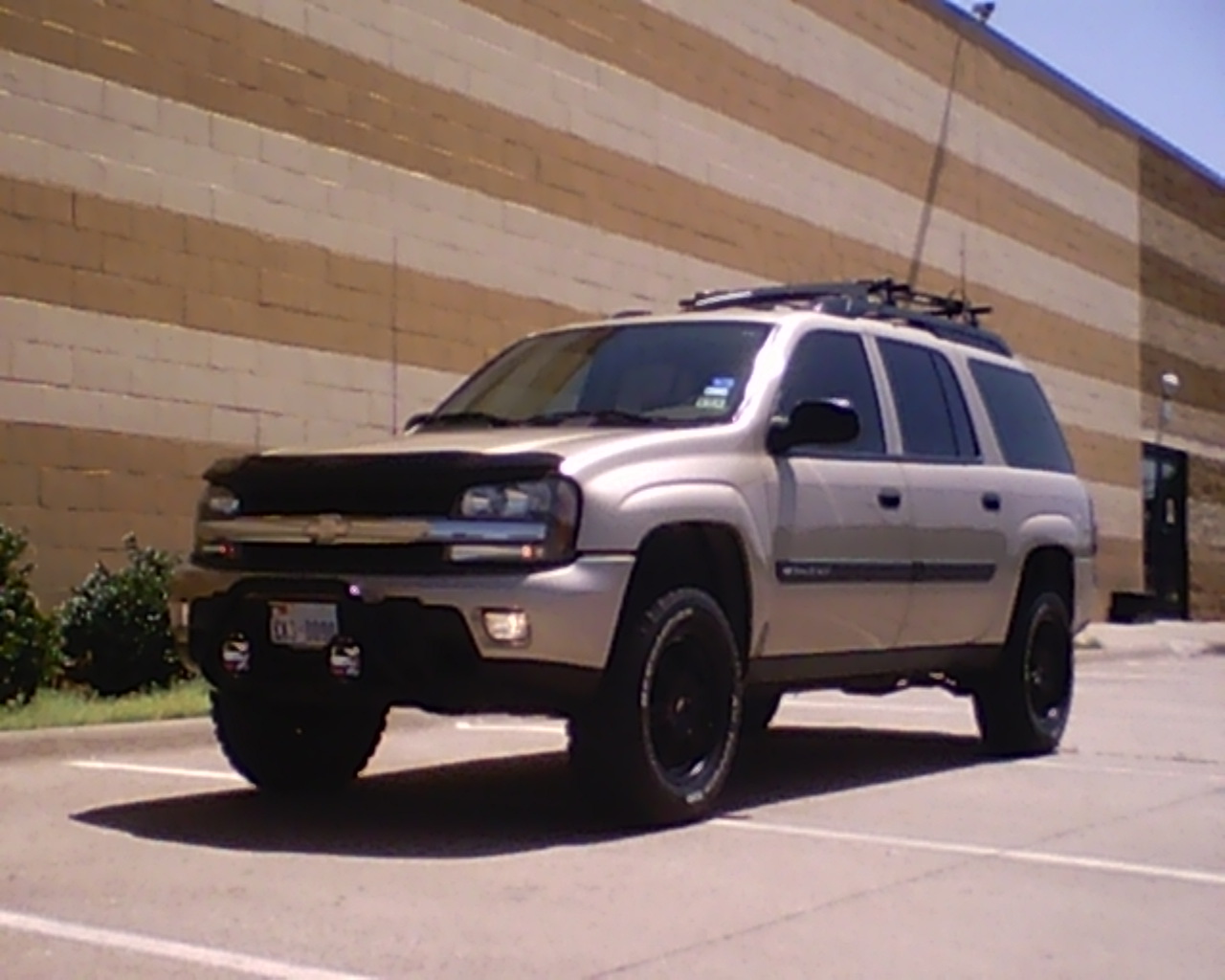

by thedeadtext » Sun Sep 13, 2015 8:02 am
Got a good shot over my old bald Firestones... lol
And yes I have not flipped yet.
$1900/pr? Who did you talk to there?

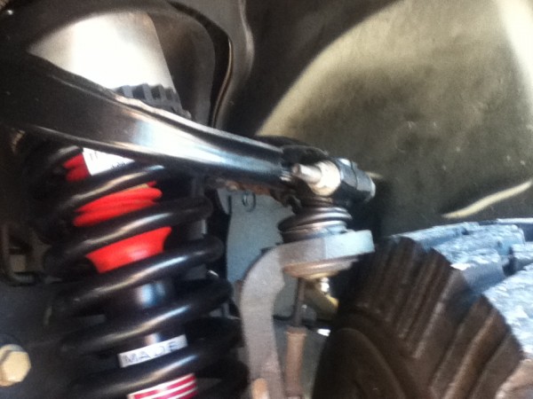

by maricard » Mon Sep 14, 2015 8:09 am
You should reverse your UCA to save your BJ

by thedeadtext » Tue Sep 15, 2015 7:21 am
Eventually :D
I keep getting engine codes I have to deal with.
If I can make it 2 weeks after a repair without a code, I will reverse em.

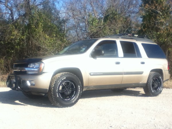

by kcb58h » Sat Sep 19, 2015 2:24 pm
Those 'flos are soo beautiful... thanks for the pic. I think long run spend the dime now. If I added up all the money I pi**ed away trying to avoid buying Radflos, I could have paid for them by now.
You mentioned trying on the 275s and saw how many changes would have to be made. I assume 275/70/17 (32.2") Were there rubbing issues? With your setup I'd think you could go up to 285 w/spacers (32.8") max. That's the largest I've seen w/o a body lift.
As to your question, my statement was misleading. The guy I talked to was NOT the builder. The person I talked to got disinterested when I told him they were for a TB. 'The guy charges $1900 and they take 5 weeks" he informed me in a tone meant to end the conversation immediately. That's okay - I get a lot of "Why the hell did ya do that to THAT?" I'm used to it. I'm glad you had a more pleasurable encounter. I don't want to ask what you paid, but was the $1900 bul***t? I have no reason to fib, but the mention of "Trailblazer" made this guy want to answer another line asap.
For anyone who cares, I forgot to mention the .75" upper spring isolators on the rear in addition to the 2" LM axle perch spacers. These were leftover from the 2" RCountry level kit I put on in '10. I didn't save the OEM isolators backintheday but I needed that .75" to level out.
Take a look at the attached. 265/65/18 BFG A/Ts on 18x8 6x5 "Discount Tire Recommended To Avoid Spacers" A/R Marins. No wheel spacers. Correct BS, but what a place to put a UBJ. Never shoulda bought 18s in the 1st place. In the GMT-360 world, 18s limit tire diameter choices and have narrower sidewalls that aren't conducive to offroad pleasantries.
This combo cost me $2200 installed FIVE years ago. Absurd.

by kcb58h » Sun Sep 20, 2015 8:24 pm
Look at some of my posts. I've had 265/65/18s on 18x8s no spacers and a 2" RC level kit for five years. ZERO rubbings issues. I did cut about 6" well liner in forward front wheel wells. That just got my fogs muddy.
Happy Trails
As she stands (squats?) 2day. 3"LM kit and 87s up front.
2010 to May '15 with 2" RoughCountry kit. Stock '83s all around. Same wheels and tires.
