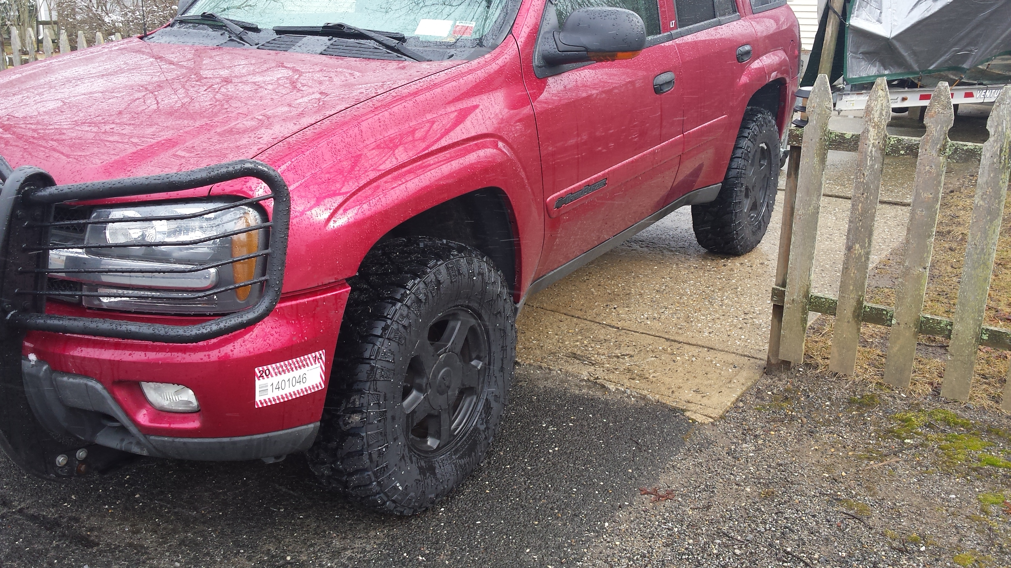

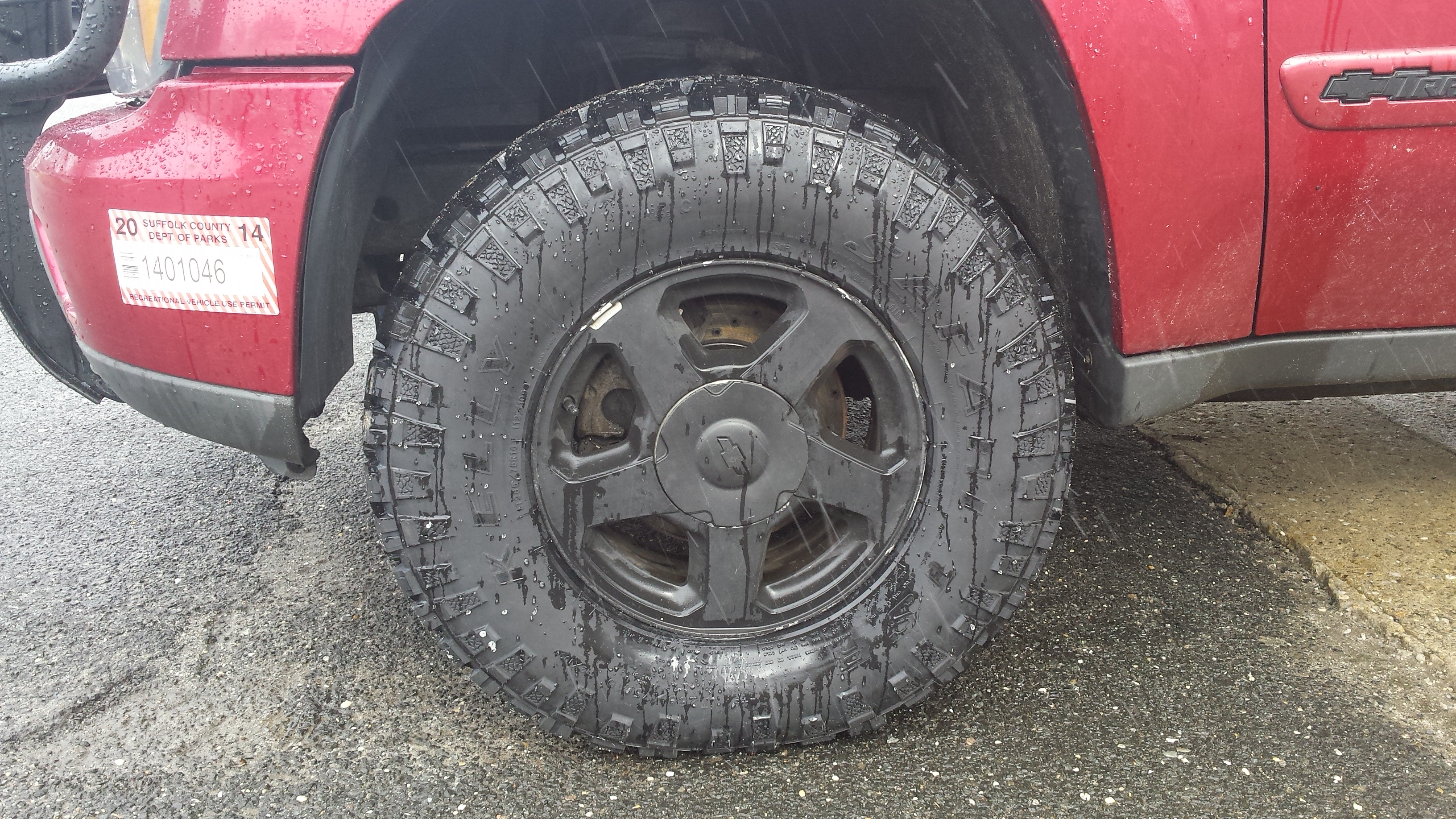

I bought myself a set of Kelly Safari TSR's. The size I got was LT265/75/16.
I looked and didn't really see anyone with these tires. They are basically Goodyear Duratrac's.
I have Marks 2.5 lift and spacers.
I have to do a little bit of trimming on the inner plastic fender because they rubbed on full lock.

Nice! You could always move the lower control arms forward some. If your in to some wrenching ;)
TB a lower control arms
the front bracket bolt is 195 ft lbs
the rear bracket bolt is 177 ft lbs
