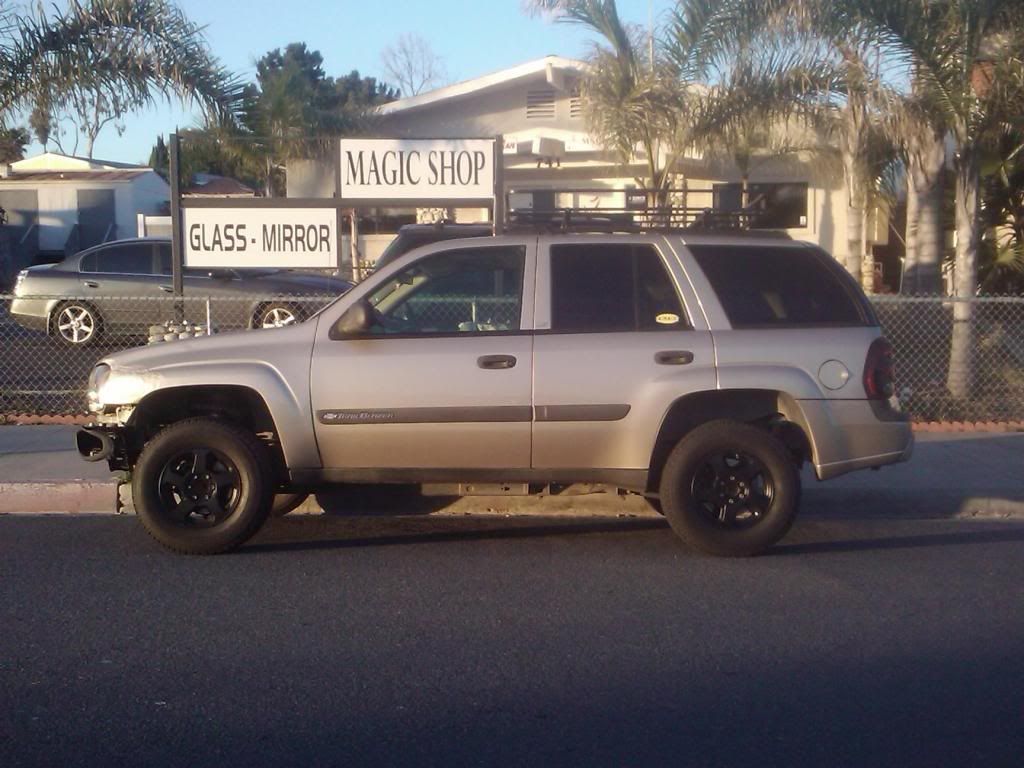

It depends on budget. I spray painted mine because I am a cheap ass and so far the only problem I have had is from rock rash. In California we have tons of bush where I wheel, and even with that, I dont have any scratches. I did 4 or 5 coats and a clear or 2 and threw them back on and wheeled the next weekend. Been almost 2 years and it hasnt faded. Hardest part is masking off each wheel, but other than that a fairly quick process and very easy to touch up if anything does happen to them.

Ya, I shoved tape under the lip around the rim, then stuck newspaper to it so essentially it covered the tire. Next time I paint a set of rims im gonna try a different method I have heard of, involves rubbing petroleum jelly around and covering the tire. I will try and get a pic later.
