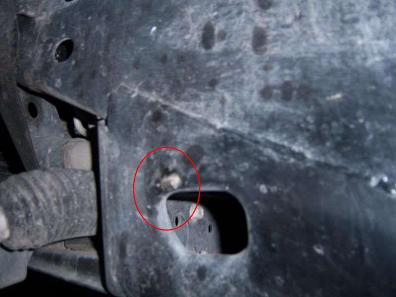

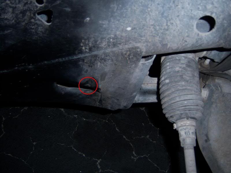

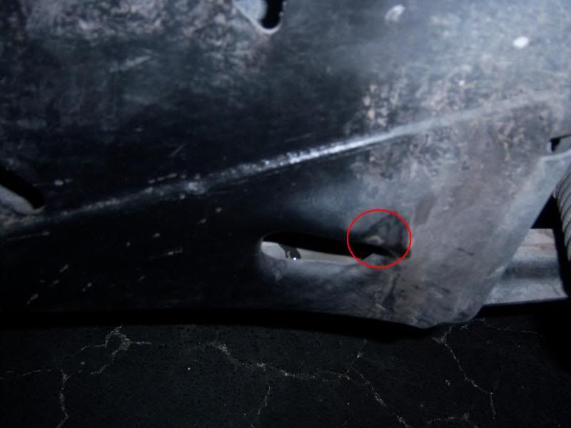

by Rob93 » Thu Nov 11, 2010 6:59 pm
1st pics is drivers side next two are passenger

by Zero » Fri Nov 12, 2010 12:08 am
Cut out a section larger that the area your rubbing, then cut some steel plate and box the frame back up. Maybe weld a flat piece to the bottom and back of the frame for added rigidity.
