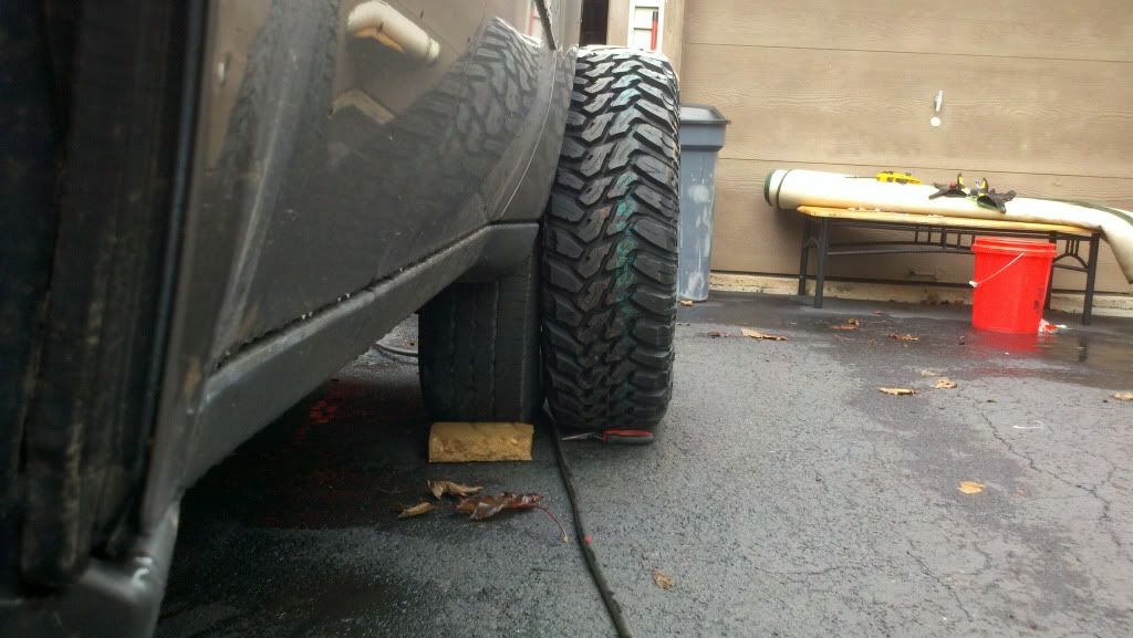

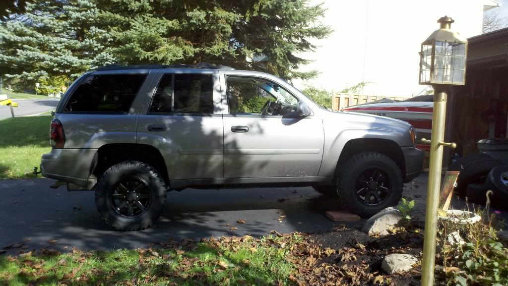

Cooper Discoverer STT TEK3, I have nothing but good things to say after 1,000 miles.
I got mine here, best price on the net.
http://www.treaddepot.com/tire/76109.html
Couple pics of how they look

Just looking at your pics and is your rear wheel not centered. Just asking because I thought I read that adjustable rear control arms can fix that. Is this true?

Yeah adjustable control arms are able to push the axle back.

Yes the control arms will fix that issue, these are only 32" tires and I don't rub at full flex with the sway bar connected. I haven't justified the cost of the control arms just yet, trail armor is on the list before anything cosmetic. If you run 35" tires then you'll need those control arms to center the wheels. I only have 3.42 gears, 32" is max for my comfort level since I also pull a 21' 3500lb ski boat. Gearing upgrades may be down the road when I buy a second vehicle, this is still my DD.

Did you have to run wheel spacers with your set up. If so what size?

by Opeth » Sun Nov 04, 2012 7:24 pm
Yes I had to run spacers. I bought marks 1.5" 6x5 -> 6x5.5
My rims are the full size Chevy truck lug pattern. My wheels stick out roughly 2"
