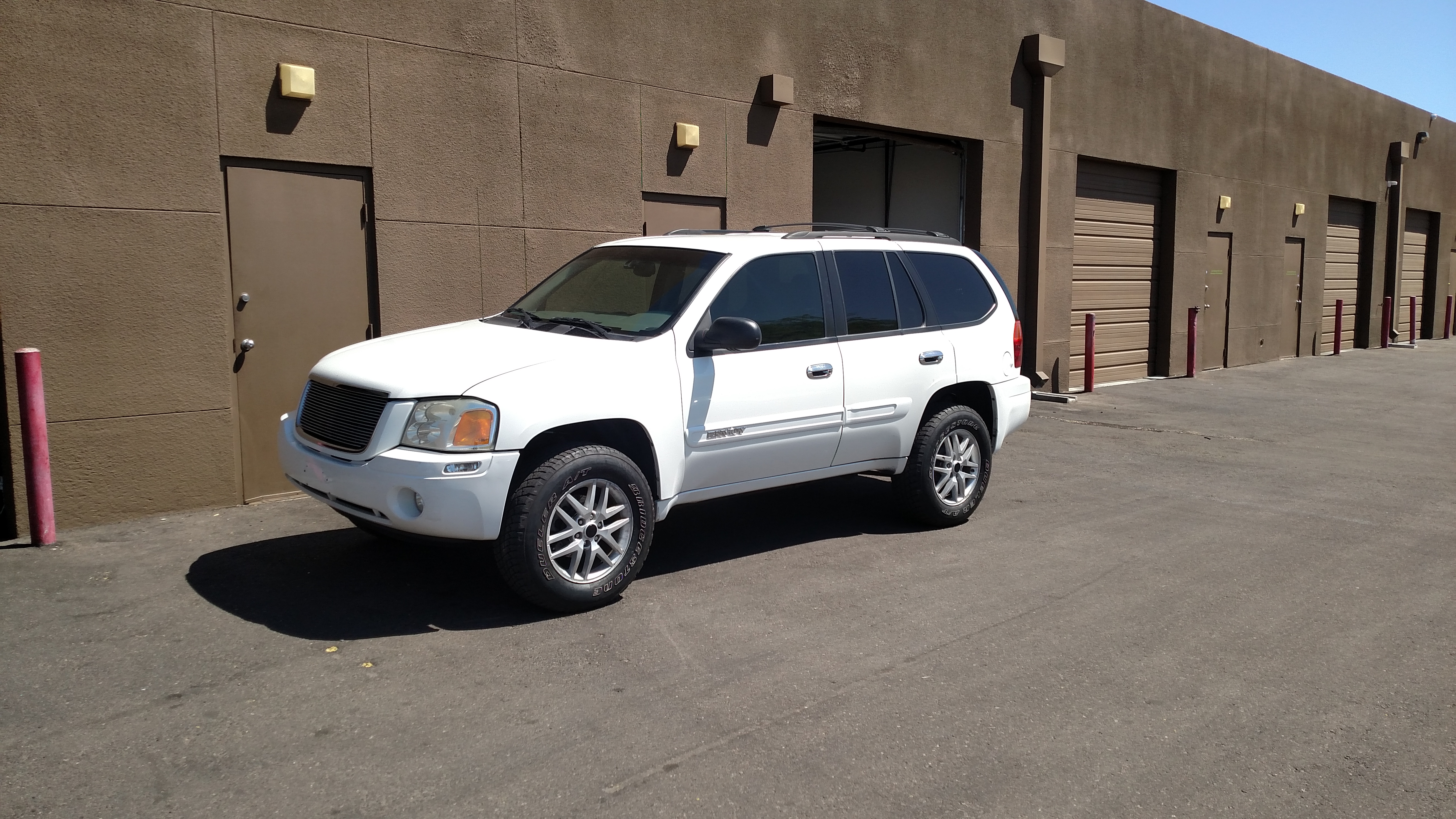

If you use Saab 97x wheels you don't need to cut the wheel studs, spacers I'm running 1.25" spacers, the wheels have a pocket between the stud holes so the .25" the studs stick out doesn't interfer with the wheel
