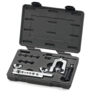

RimoniManu wrote:Ya you're right chevycrew, I wont recharge ac system with this setup and I'll go ahead and double up the clamps. Whenever I decide to finally get my ac recharged are there any clamps or something you guys know of that will hold up to the psi?
Yeah, the kind that get replaced by hard lines and double flares.
You'll need one of these:
As a matter of fact, on coolant, oil, and trans fluid lines, where I go from a hard line to a rubber line, I use the double flare kit to put a "bulb" on the end of the tube, to give the clamps something mechanical to hold onto. When doing what you did on fluid lines, I put a bulb on the end of the line, then use 2 clamps.
