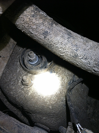

I suppose this should probably be replaced soon... :wallbash: :wallbash:

Is there a top washer?

by steveroche » Mon Jul 02, 2012 10:17 pm
that is the Markmc 3in kit, It has all the components that normally come with it.

Since Mark's 3" *and* the BDS upper bushings seem to be disintegrating at a regular rate, it seems to be time for washers that exceeds the size of the bushings, or limit straps to stop the shock on extension.

I think my top washer (from RC) looks a good bit larger than the one from the earlier pic.
I expect mine is ~1.5".

My driver side bushing is fine still, i'm actually rather surprised that the passenger side bushing deformed so much. I only upgraded to Mark's lift from the BDS lift less than 6 months ago. I do bash on my suspension because of the trails I encounter, but still a little surprised it happened so quickly.

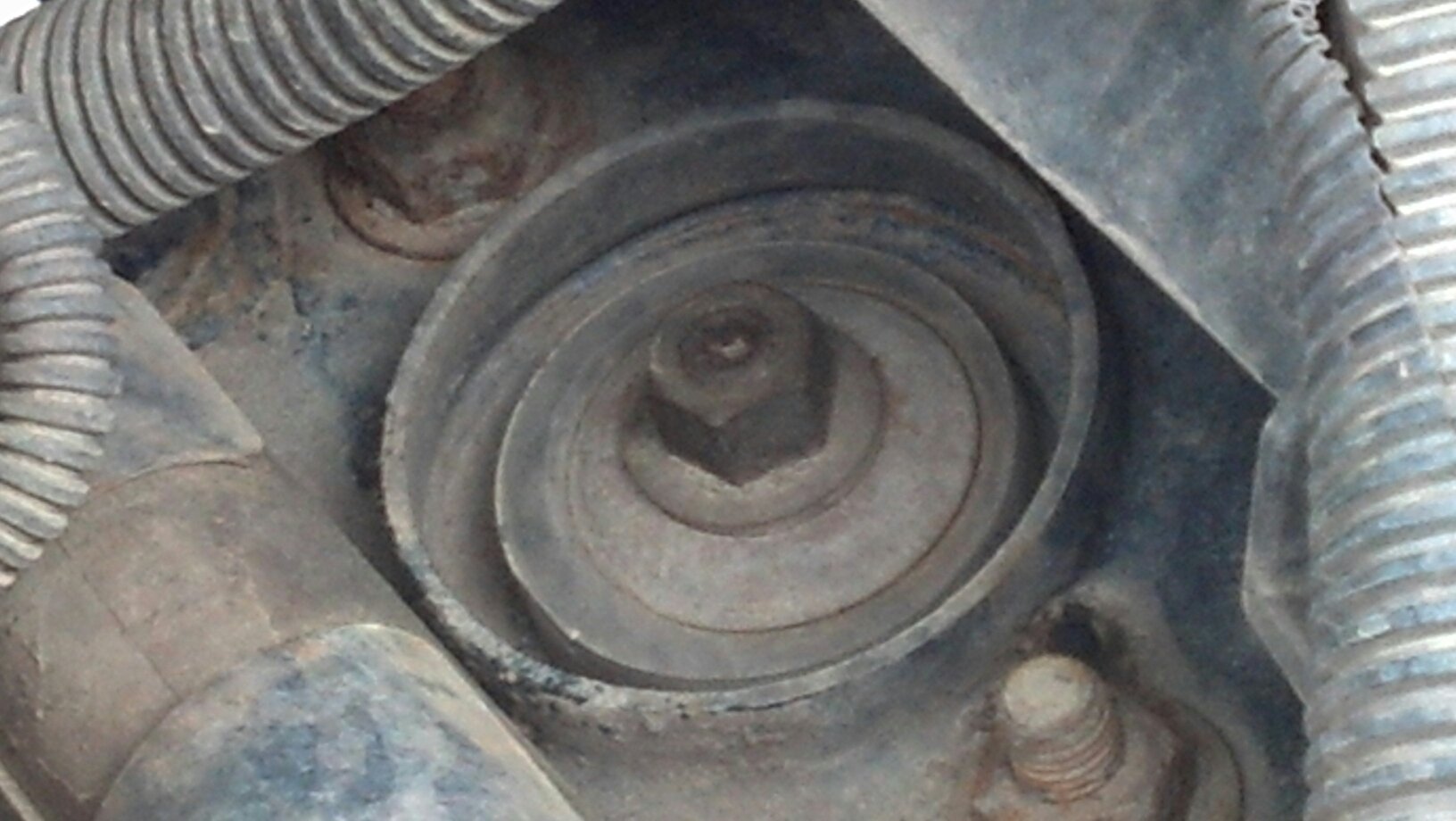

This is my 4-year old bushing (the worst looking of the two). Still looks great.
I'm wondering if the extension distance is a contributing factor in all of this, since the sleeve design prevents 'overtightening' of the bushings. We've already seen how much destruction an 89 spring can have on a shock internally. If not enough extension is built in, this could be a result. Anyone seen this issue and not have a higher-rate spring?

I also suspect it could have something to do with geometry, as you go more toward topped out. Not a lot of rotation as you're around stock height, but the farther the control arm rotates around its axis, the more rotation there is at the top of the strut. I suspect that the coupling of rotation and topping out hard can cause the washer to eat into the bushing pretty good.

I feel like mine top out fairly often when on the trails, but maybe you're right. I did put the washers under my mount, for an extra .7 or so of travel. I can't see it making that much difference.
Still, 6 months vs 4 years... you'd think mine would have caught up by now.

I do believe you guys are the only two that have used the washers. I had considered it, but I don't necessarily need the extra height, and I fear being close to the limits of the CV. My upper bushing is far more buldged than James when I first put it in.
It may be as simple as the heavier spring exerting more force. But i would also think all the armour a lot of guys are using would put more stress on the bushings as well.

I'm not sure the extra weight is entirely relevant. Other than the 1/4" of ride height it may consume - which may give the shock a LITTLE more room to absorb a few more bumps.
Bill, I see that you said Greg has a failure? I didn't recall that. He wasn't running any special springs was he? I don't remember his setup. Did Michael's failure come before or after heavy springs?
Are you all seeing ONLY failures of the top bushing? Or also failures of the lower? I would assume washboard roads would erode both.
What are the symptoms of the bushings failing? Is there excess movement of the arm? Or is it only evident by looking at the bushing itself?

I'd think that we'll only see top bushing issues. I suspect it's from topping out, where nearly all of the jolt force is dealt with by the upper bushing (and the one on the control arm, to some extent), but bottoming out would be on the big, soft rubber bump stop over the rod.

James - My lower bushing was pretty good looking with very little wear. The upper was destroyed though. At that time I had no armor and 89 springs so I was topping out regularly. I also do end up on some truly horrible roads. I don't think calling them semi-washboard would be a stretch.
My thought on the sleeve through the rubber bushing being longer purely came from my experience that tightening down the shock nut compresses the bushing significantly more than it is when I take the compressors off.

Could the bushing be getting cut because of the washer? If the washer was the other direction (bowl up) it might chaff on the bushing less....
