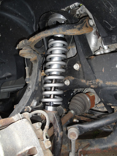

by OregTrailBlazin » Thu Mar 15, 2012 1:57 pm
They are ready to build them. About a week lead time, and will run $1069 shipped.
bartonmd wrote:Just an update on these. As per SOP, there was some stiction on the valves/shafts/seals when new, but now that they've got ~1k miles on them, they really ride a lot nicer, and hold the road a lot better over mid-corner bumps (they were already better than the Bilsteins + 87's from day 1). I'd say that at this point, even though the spring rate is much higher than the 87's, the ride quality is actually better than the Bilsteins + 87's, even without the winch on the front.
Overall, I really, really like them!

by Trail X » Thu Mar 15, 2012 2:16 pm
I think you can safely extend about an inch longer than the bilstein HDs allow (I assume same as stock?). Much more than that needs to be fine tuned very carefully.
~75 N/mm rate should work well.
If the coilovers are adjustable, can they just give us adjustment between 2" and 3" of lift? Between my springs and the BDS lift, I think mine have about 3" of suspension lift total, and they ride well at that height.

by navigator » Thu Mar 15, 2012 3:21 pm
Help me understand how a new coilover give us anything more than a stiffer spring with a spacer?
I'm guessing that since the spacer limits articulation (you are riding around basically flexed 3 inches) the idea of a coilover is to give lift but allow more articulation. Am I on the right track?
by Trail X » Thu Mar 15, 2012 3:36 pm
You can't allow too much articulation, because the CV's tripod housing is the mechanical limit (given flipped UCAs).
Coilovers offer an "engineered package". Tuned damping, adjustible height (generally by a threaded collar), and rebuildable internals.
Posts: 9928
by navigator » Thu Mar 15, 2012 3:52 pm
thanks James, that is what I was thinking as far as the articulation.
So it won't really provide any more lift or articulation it will just do it in a better way.

by OregTrailBlazin » Mon Mar 19, 2012 6:27 pm
OK, so looks like a 74n/mm is roughly around 425lbf/in. So a 450lb coil should be about right. Seems a little soft, I'm running 650lbs on the coilovers in my TB, but they are a little too firm, and I have a bumper to counter some of it.
If anyone happens to have the Ext/Col length of the HD's available I would really appreciate it..
