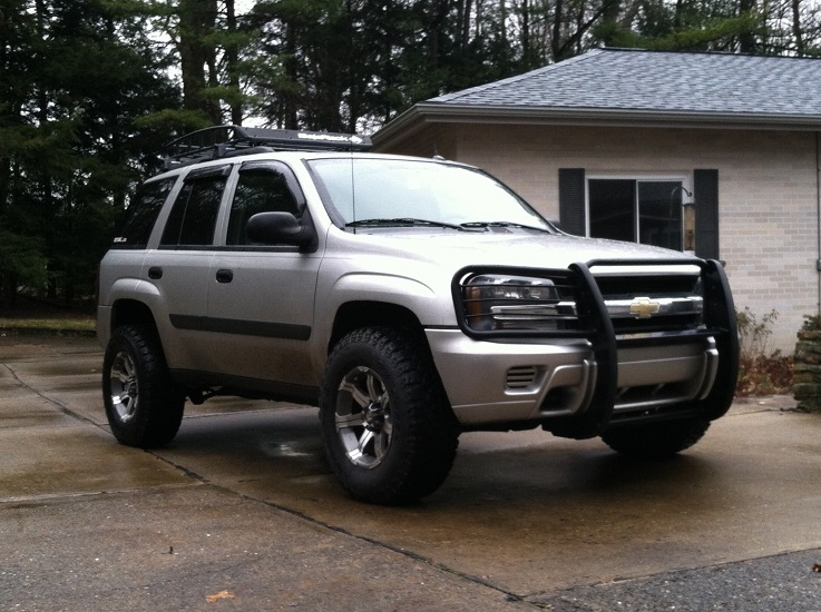

2005 Chevy Trailblazer LS
Drivetrain Specs:
Stock 4WD, 3.42 rear axle ratio
Suspension Modification:
(Front)
--Bilstein HD struts with Moog (never again, Moog) coil springs
--SMAXX 2.5" leveling kit + extra .5" spacer
--SMAXX sway bar endlinks
(Rear)
--Z71 Springs and Shocks
--2" coil spring spacers
Exterior Modifications:
(Wheels & Tires)
--1.5" wheel adapter (increase bolt circle to 6x5.5")
--Dick Cepek Gun Metal 7 (17X9)
--Dick Cepek Radial F-C II (LT285/70R17)
Note: cutting required
(Body, etc.)
--Westin grille guard
--Baja Rack roofrack on Yakima round bars (cutting required)
--Purple Cranium rear dif. rock guard (half spider)
--$15 WalMart variety backup lights
--Flexible fender flares (not pictured)
--Thule square bar customized to hold Hella Fog and Driving lamps (Not Currently Mounted)
(On Order)
--Custom rear bumper with spare tire carrier, hi-lift mount, Jerry can mount (MDB Fabrication)
Engine Modifications:
--AIRAID cold air intake
--20" Flowmaster exhaust tip (welded)
Interior Modifications:
--N/A
Recovery Equipment:
--4 Ton Jack
--2" Tow Strap (loop ends) + Cinch Bone
--Tire Chains (Front and Rear)
Electrical Modifications:
--N/A
