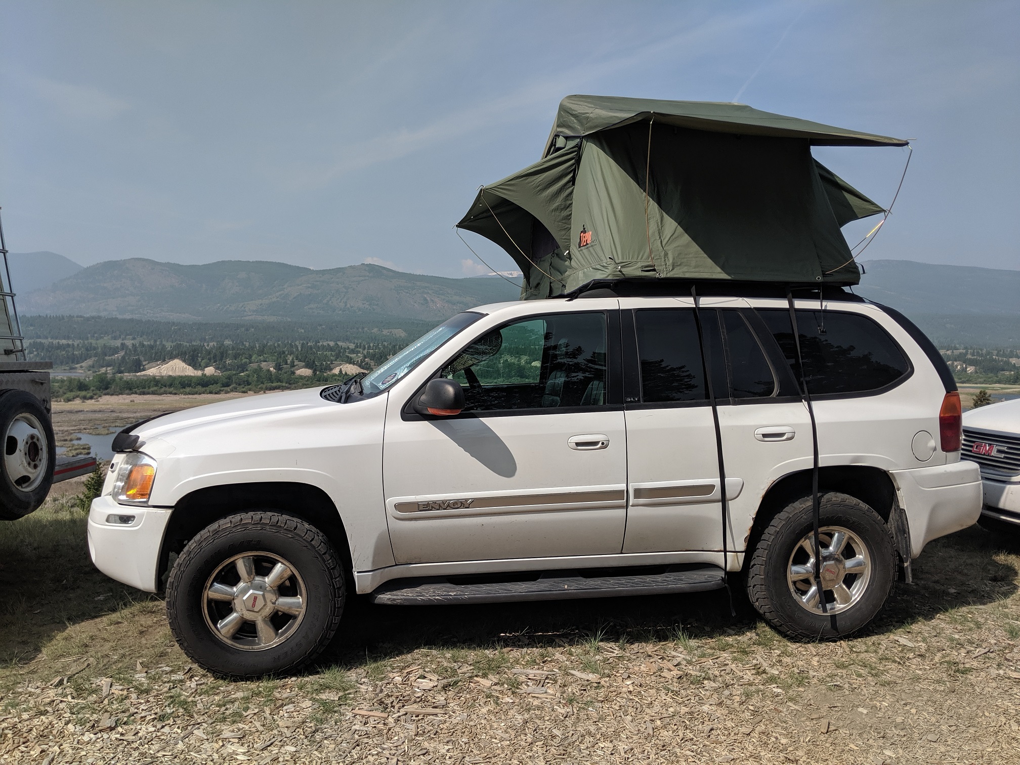

by somedude » Tue Jun 04, 2019 12:24 am
I decided to try out the 4 factory cross bars. Used it once so far, so far so good.
4 cross bars
Roof top tent

by Diacom » Tue Jun 04, 2019 10:33 am
Looks good.
Let us know if you find any issues such as it working loose or excessive crossbar deflection.
