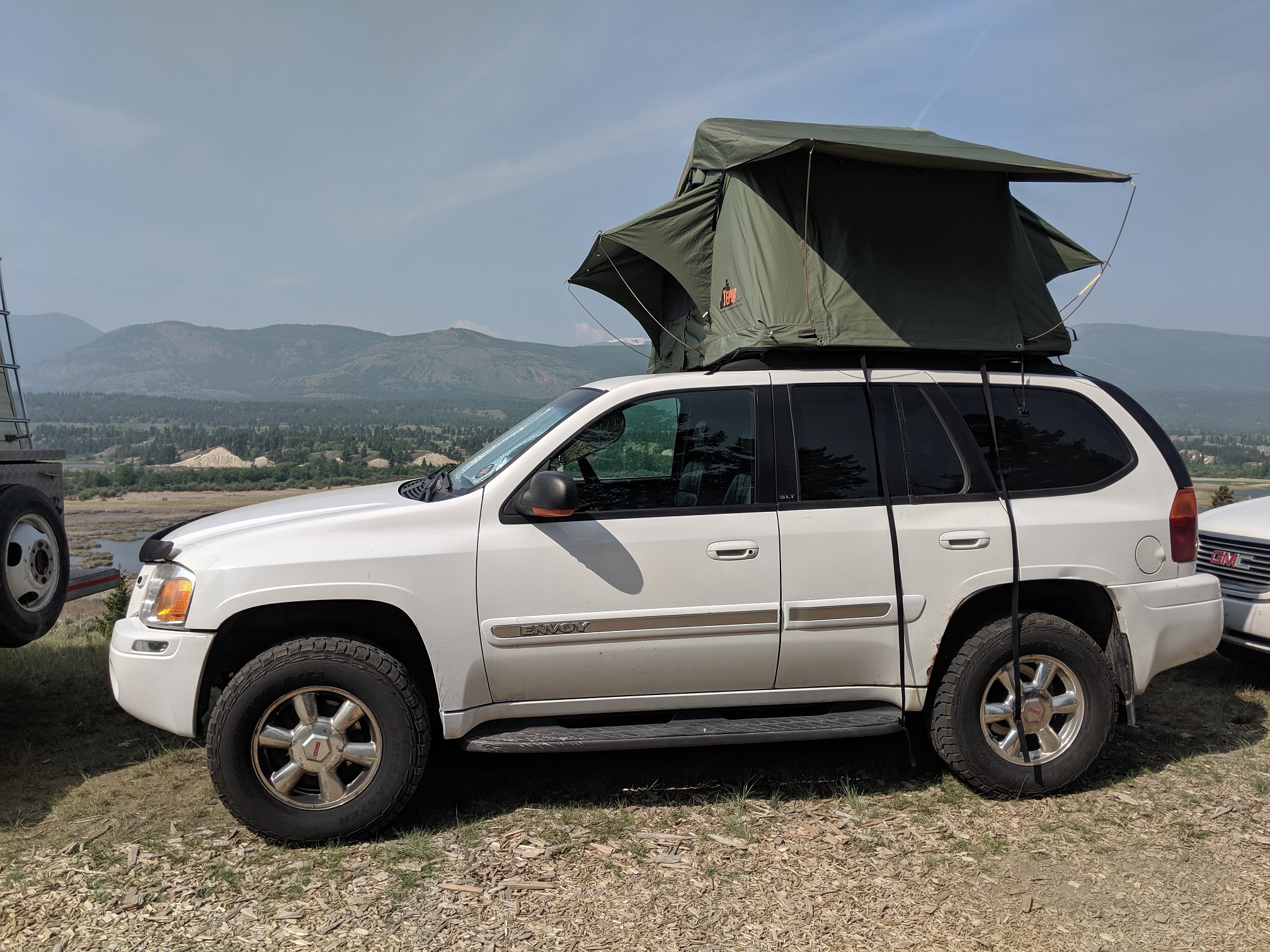

Has anyone tried putting a roof top tent on the factory rails and cross bars?
From what I gather the dynamic weight rating is 220lbs based on the 2002 gmc envoys owners manual. https://my.gmc.com/content/dam/gmownerc ... owners.pdf
Excerpt from section (2-62):
Loading cargo that weighs more than 220 lbs.
(100 kg) on the luggage carrier may damage
your vehicle.
When you carry cargo on the luggage carrier of a
proper size and weight, put it on the slats, and
distribute the weight evenly. Then slide the
crossrail up against the rear of the load, to help
keep it from moving. You can then tie it down.
Cargo containers must be loaded on the
crossrails only.
