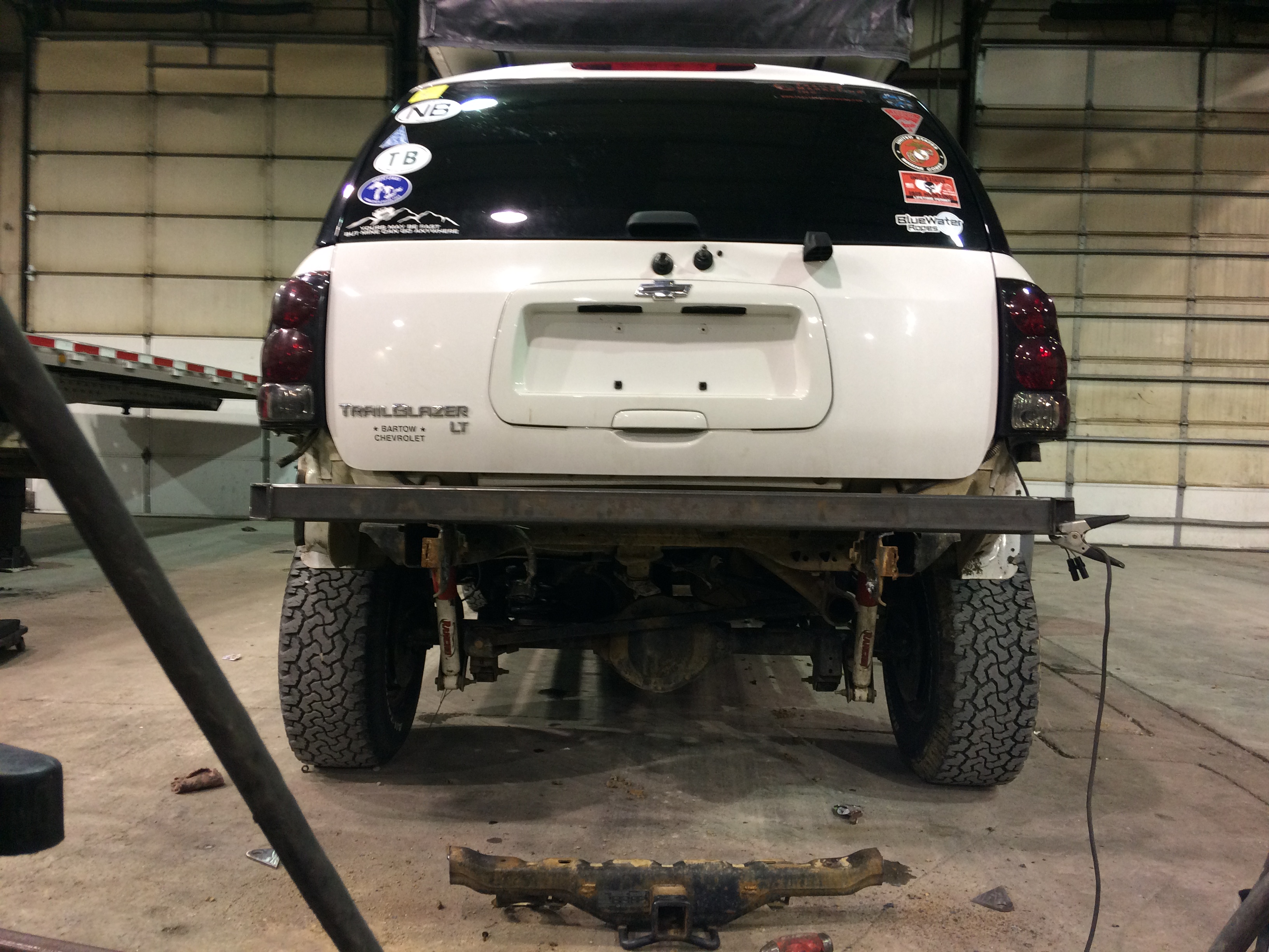

I searched around and got a rear swing for free. I built a substructure under the bumper cover and the swing went through a couple transformations before I settled.

Finally decided to do a rear bumper, dual swing arms.

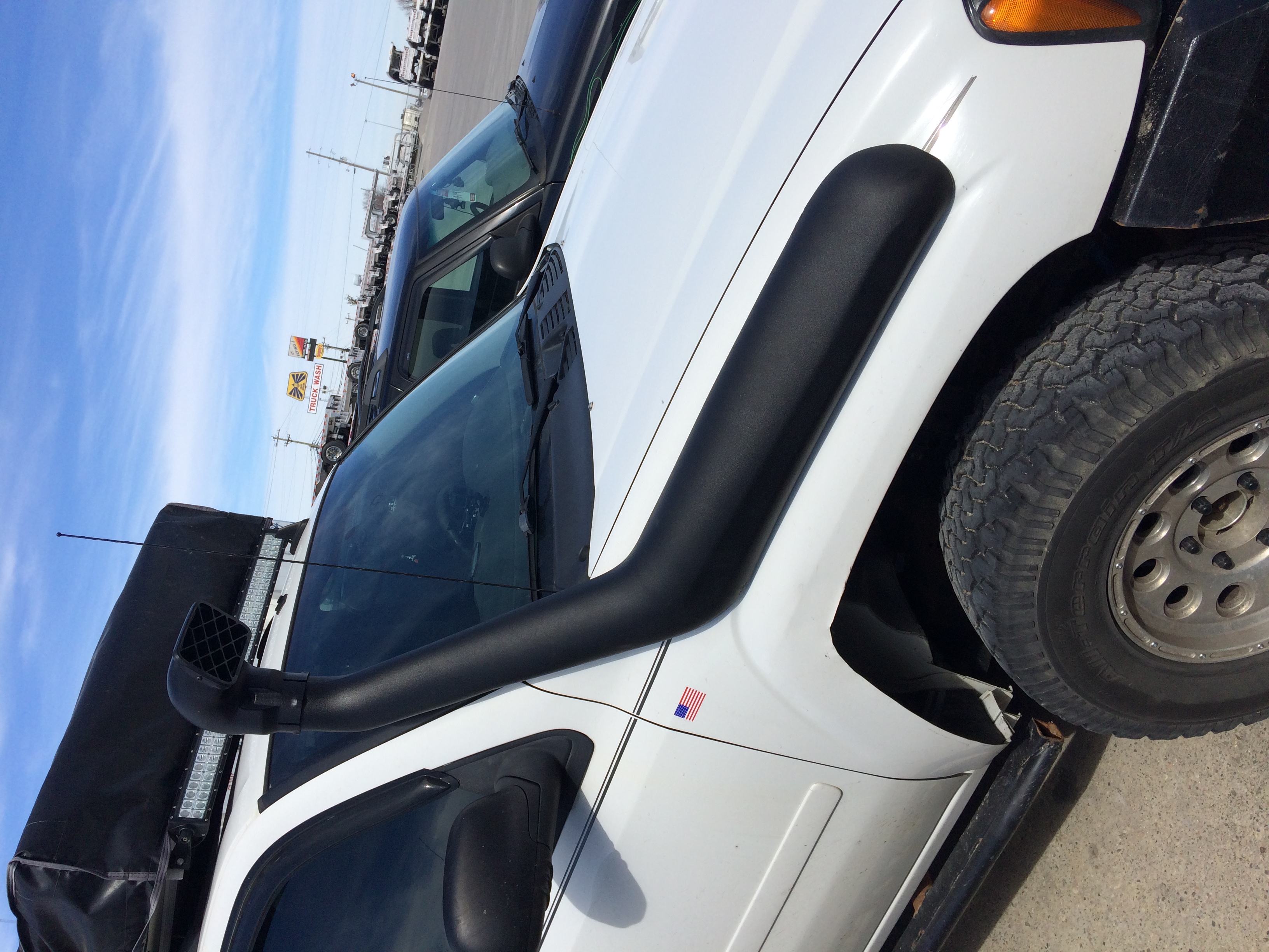

Next up is the snorkel build. I got a cheap snorkel kit for a Landcruiser 80 series. https://www.amazon.com/gp/aw/d/B00B90PP ... ref=plSrch For the intake I chose a f150 filter housing. I lined up the template to the snorkel, it is wrong so i modified the template and then marked and drilled my holes. I went larger then the specific hole for the intake. After mounting the snorkel I realized that I could tweak it to fit the body better. I marked and redrilled the holes and finished the install.
The air ram has slits in which the water is supposed to seap out of when raining and what not, they were not rat enough up the snorkel so I had to cut them a little further up. The metal mount by the windshield had to be extended since this is not a perfect fit, by an inch. I modified the filter housing,
by cutting it 3 inches shorter.
I also cut the plastic piece near the maf to mate the filter housing
. I eliminated the vortec box(not sure of tech term) on top of the engine. I rerouted the crank case vent as well
, also I still have functional ac and room for my second battery. I also installed a winch.
