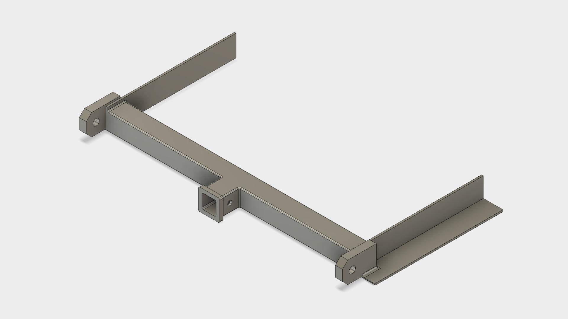

I've made it as far as modeling the frame of the bumper, where it will mount to the frame of the truck and then be built out from there. Stay tuned....

Looks like fun. I design in 3D just about every day here at work. Looks like you're making good progress.
The way you have your hitch tube doesn't look like it will be able to accept a normal hitch, looks too shallow. Might want to consider just welding your hitch receiver above or below the cross tube. It'd certainly be easier. Also, I'd recommend buying a receiver tube instead of making your own. Receiver tube doesn't have the weld seam inside... and believe me, that stupid weld seam will get in the way and you can never really grind it down.

Trail X wrote:The way you have your hitch tube doesn't look like it will be able to accept a normal hitch, looks too shallow. Might want to consider just welding your hitch receiver above or below the cross tube. It'd certainly be easier. Also, I'd recommend buying a receiver tube instead of making your own. Receiver tube doesn't have the weld seam inside... and believe me, that stupid weld seam will get in the way and you can never really grind it down.
Yeah, I would buy one and not try making my own. I was trying to model Mike's design in the 2nd pic.

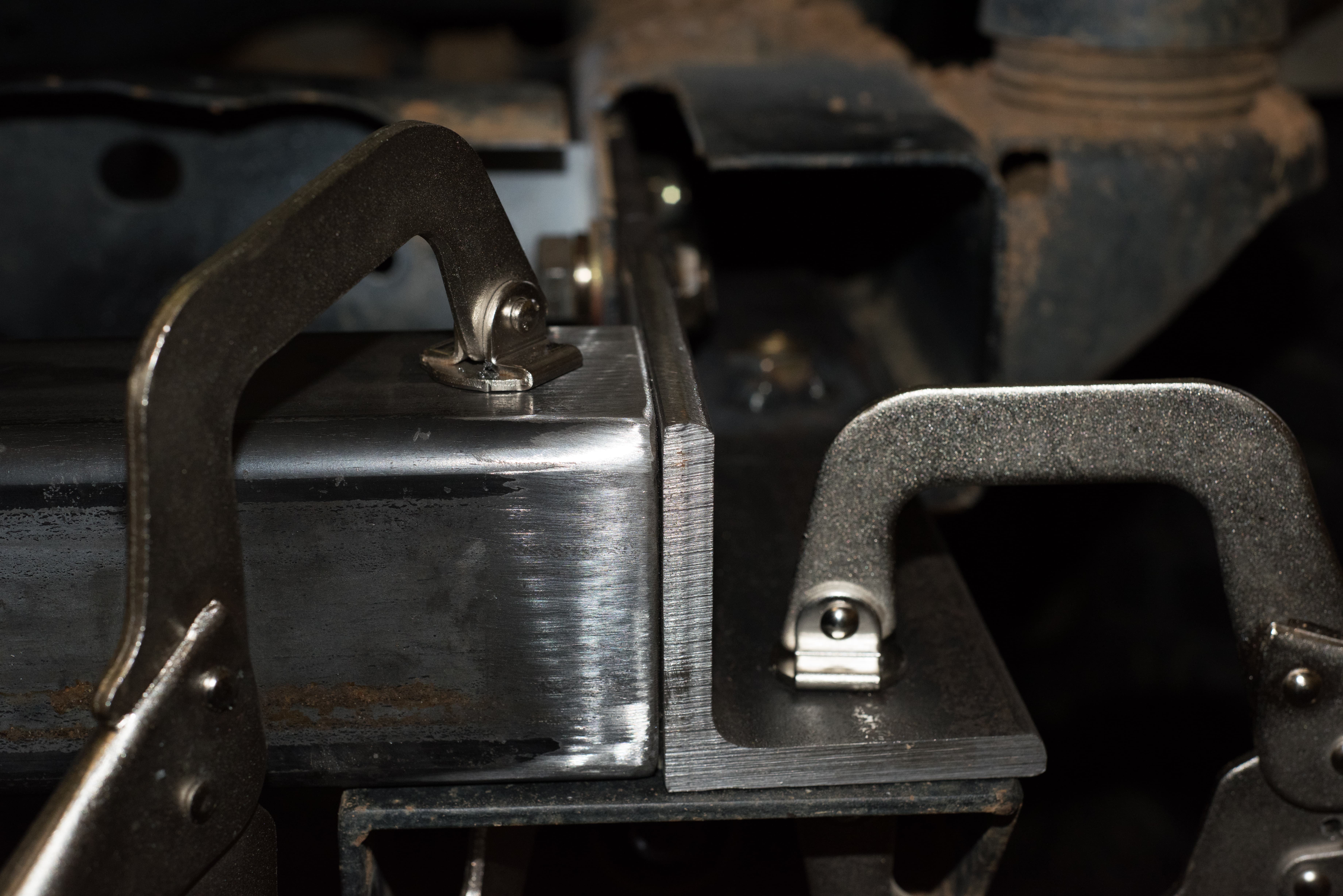

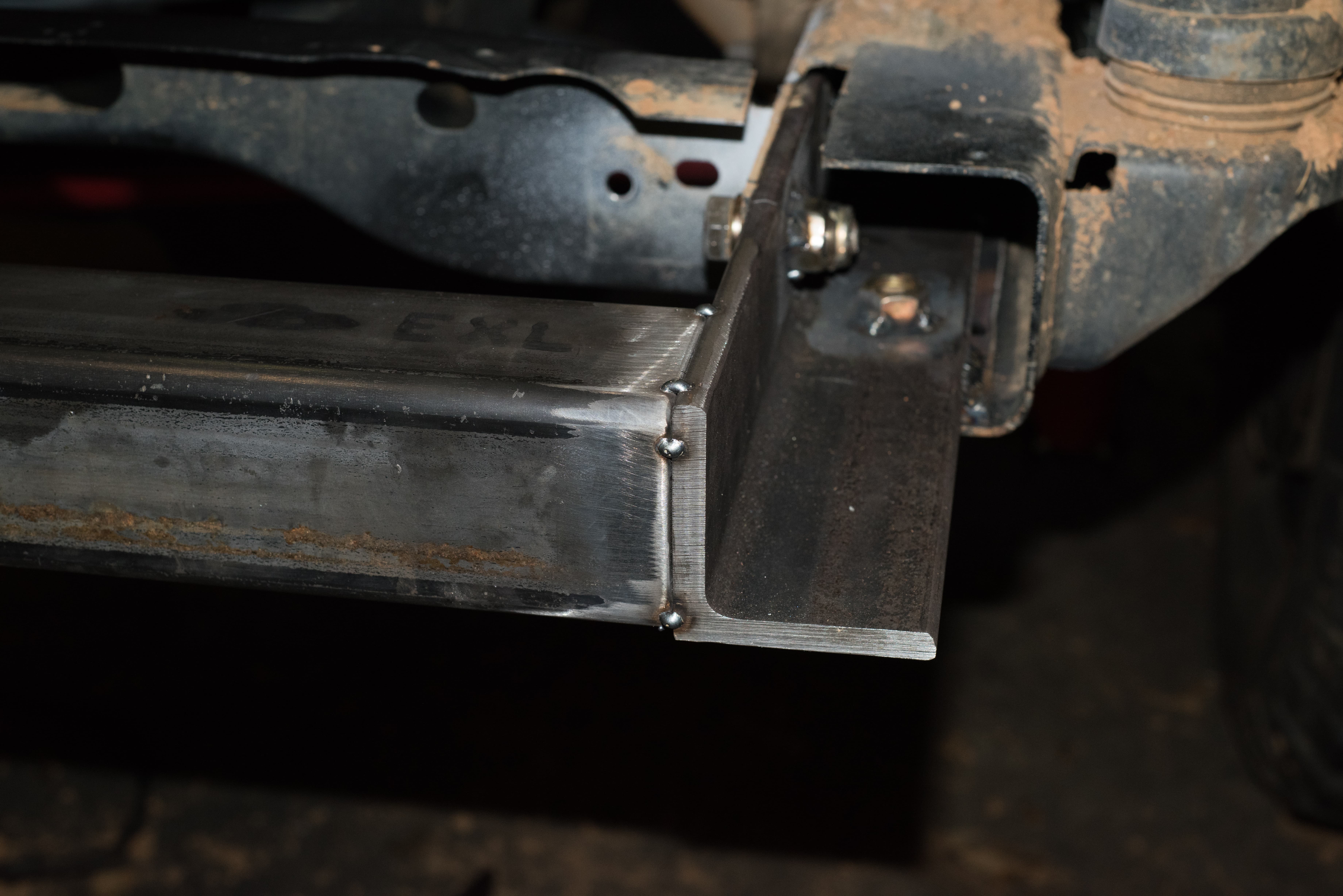

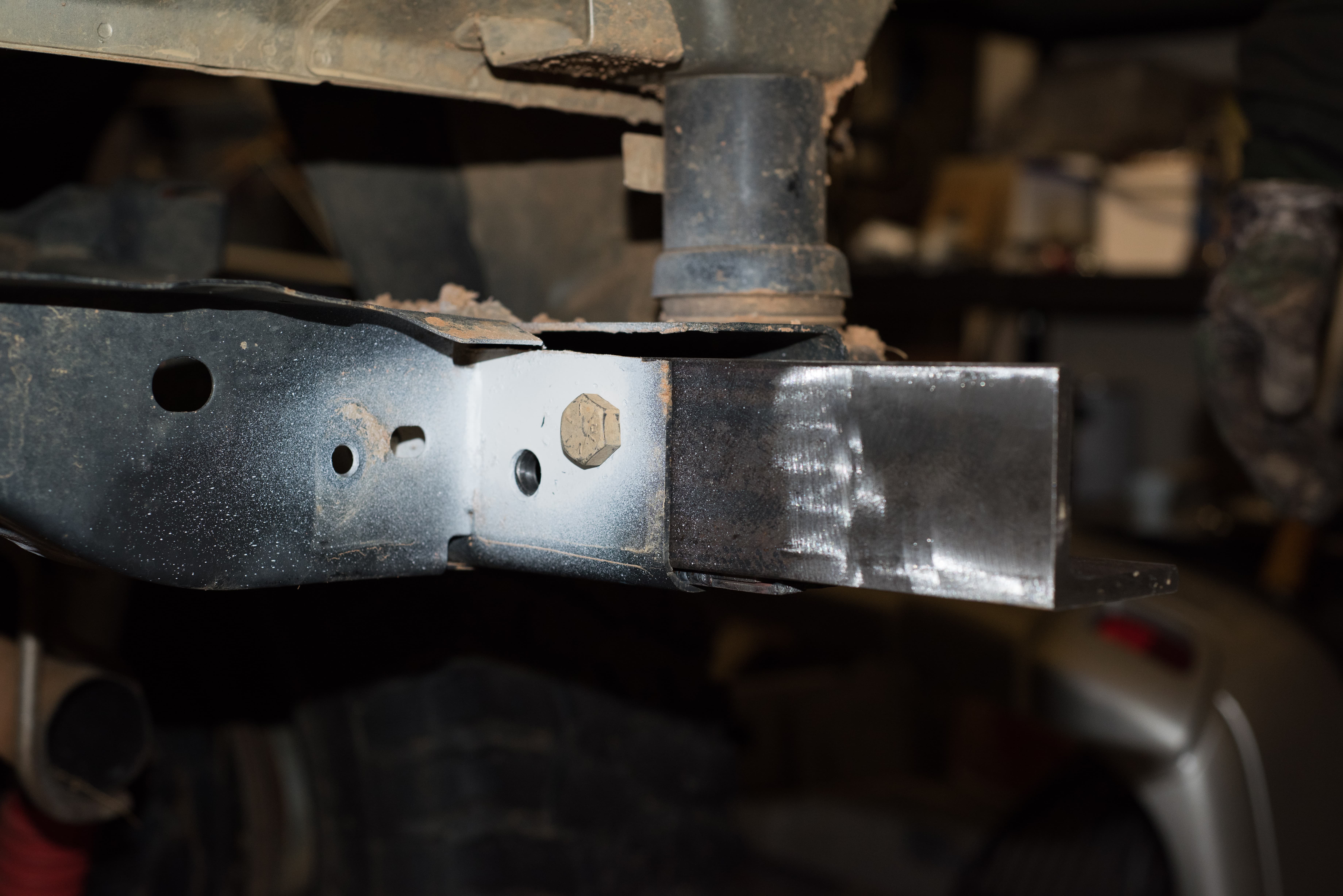

I will be basing most of this from Barton's build of the 3" BL rear, which CAN BE FOUND HERE. Of course, it wont be exactly the same, mostly because my fabrication skill level is about 0.07% of sir Bartons. I'm going to be building a single swing type as opposed to the dual swing design since it will be easier to build. So far I've got the bumper's frame welded up, and that includes mounting rails (3x3x3/8" angle), mounting nuts tacked on, main cross-tube (3x3x1/4" square tube), and the receiver tube. I added a fourth mounting bolt on the bottom of each frame rail for piece of mind. So, with (2x) 3/8" brackets each mounted with (4x) grade8 5/8" hardware, I don't think its going anywhere. Oh, don't forget the loctite! Also, I followed Mikes shackle mount process detailed HERE for welding these main structural assets of the bumper. As it stands, this should be a class IV receiver.
