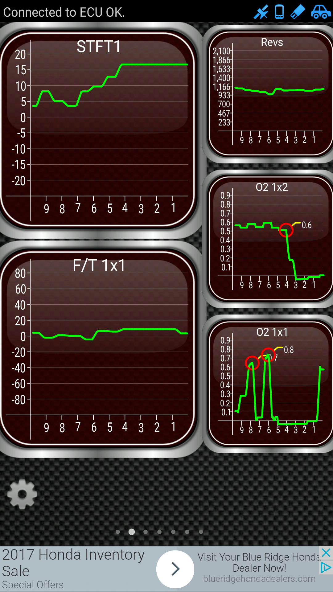

I finally got one of those bluetooth obd tools and the torque app, and decided to drive it around while watching the O2 sensor and the short term fuel trim.
Drove around the block a few times and all was well. No issues. No stumbling, nothing apparent. Decided to bring it out on a bigger road with a little higher speeds. As I was going up the first hill, the O2 readings flatlined. It hesitated for a minute, then the PCM switched into open loop mode.
So in my mind, I started thinking the O2 sensor could have a temperature dependant open or short circuit. Sure enough, a few minutes later, P0130.

Trail X wrote:I finally got one of those bluetooth obd tools and the torque app, and decided to drive it around while watching the O2 sensor and the short term fuel trim.
I'll swap the O2 asap. I was also trying to listen for the squeaking noise that I heard the last time it stalled. I realized that as it was stalling I decided to roll down the window. I noticed today that the brakes have a slight squeak to them, which I probably heard only when I rolled down the window, and thought may have been associated with the stalling.
Anyways, well see what a new O2 does.
At what voltage did the o2 sensor flatline at? Do you have access to the fuel trims short term being the more important one. What does the coolant temp read (the pid not the gauge), what reading is the maf when it is running bad and what is the map. Live data will be the only way to start solving this problem. A p0130 throws after it's running bad. The o2 could cause the p0130 but since it's intermittent I wouldn't swap it just yet. It sounds like the p0130 is being set by the condition the engine is running in ie overly rich or lean.

Hey Jay. I can run it again later today to get some better data. I do have access to short term fuel trims, but not long term - at least not that I've found yet. Its a bit hard to keep an eye on the gauges 100% of the time and drive. I wonder if Torque can record data into a dump file. When driving lightly around the neighborhood, it was driving fine. O2 readings bounced around like I'd expect it to, a constant saw tooth up and down - small teeth when idling, larger when driving, reacting to the sawtooth STFT inputs (which may have been more agressive since I just cleaned the TB and reset the fuel trims via unplugging the battery). As I crested a hill on the secondary road, I felt it hesitate for a second. I looked down at the O2 gauge, and it had a sharp dropoff. At that point, both gauges flatlined further. I couldn't figure that out at first, and later realized that is how the PCM outputs those values when it goes into open loop mode. I may go drive it and try to recreate the problem and see if I can screengrab it for posterity.

Here's a quick screen shot of what would happen with the O2 feedback and STFT graphs in Torque when it would go flakey. When it did this, it would go into open loop. Unfortunately it doesn't display voltage, I didn't realize that was a separate display till just now. I drove it a bit more today and it acted fine other than popping between open and closed loop. Although, there was a tiny squeak once in 5 times I shut it off. But it may have been doing that for a while, I'm not entirely sure.
I'll try to drive it again in the morning to get some raw O2 voltage data, then swap the O2 tomorrow evening if I have time.

Here's a comparison between how it was acting with the bad O2, and how it acts with the good O2, including voltage displays. These screen shots aren't taken at the same point on the road, but it may give others an idea of what to look for in the future. It's a bit subjective.
I'm going to update the thread title with something a little more descriptive, and a little less dramatic.
O2 sensor incorrectly reporting combustion and causing ECU to incorrectly rich the mixture. CAT had not completely warmed up, as this was a short drive, which I believe is why the O2 1x2 (post cat) sensor went low. It does that a bit before the cat warms up completely.
Properly performing O2 sensors and fuel trims.

Looks like the scan with the new o2 sensor is still running rich. What was the engine temp when you did the scan?
At full temp the stft should be hovering around -5 to +5 in closed loop.
The new o2 is definelty working better.

Water temp was probably up to temperature, but I don't recall exactly. I had previously reset the fuel trims by unplugging the battery, then it had gotten used to a bad O2, and this was the first time it was ran with the new O2, so it may have learned some bad habits that it will need to average out. I'll keep an eye on it.
