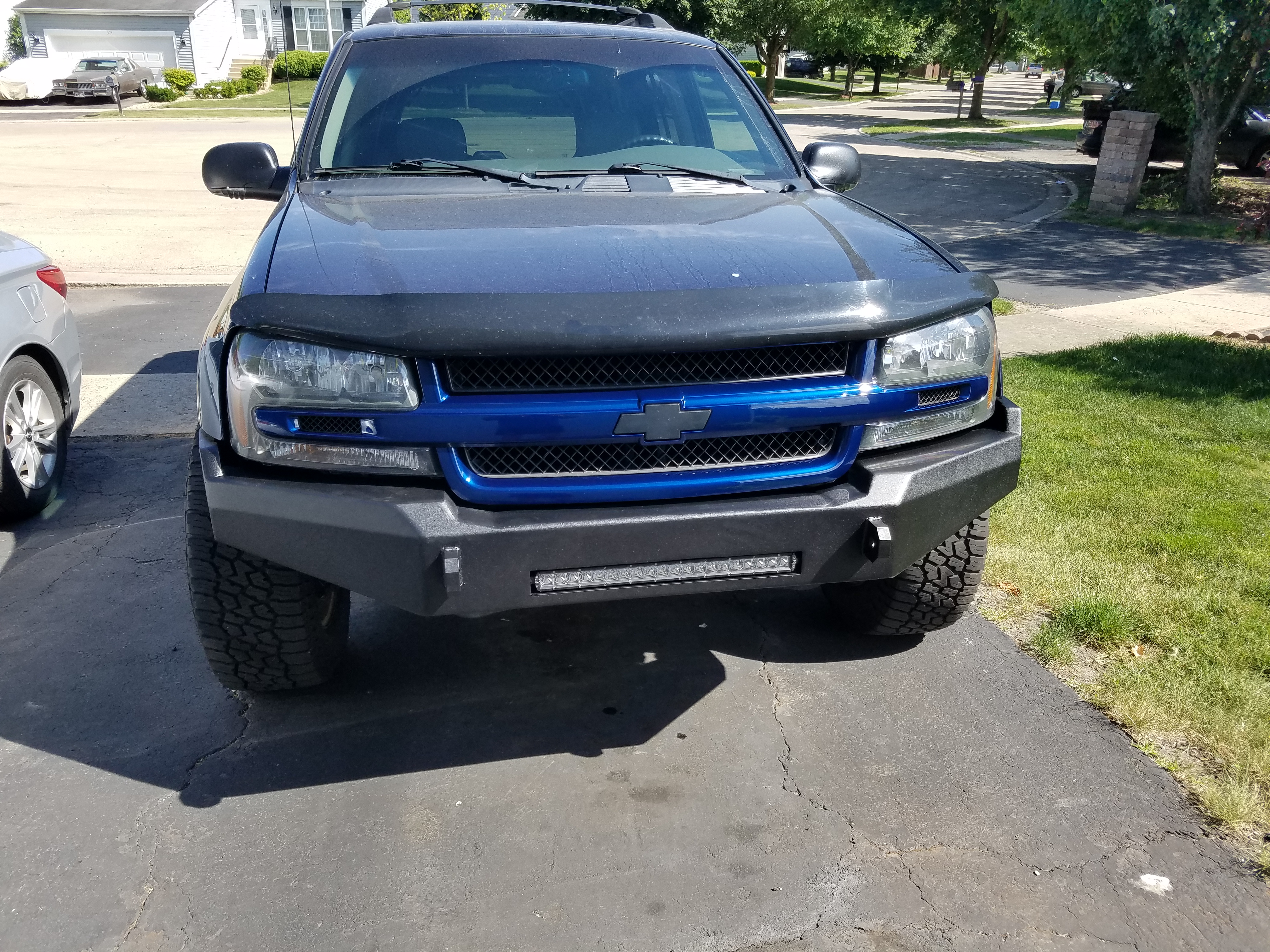

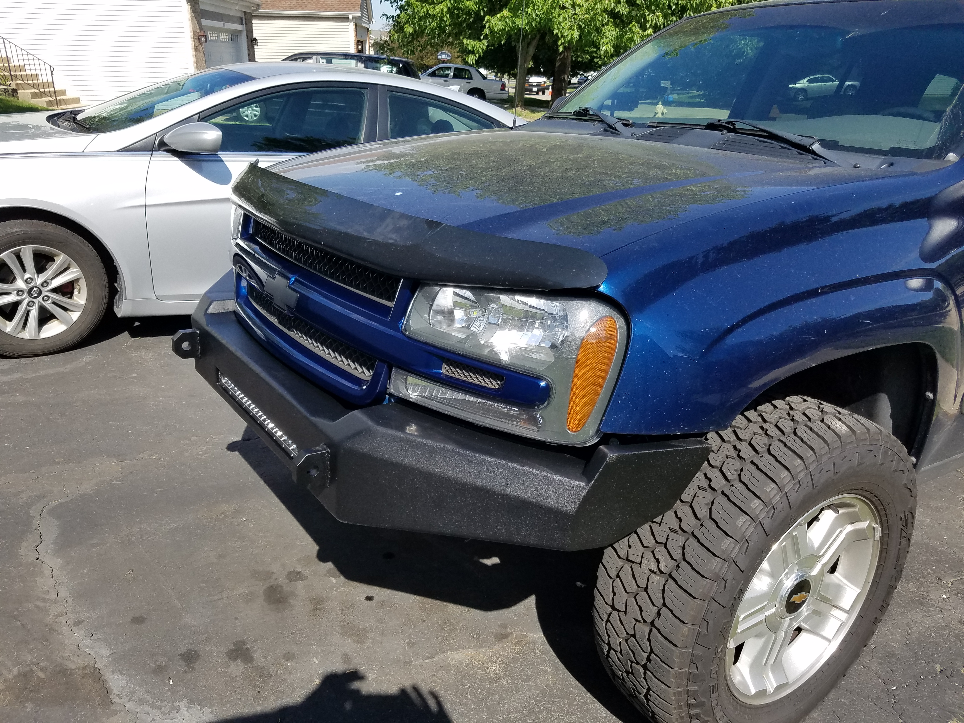

FINISHED MDB FAB BUMPER
by larryk » Thu Jun 08, 2017 5:34 pm
First, MAJOR props to Mike for doing all the design and bending work. His kits are top notch, and if you are having any hesitation on getting one.... don't. They fit well, good steel, proper gauge for the job, and proven off road. If you get the idea I'm happy.....good call :)
Anyhow, here are pics with my recently painted to match SS grille....
Oh, I added the frenched in Rigid lightbar..... the rest is completely Mike's design.

Gotta give credit where due.....Mike had a small Light bar in a similar setup in his personal bumper..... along with the round ones on the wings. Gave me inspiration :)
It's a super tight fit where it's mounted.... there is only about 3 1/2" between the bumper face and the ABS crossmember. To actually French it in a 1/4, I used a Rigid bar (best quality and most shallow I could find) that's 3" deep... leaves a 1/4" clearance. Tight

Well, I looked at those Amazon bars, and the long term quality seemed suspect to me. I wanted a bar that wouldn't fog up, yellow, etc. Too many reviews with poor long term life. I went with the Rigid, and while expensive, I believe worth it. While I haven't off roaded with it yet, drove it around last night and beam pattern was very good. I have the combo bar, so outside four on each side are flood, and the middle 14 are spot. The optics are actually engineered and not just led in a reflector. Also, many bar's are single row, and 3.25"deep. This bar is 3", which allowed me to recess it the 1/4" I wanted to. Better protection :)
