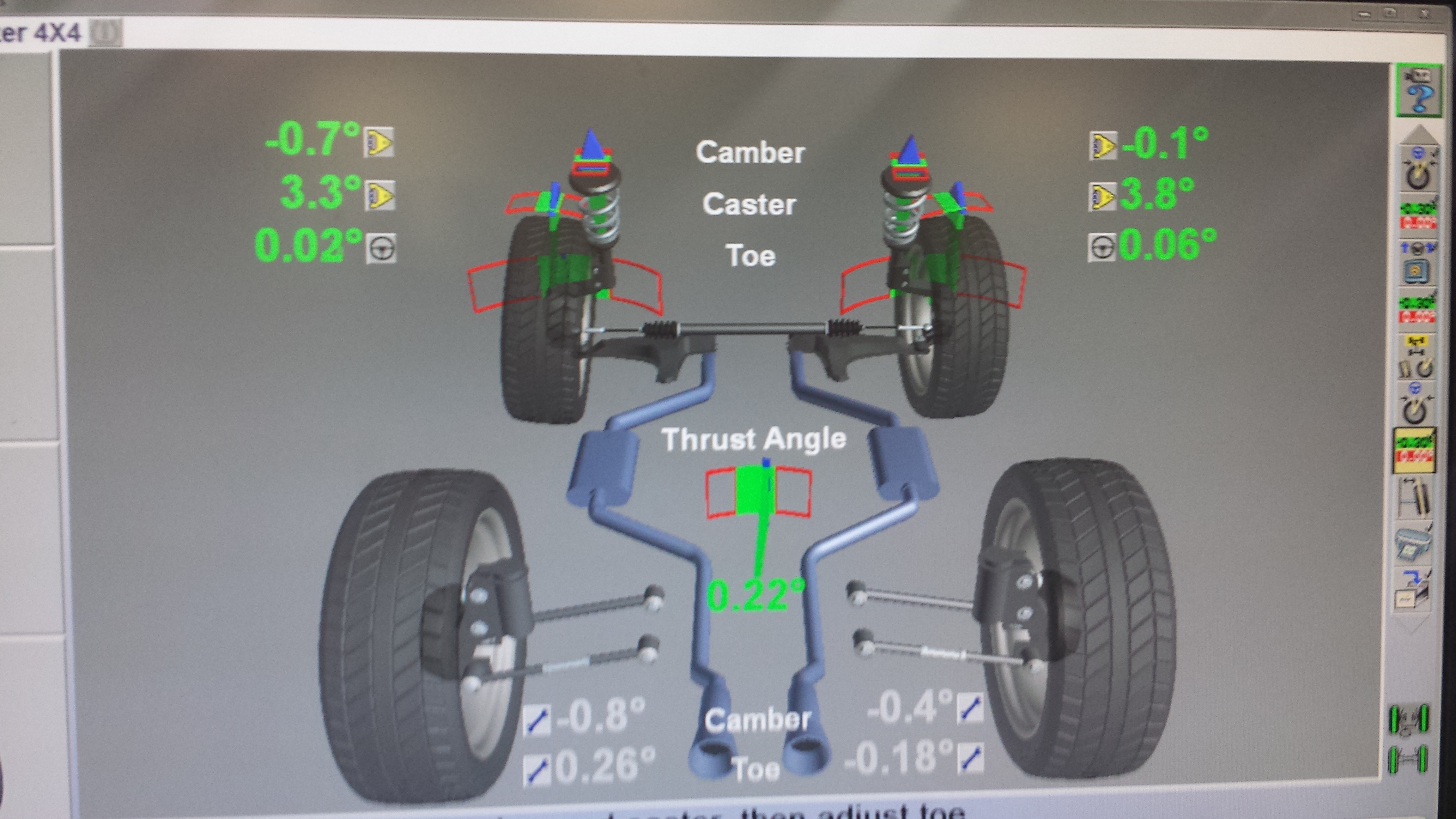

So here is a update. I figured I would take this vibration one step further and use a tool that is designed specifically for vibration. They call is the Pico scope. It has a three axis sensor and a interface that plugs into my laptop, along with some software. It also tags into the DLC port and monitors data from the ECM as well. I took a few pictures. I beleive what I am felling is the CV joints. They don'f feel worn out (not a lot of play). I checked the alignment also with the time I had. I did notice my toe was off a tiny bit but all others looked good. Also I seen that the thrust angle is a bit off. (That might be from not having the track bar drop bracket installed. :scratch: So it looks like I need a set of cv axles. I had seen a few of you had mentioned a cretin one was the better ones. I cant remember then name or brand. Here are the pictures I took today.
I would also like to note that the vibration comes in at a moderate to full throttle pull from a stop.
Toe is adjusted.
first look at the alignment with the wheel spacers and different tire and rims. Toe was off a tiny bit
The bar graph to the left labeled P1 is the worst. The green is color indicator of the direction of movement. (Lateral) The intensity is how tall it is. 25.9mg. P is for prop-shaft 1 is first order vibration.

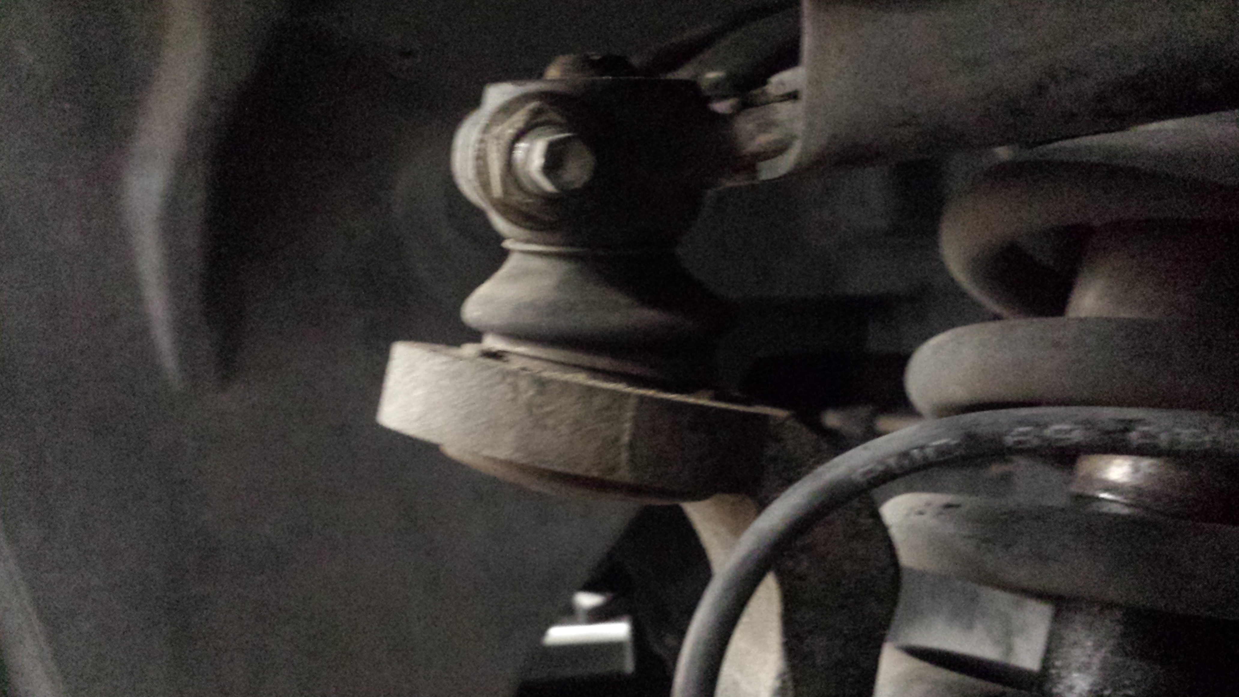

I got the UCA's flipped. That's not that hard at all. I had seen were some people were cutting there inner fender liners and such. I had t slightly bend the inner lip of the forward left fender to clear the head of the bolt. Other than that they just came out. After I was done I went over to the alignment rack to see where everything was. :mechanic: It was all over the place. I worked it around a bit deciding how much camber I wanted vs caster. Flipping the UCA's cost about 2 deg of caster and pretty much maxed out the adjustments. There is a little wiggle room in the front for caster but that's it. The drive seemed good. nice and strait no pulling or wandering. The real question is did the lateral shake go away.......Nope :wallbash: Looks like its going to be the CV's Anyway its going to be a while till I get more doll hairs for CV's as I had blown both front shocks when lifting it today. Here are a few pictures of todays venture
Stock location of the UCA and ball joint angle with the lift.
Rear view of the upper ball joint UCA flipped
Side view of the upper ball joint with the UCA flipped
Before and after alignment
