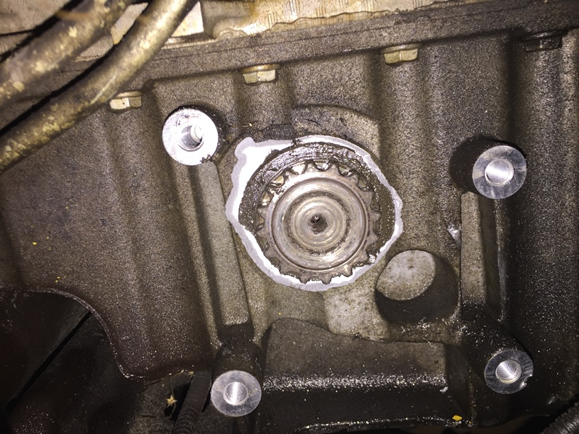

by bljis123 » Fri Nov 11, 2016 10:21 pm
My freaking disconnect housing busted and it stuck to the oil pan. This has me stumped for a while now. I am scared to damage oil pan.

by Trail X » Sun Nov 13, 2016 12:02 am
Others have drilled theirs out. You'll have to do the same. Pull the gear out, and pull the intermediate shaft out, then you'll have to make small drill marks around the perimeter of the needle bearing to relieve the pressure.
Mason, don't worry about a little wear on the intermediate shaft. It doesn't ride on any bearings, just seals. Should be fine.

by mason10198 » Sun Nov 13, 2016 11:10 am
larryk wrote:
mason10198 wrote:Alright, gotcha. Thanks! I've got the entire front suspension apart (went ehaead and put in my new struts and '87s) so I'm also replacing all of my UCA/LCA and strut bushings with "prothane" ones. They feel pretty dang solid, and hold tight without making a peep. Found out all ball joints have busted boots, so popping those out and replacing them as well since they have lifetime warrantee.
I feel you....did the complete front rebuild, including all your talking about, plus diff, plus sway bar bushings. Rides like a new truck...as it better, since all the parts are new....lol. Did you get sucked into the sand blast and paint thing like I did? Its a sickness :)
I reallllllly wanted to... But I talked myself out of it because I just couldn't justify it with my lack of time and funds. Plus, my truck is honestly in GREAT condition since it's been down south it's entire life. There's hardly a speck of rust (except the I shaft LOL) or any chipped coating anywhere.
