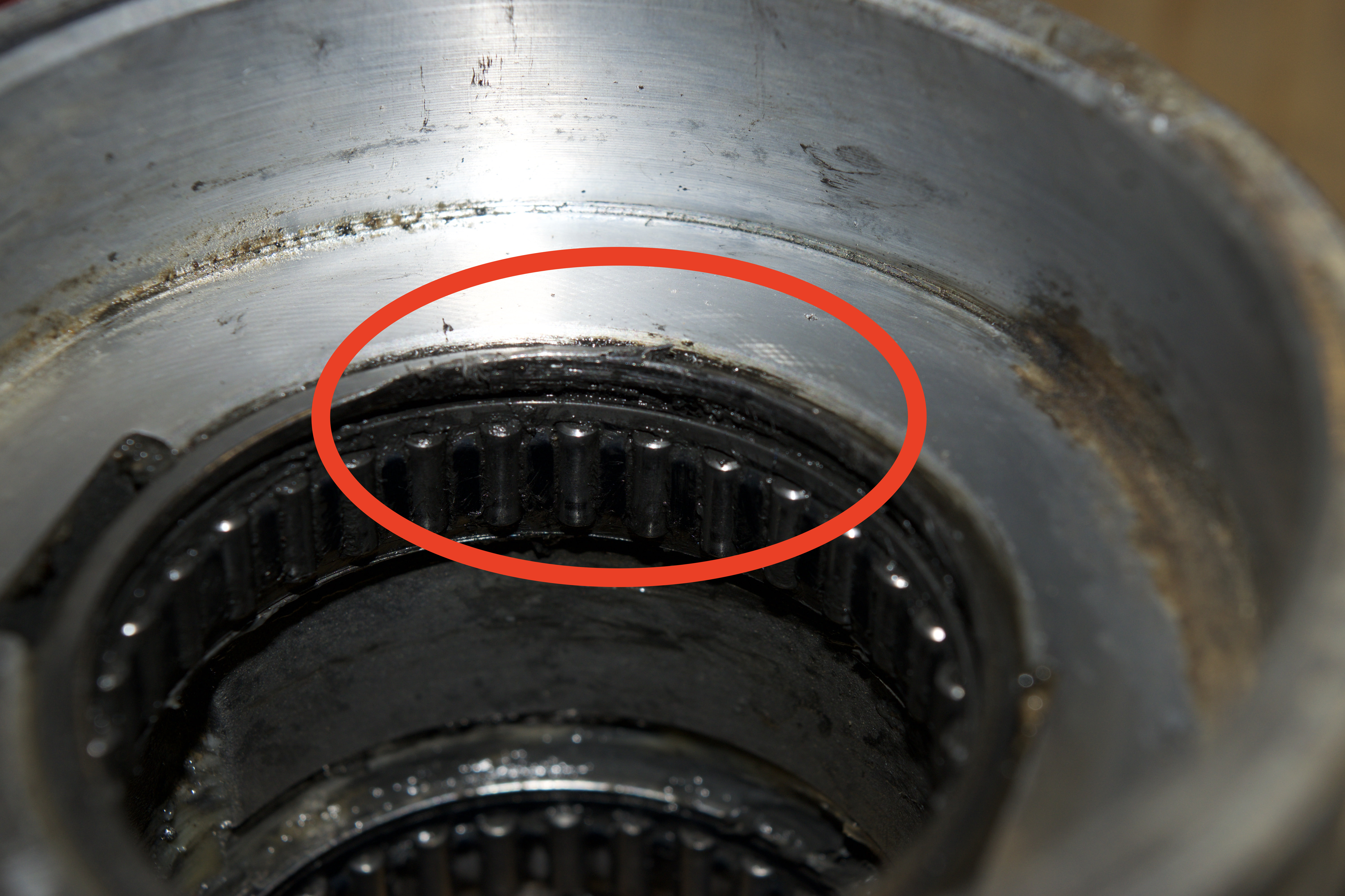

by mason10198 » Wed Nov 09, 2016 2:54 pm
Okay, I pulled everything apart. What I found:
    Disco side CV shaft has worn ridges from riding incorrectly in the disco
    USPowertrain disconnect is full of water, virtually no seal whatsoever between the two halves (sealing you see in the pic is 100% unaltered and right when I opened it), grease is clumpy and hard, parts look okay except for screwed up bearings from the shaft riding incorrectly.
    Intermediate shaft is rusty and appears to have ridges on it as well, might have been there before as this is the first time I've really looked at it.
So as far as I can tell, I need a new CV shaft, new/rebuilt disco, AND possibly a new intermediate shaft?? Does that even come out without removing the front diff? I still dont see where the problem came from in the first place anyways. All of the bearings are in good condition wear-wise, it just looks like the shaft was riding lower than its supposed to, and wore into them. Like something about the disconnect maybe isn't aligned properly? Or is it more likely something to do with the intermediate shaft instead? I guess another possible explanation is simply that the shaft never got fully inserted into the disconnect when I installed it... but I doubt it.

by bljis123 » Wed Nov 09, 2016 3:08 pm
How long ago was install? just curious based on how it looks inside...
Great pics!!! Yeah not good that all that mud and water got in and you can see the wear of it not sitting right. With a brand new disco and CV that makes no sense that it did not go in super tight and you have to play with it to get splines perfect to slide in. hhhmmmmm this concerns me with my part coming in next week.
WOW!!! The intermediate shaft looks awful. I believe the shaft has a Cir clip IIRC...

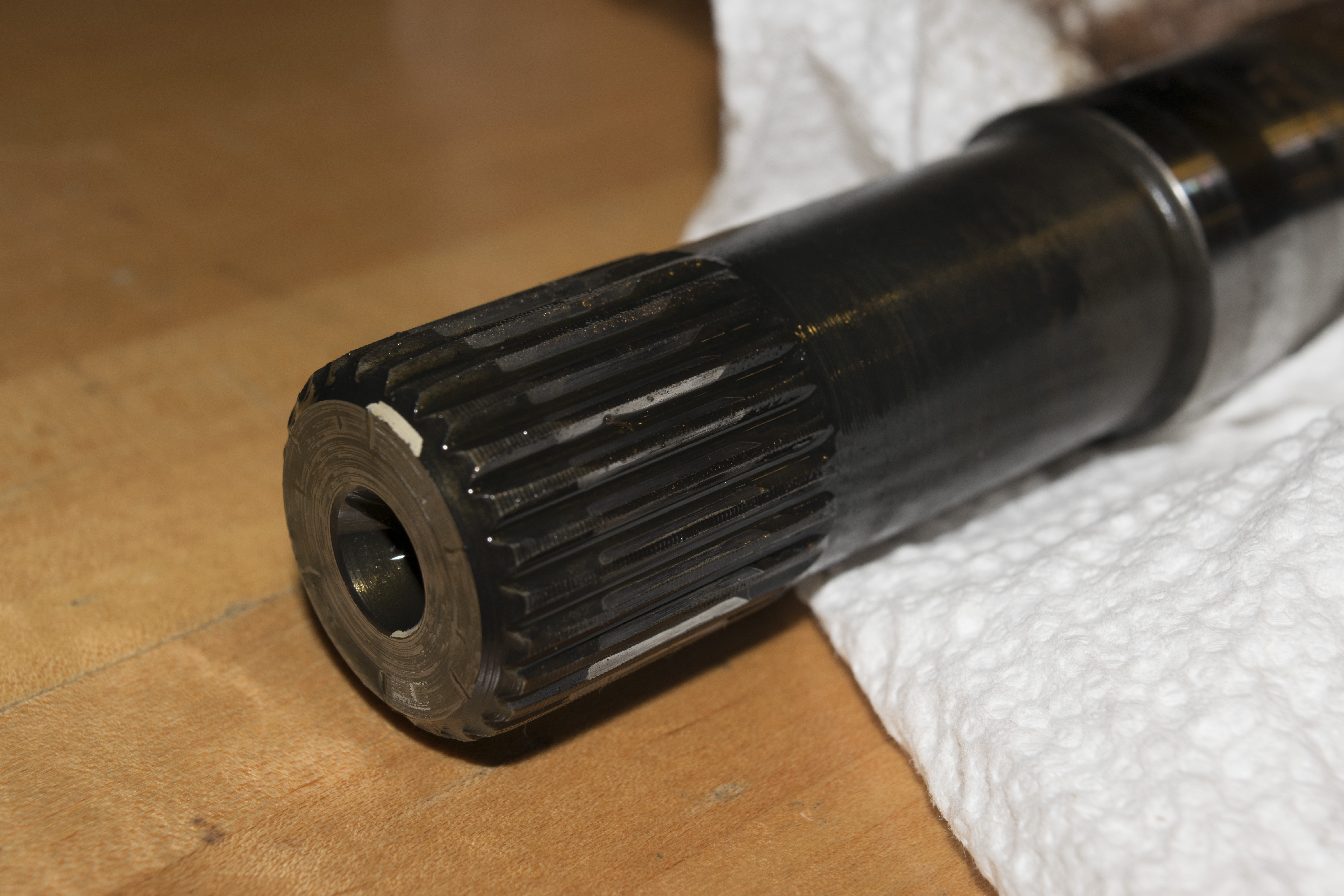

by mason10198 » Wed Nov 09, 2016 7:37 pm
I just pulled the thing out with no effort at all... just grabbed it with my hand and it slid out. I'm about to grab a brush and clean it up to see better, but here are some initial pics.

by Trail X » Wed Nov 09, 2016 10:33 pm
Strange that it affected your intermediate shaft. I've never seen one of those worn. The only guess there is that your needle bearings went bad - normally due to improper grease or water incursion. You ever submerged that disconnect? Something like that would do it, and cause your intermediate shaft to rust like that.
Its very possible that your CV shaft didn't fully seat. Sometimes they can be a pain to get fully seated - and they give you a false sense of being seated. Normally, I tamp mine in using the plunge joint of the CV shaft. You'll hear a tonal change when you get it fully seated - but I normally give mine a good 4 or 5 more taps. Did you grease the splines before inserting the CV?

by larryk » Wed Nov 09, 2016 10:56 pm
That shaft is toast, and based on the wear, it looks like the output bearing on your differential is bad too. I hate to be the bearer of bad news, but if this was my truck, I'd be pulling that diff to rebuild it. Did you check the fluid in it to see if there is any water in it? It's not right it just slid out too... :(

Never completely submerged it, but I can tell you it's been that rusty since the first time I ever got in there and saw it. I just now cleaned it up with a wire brush and it was pretty much all surface rust, only a few tiny pits in the surface. Masked the splines and threw a thin coat of rattle can on it just to slow that down. I guess you're right, I didn't do anything to get that CV shaft in except shove it in by hand and call it good. I'll be doing a better job of that from now on.
larryk wrote:That shaft is toast, and based on the wear, it looks like the output bearing on your differential is bad too. I hate to be the bearer of bad news, but if this was my truck, I'd be pulling that diff to rebuild it. Did you check the fluid in it to see if there is any water in it? It's not right it just slid out too... :(
The pictures make both ends of the intermediate shaft look bad, but there is only physical wear on the disco end of it. The diff end is fine, and I can confirm there is no water in the diff fluid. The fluid in it is also relatively new, within the past 8 months. I slid the intermediate in and out a few times and there were no pops or engagements of any kind, it came out just as easy every time.
by larryk » Thu Nov 10, 2016 10:17 am
So that shiny band on the diff end, where the bearings ride, isnt worn? I guess if there is nothing you can feel with your fingernail, just give it a quick cleanup with a scotchbrite pad, and you would be good to go. Somewhat concerned that you can insert and remove the shaft that easily though. Literally every intermediate shaft I have ever dealt with on these trucks is a tight fit in the diff....where you need at least a bolt in the end of the shaft and a pair of vice grips to pull it out.
