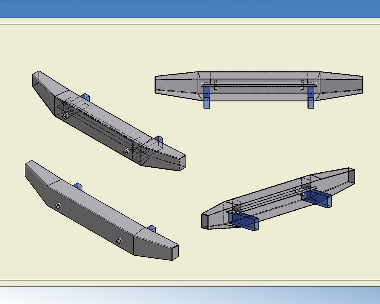

Based on what we were talking about, sort of like this is what I was thinking... Still about 60# ($35) of material (the square cutout, not the bumper) if we use 10ga (.135"), and as long as we do stuff the hard way (shear mostly, and plasma cutter for notches), and not touch the turret punch press, the bends aren't too much $$... Bumper should weigh in around 47# in 10ga, as it sits there...
For tow points, we'll have to see where it mounts on the frame, then run a stiffener across the back side, through the middle, and run some 3/4" thick bar through the bumper; weld it on the front and back side of the bumper, as well as weld it to the stiffener...

This is what I have in mind for the back part of the bumper... (the blue parts are the frame)

by Regulator1175 » Tue May 11, 2010 1:13 pm
Looks pretty good!
What about incorporating a hitch receiver into the bumper? I know you have talked about no wanting a permanently mounted winch, so that would allow you to have a bit more flexibility with a winch.
Posts: 1048
by Gordinho80 » Tue May 11, 2010 1:14 pm
Dude! That looks awesome!
If I did a bumper, it would be pretty much JUST like that... is this a new item for the Trailvoy Armory?

by bartonmd » Tue May 11, 2010 1:16 pm
Regulator1175 wrote:Looks pretty good!
That'll work with this, in the middle, but the same height as the shackle mounts, mounted the same way (with more reinforcement)... however, I'm not sure how far back the frame crossmember is... Plus, since he's got the radiator skid, it would have to stick out enough such that the 5/8" hole is in front of the bumper, not behind it... We can talk about it tonight, over there, while looking at the thing..
Posts: 4471
by bartonmd » Tue May 11, 2010 1:18 pm
Gordinho80 wrote:Dude! That looks awesome!
It can be... This one is made specifically to work with his body lift, though... The non-body lift one would be shorter... Just on top and bottom of the frame rails, and would mount right up to the radiator guard that Kyle's got, but is not in production yet...

by Trail X » Tue May 11, 2010 2:20 pm
Pretty sweet there Mike.
KMA has a solution for differing body heights. They have the vertical 'stiffeners' welded into the bumper, but include the frame C brackets in the package. You weld the C brackets on to the vertical stiffeners at your intended height to determine your body gap. You could do the welding in house based on 3 positions... (no body lift, 2" and 3" body lifts)... just leave a 3/4" or so of clearance to ensure there's no tolerance issues.
You may be able to stick your head up into my bumper during TECORE to see how the mount system works.
Also, KMA had 1/4" steel in the center of the bumper and 3/16" for the "wings" if I recall. So it's three big pieces welded together.
Posts: 9922
by bartonmd » Tue May 11, 2010 2:29 pm
JamesDowning wrote:Pretty sweet there Mike.
Awesome, thanks!
Also, you sure it isn't 3/16 in the middle, and 1/8th on the wings? 1/4, even in the middle, seems way overkill...
Thanks,
Posts: 4471
by Trail X » Tue May 11, 2010 2:42 pm
Maybe that was it. I know the center is really beefy - maybe 1/4" was the receiver stiffener. Maybe you're right though.
I'd measure it, but it's raining and I don't want to melt.
Posts: 9922
by bartonmd » Tue May 11, 2010 2:45 pm
JamesDowning wrote:Maybe that was it. I know the center is really beefy - maybe 1/4" was the receiver stiffener. Maybe you're right though.
Haha... No big deal... I was just curious... With the stiffeners, 10ga will be plenty for this one...
Posts: 4471

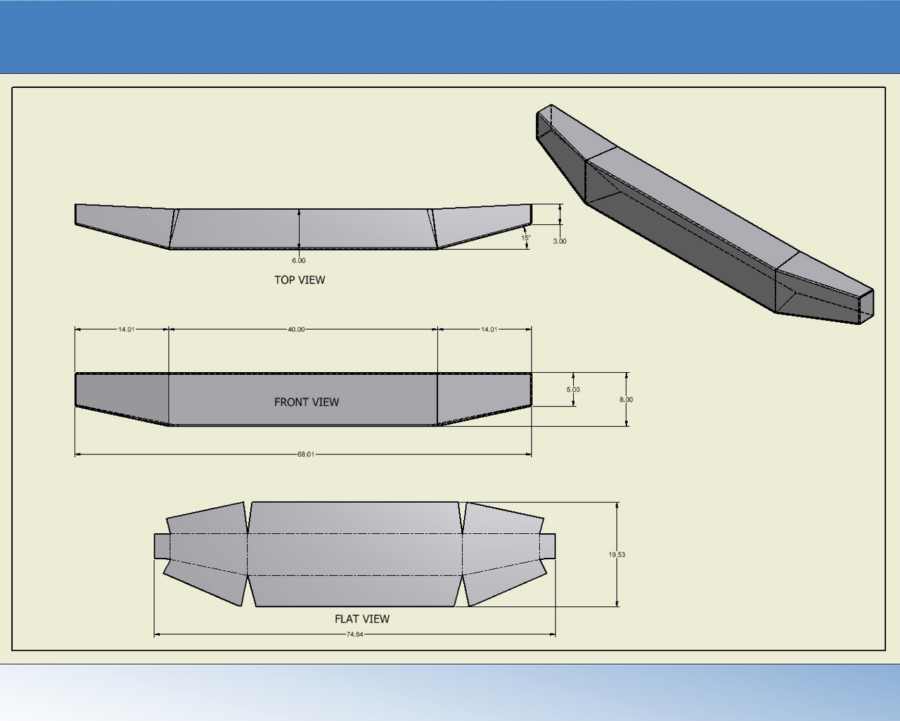

by HARDTRAILZ » Tue May 11, 2010 9:34 pm
Well it looks like we have a plan and are gonna get this started asap. Gonna go a bit thicker on metal and angles are a bit steeper when we measured. I cant wait for this. :excited: :excited:
Posts: 6319
by bartonmd » Tue May 11, 2010 10:00 pm
Yep, I'm sure the 10ga would have been strong enough, but for the extra 15lbs, 7ga is probably the way to go...
ike
Posts: 4471
by bartonmd » Wed May 12, 2010 8:06 am
After the measurements we took last night, I adjusted the angles a bit... I'm thinking (hoping) this is going to turn out really well!
