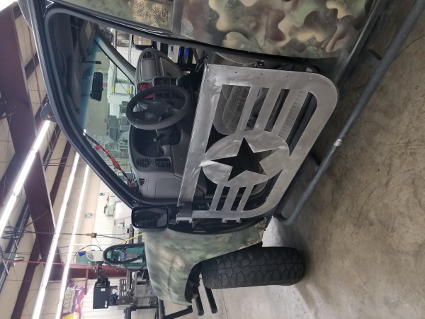

by cpyonker » Mon Sep 10, 2018 6:21 am
Sweet, what’s the mechanism to latch it to the other side?
cpyonker
Posts: 268
by 02inblue » Mon Sep 10, 2018 8:11 am
Excited to hear what you’re using for a latch also. I’m working on some tube doors, but my
Plan for the latch side isn’t really great.
02inblue
Posts: 9
Joined: Mon Jun 11, 2018 6:03 am
by mall_creeper » Mon Sep 10, 2018 2:37 pm
I thought of using a seat belt latch, not there yet. Lol
mall_creeper
Posts: 12
Joined: Tue Jul 31, 2018 6:22 am
by cpyonker » Tue Sep 11, 2018 7:50 pm
That’s actually a great idea
cpyonker
Posts: 268

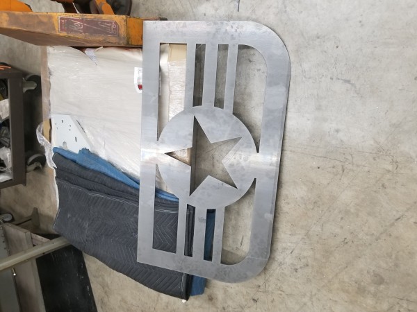

by mall_creeper » Sat Sep 15, 2018 6:28 pm
Best we could do. Bends are hard. For the latch we used a 5/8" spring latch, welded to the door, and used a piece of square tubing with three holes in it mounted in place of the door striker.
