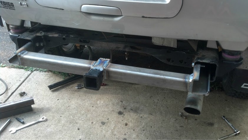

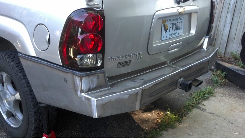

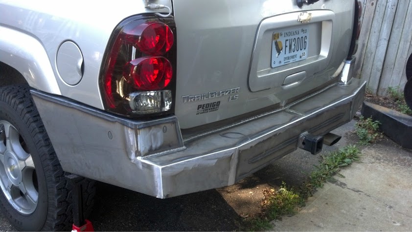

I'll have the extra obstacle of designing for a 3" body lift, and I want to do so without making it look super uneven and blocky. What I've been considering is just taking Barton's design (below) and extending the height of everything above the main structural body of the bumper by 3 inches to fill the gap.
I also thought about taking the bumper's frame (below) and somehow raising it up 3", kindof like how theliftmeister 3" BL rear bumper brackets work, but that would raise everything including the receiver and probably lose overall rigidity.

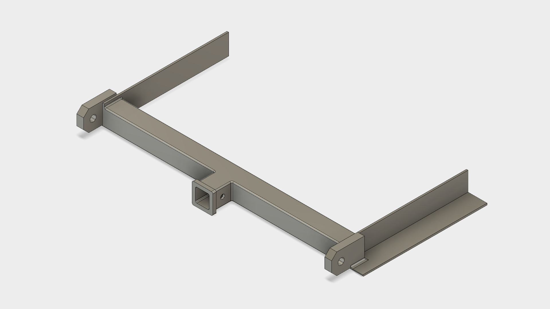

I have a CNC plasma table and a new 240v multiprocess welder so I should have everything I as far as building it. I'd like to have a nice model of this before I build it, and if I'm going to use the plasma table that's going to be a must anyways. I have an Autodesk license, so I'll be using Fusion360. I've never done any sort of 3D or CAD design work before, so if you have and you're reading this PLEASE bear with me! :lol:
I've made it as far as modeling the frame of the bumper, where it will mount to the frame of the truck and then be built out from there. Stay tuned....

Looks like fun. I design in 3D just about every day here at work. Looks like you're making good progress.
The way you have your hitch tube doesn't look like it will be able to accept a normal hitch, looks too shallow. Might want to consider just welding your hitch receiver above or below the cross tube. It'd certainly be easier. Also, I'd recommend buying a receiver tube instead of making your own. Receiver tube doesn't have the weld seam inside... and believe me, that stupid weld seam will get in the way and you can never really grind it down.

The receiver goes in to a 3x3 not a 2 inch so it passes all the way through. The shackle mounts are not on the hitch but cut out and slid through the outside so it is welded on both sides.

Trail X wrote:The way you have your hitch tube doesn't look like it will be able to accept a normal hitch, looks too shallow. Might want to consider just welding your hitch receiver above or below the cross tube. It'd certainly be easier. Also, I'd recommend buying a receiver tube instead of making your own. Receiver tube doesn't have the weld seam inside... and believe me, that stupid weld seam will get in the way and you can never really grind it down.
Yeah, I would buy one and not try making my own. I was trying to model Mike's design in the 2nd pic.

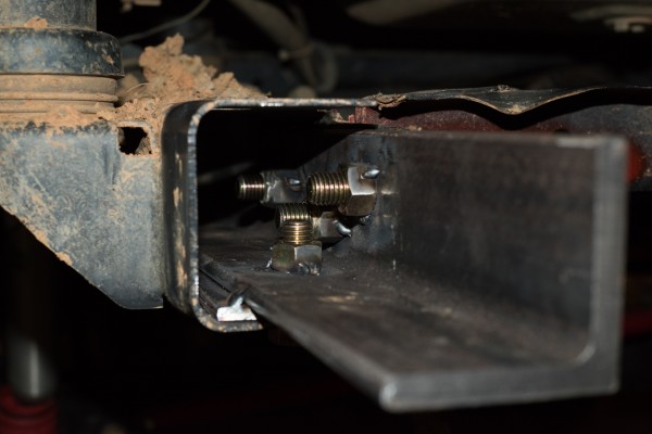

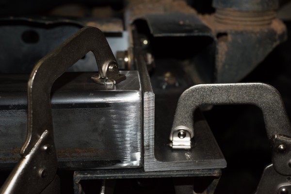

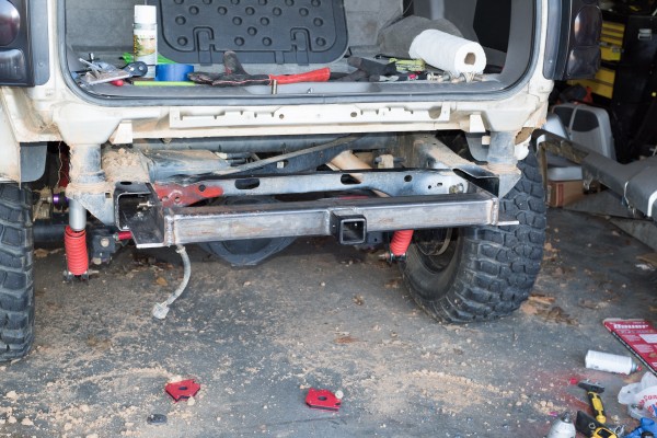

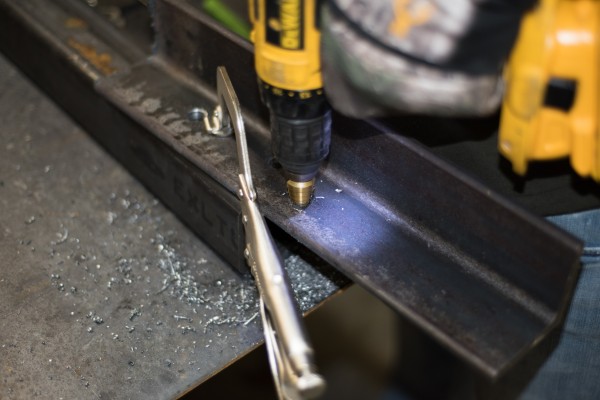

by mason10198 » Wed Jan 17, 2018 10:05 pm

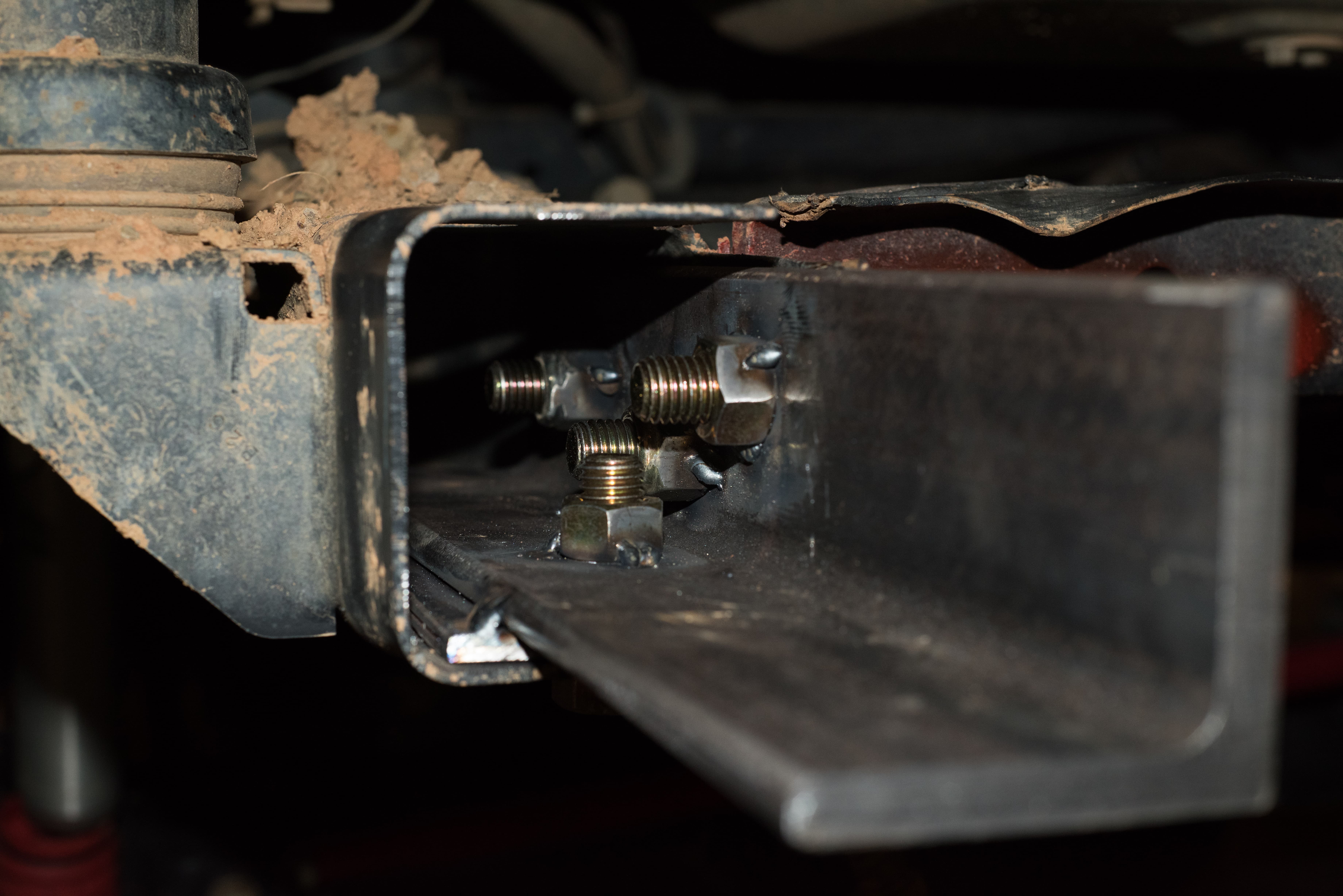

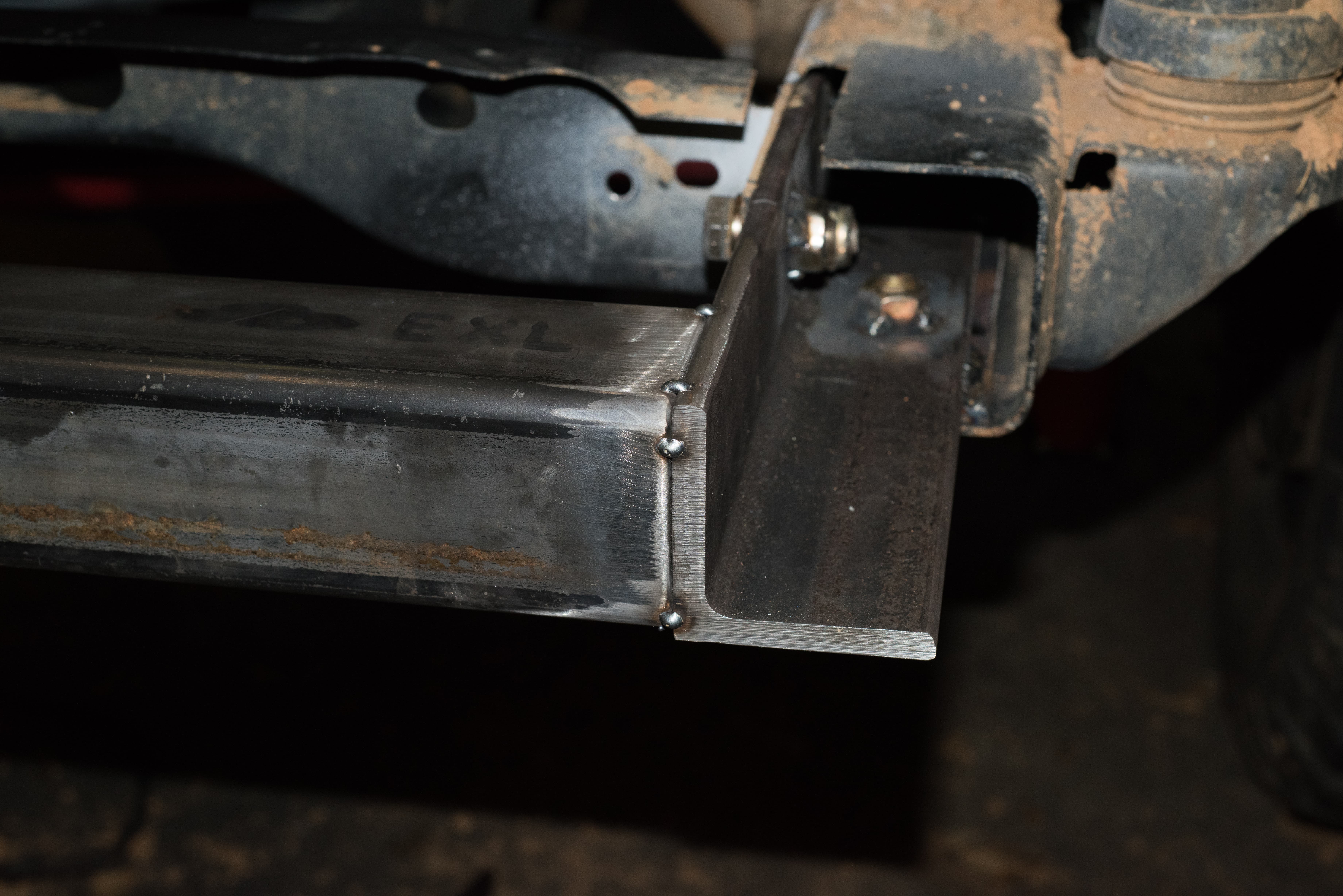

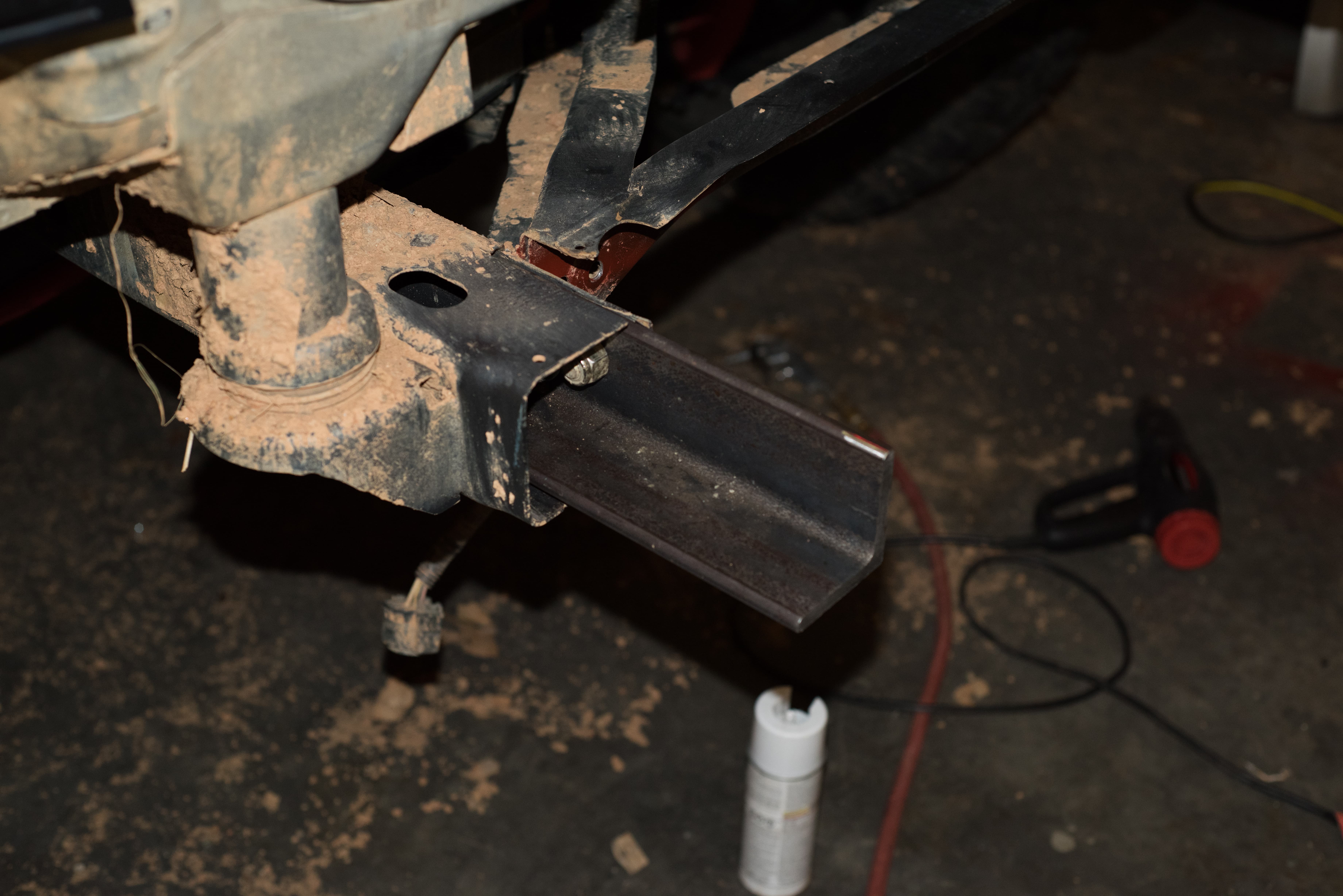

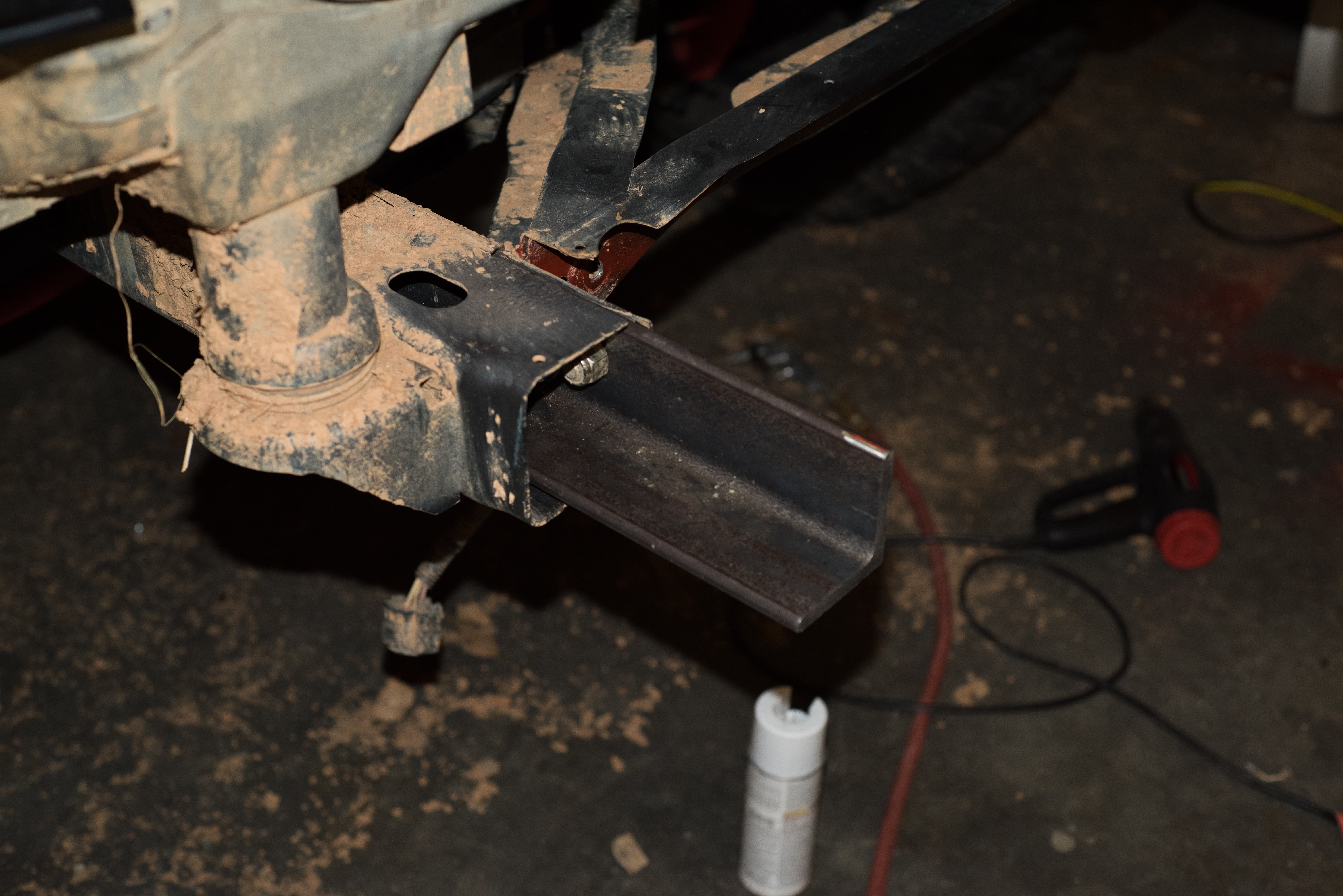

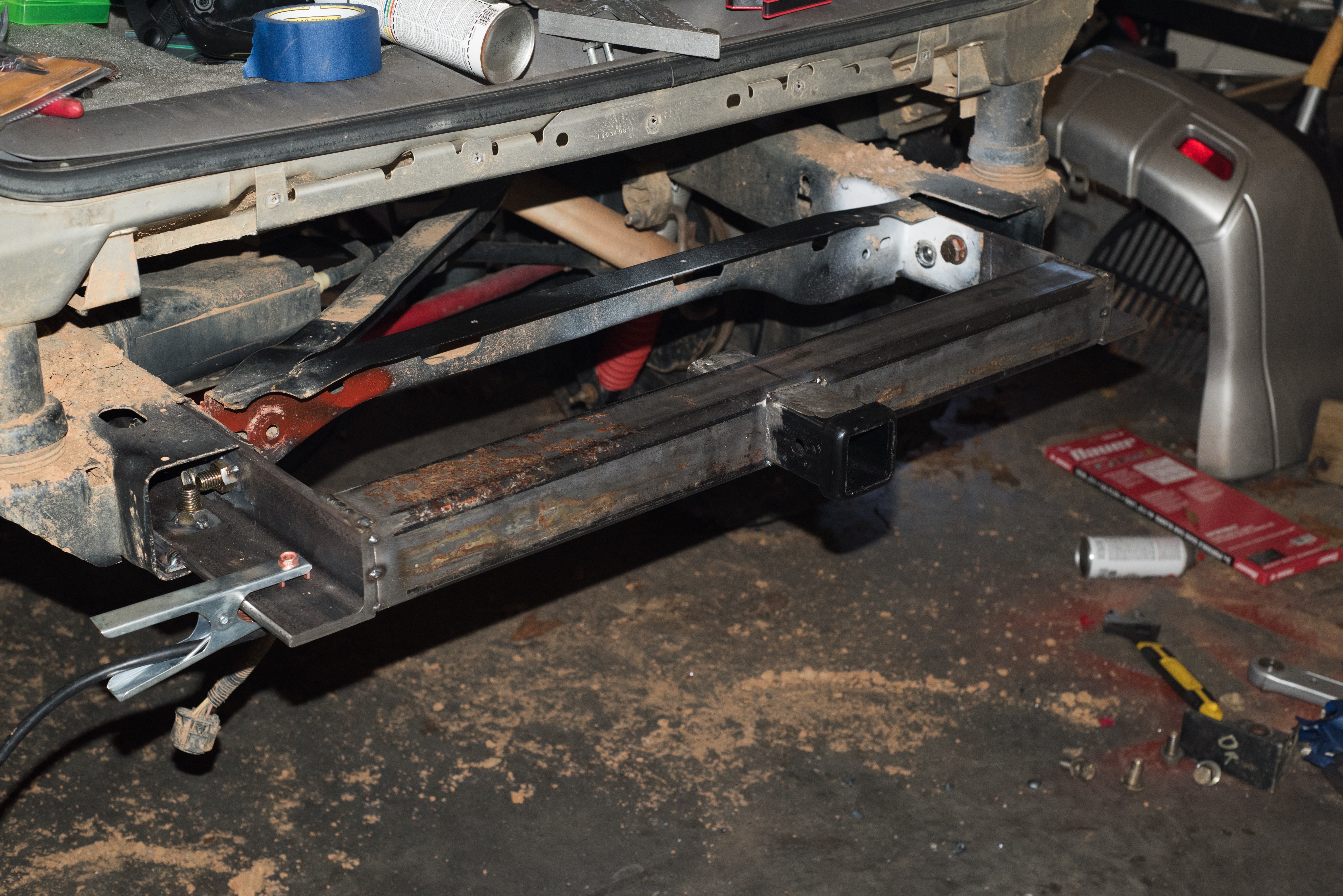

I will be basing most of this from Barton's build of the 3" BL rear, which CAN BE FOUND HERE. Of course, it wont be exactly the same, mostly because my fabrication skill level is about 0.07% of sir Bartons. I'm going to be building a single swing type as opposed to the dual swing design since it will be easier to build. So far I've got the bumper's frame welded up, and that includes mounting rails (3x3x3/8" angle), mounting nuts tacked on, main cross-tube (3x3x1/4" square tube), and the receiver tube. I added a fourth mounting bolt on the bottom of each frame rail for piece of mind. So, with (2x) 3/8" brackets each mounted with (4x) grade8 5/8" hardware, I don't think its going anywhere. Oh, don't forget the loctite! Also, I followed Mikes shackle mount process detailed HERE for welding these main structural assets of the bumper. As it stands, this should be a class IV receiver.

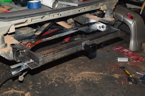

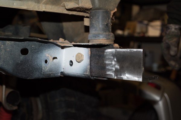

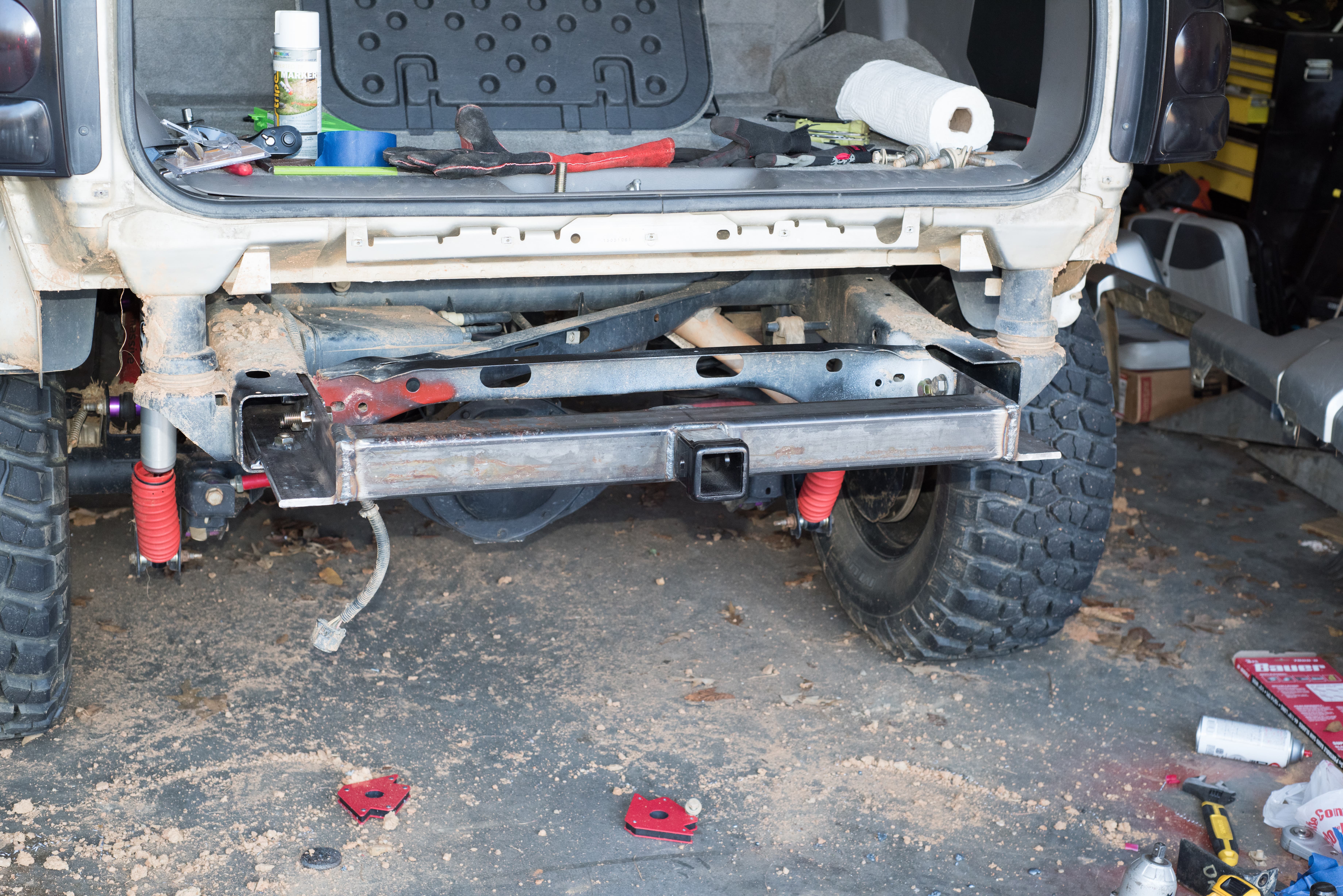

by mason10198 » Wed Jan 31, 2018 3:53 pm

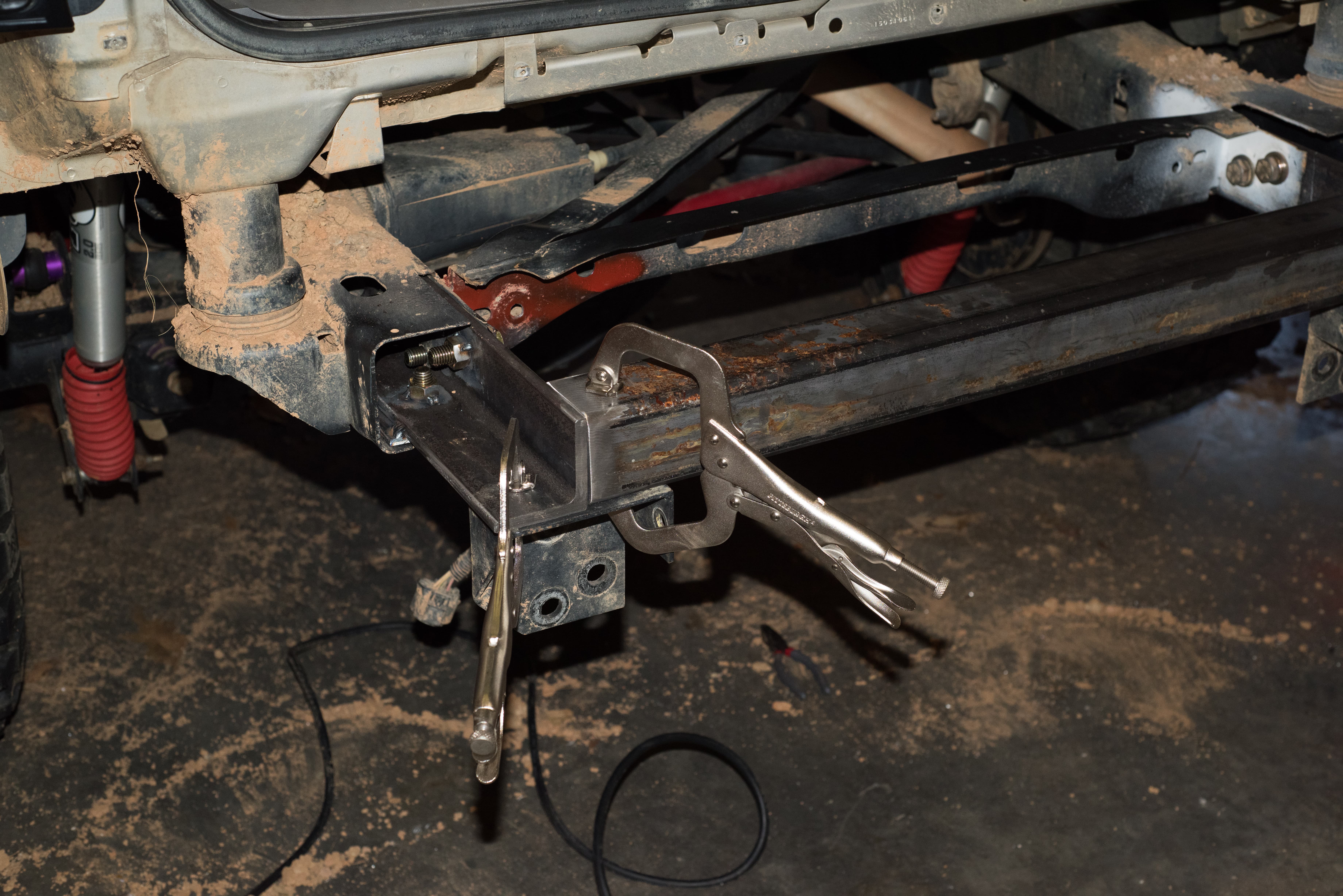

Bit of progress from this past weekend. Still taking measurements here and there and figuring out angles to get the main body together. Attempting to add to the Fusion model as well.ImageImageImageImageImage
