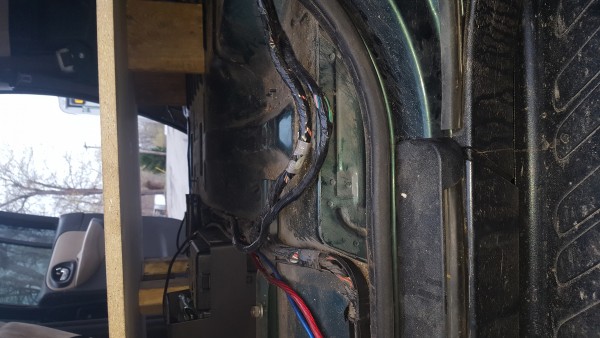

Picture of bracing I attempted under the 3/4. Hopefully enough room to access the fuse block and pcm.

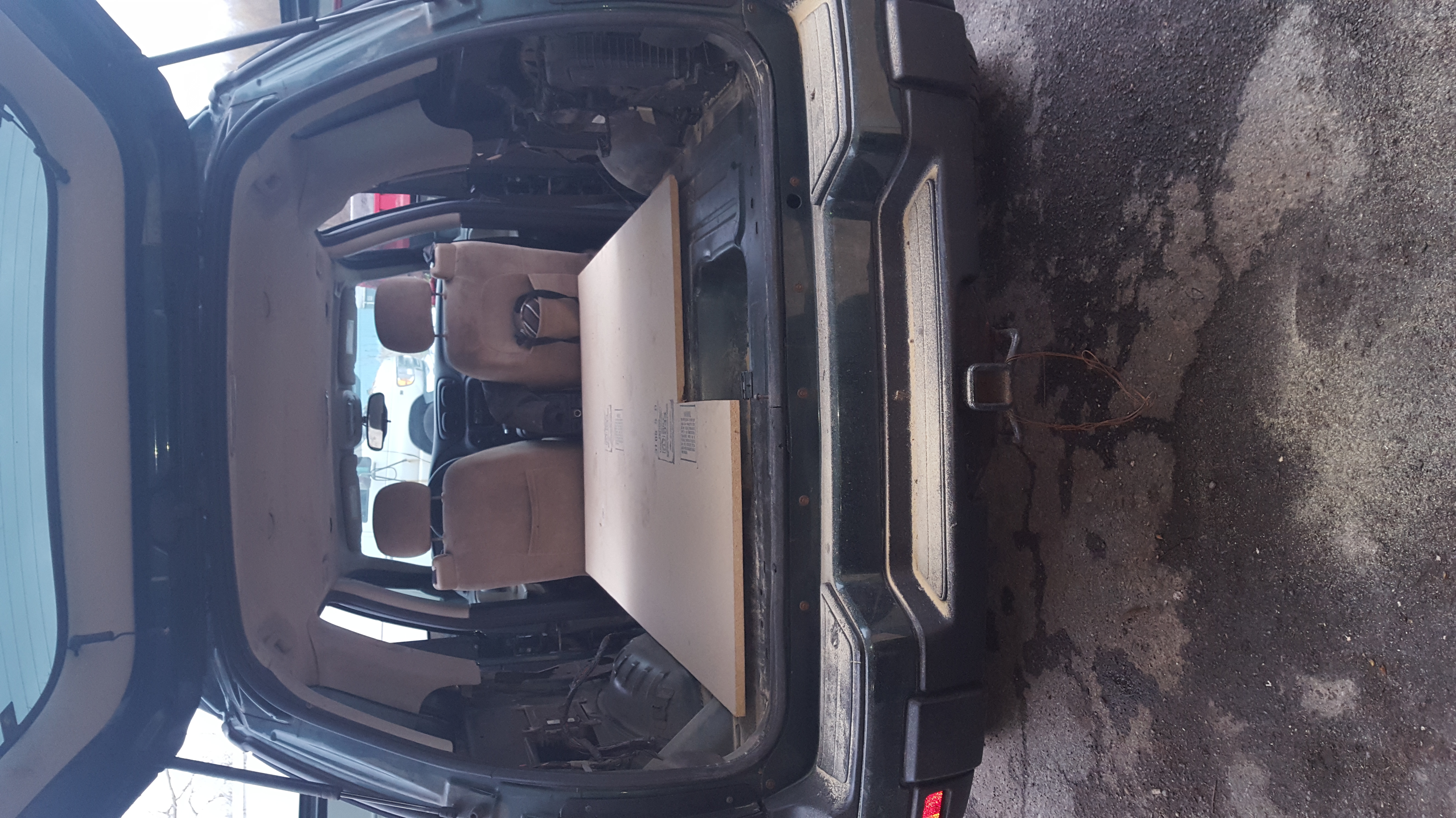

Picture of today's final product with the base set in
