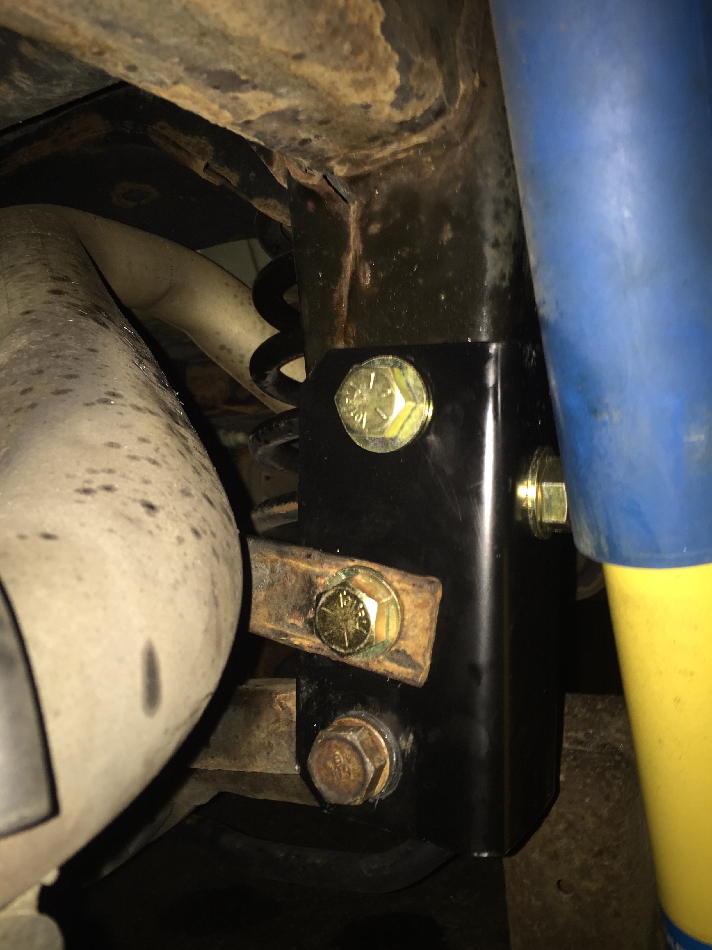

I am currently installing the panhard bar drop bracket and the panhard bar lines up perfectly with the bottom hole of the bracket, but the strut support bar isn't even close to lining up with the bottom hole of the bracket. Is it perhaps a misprint and the strut support bar stays in the normal location? I cut the spare tire support piece that was holding it up. The axle is level to if that makes a difference

by Rickalicka18 » Thu May 26, 2016 8:23 pm
This is currently how I have it now.
Update: it recentered the axle like its suppose to and also made the shaking I get on acceleration not as bad... So I think its the u-joint that needs replacing.

by TBYODA » Sat May 28, 2016 12:00 am
That bar need to be on the bottom, like this.

by ErikSS » Sat May 28, 2016 6:01 pm
I had to loosen the other end of that angled support a lot... then it gave me the slack I needed. You may have to line it up with the bolt, then slide the bolt through it. It is a tight fit. Robert has better pics than I do.

by ErikSS » Sat May 28, 2016 11:46 pm
The difference shouldn't be dramatic. It just gets everything aligned the way it was meant to be. The 2 biggest differences should be when the axle is moving up and down there will be a reduction in side to side motion, and the axle should be more centered. You wouldn't be the only one running around with the strut support in that location. I do still suggest lowering it so that it takes more stress off the factory mount.

by PROSPHOTO » Sat Jun 04, 2016 5:41 pm
I installed mine today and it was pretty easy... Hardest part was getting the upper bar to line up with the lower hole as mentioned. I used a pry bar to get it lined up then hammer the bolt through, running it in with the impact gun. I did the install with the rear axle on jack stands instead of hanging and it went pretty smooth.

by Beamer » Sat Jun 11, 2016 8:27 pm
ErikSS wrote:The difference shouldn't be dramatic. It just gets everything aligned the way it was meant to be. The 2 biggest differences should be when the axle is moving up and down there will be a reduction in side to side motion, and the axle should be more centered. You wouldn't be the only one running around with the strut support in that location. I do still suggest lowering it so that it takes more stress off the factory mount.
I still carry my spare tire under the TB and can't lower the strut support to the lower hole on the drop bracket. Is anyone seeing issues that is running with their strut support mounted to the top hole?

by TBYODA » Sat Jun 11, 2016 11:41 pm
Beamer wrote:I still carry my spare tire under the TB and can't lower the strut support to the lower hole on the drop bracket. Is anyone seeing issues that is running with their strut support mounted to the top hole?
I can get my stock spare under with out any issues. Even with strut in the lower hole as intended.
