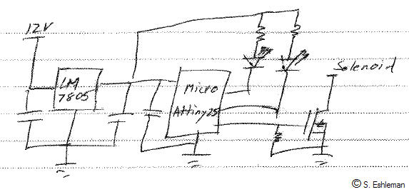

The signal wire, from the front switch, runs to the solenoid signal pole. Also getting 12V from this signal wire is my delay. This home-made digital delay waits 5 minutes before then connecting the ground side of the solenoid to ground through a FET rated for 1 amp continuous.

I got a lot of help on that part from my buddy, who's a computer engineer. I know it had a micro controller that threw a 1 Amp FET (like a mini relay) after a 5 minute countdown. I can do analog circuits, but digital circuits aren't my forte. I was able to follow what we did, but I couldn't draw you a diagram.
The code was fairly simple though: Green LED on. Wait, 300 seconds. Red LED on. Send power to FET.
It was an 8 pin controller, and we only used Power, Ground, and 3 other pins.

Philberto wrote:I meant for the digital delay... I can follow circuit diagrams, but just can't design my own.
I got my buddy to draw up the timing/delay circuit from memory (he warned it could be slightly off):
The LM7805 is the voltage regulator, drops the 12V down to 5V for the micro.
LM7805:
The micro is an Attiny25, 8 pin micro. Here's the specs of the Attiny10, 6 pin:
The last part is the FET, basically a mini relay. Make sure this is rated to flow the amperage that your solenoid requires. Mine required just under 1 A.
Hopefully that helps you some.

For clarification, a FET is a "field effect transistor", and is basically an effecient, high current transistor (no relay contacts, but silicon that either blocks current, or lets it through, depending on what you're doing with the Gate... Also has a linear region in the middle, which will cause the thing to sink a lot of heat, so watch turning it half on or something). A lot of times, they look like the picture you posted of the 7805 voltage regulator (TO220 package)...
by Trail X » Mon Dec 21, 2009 4:22 pm
The FET isn't really a relay, you're right, but for explanations-sake, it's a close likeness... at least to an ME.
