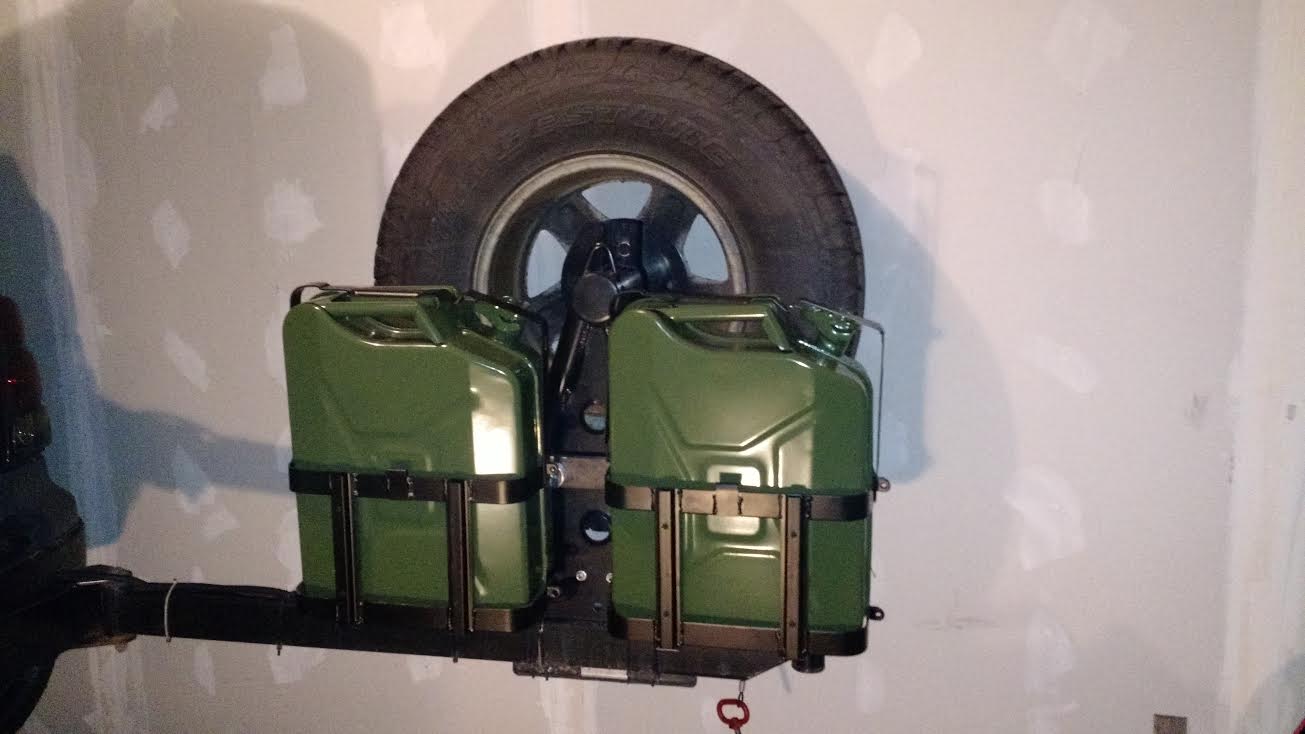

I decided to see if I could make my own alternative. I bought two jerry can holders on Amazon for $35 each and realized that I could mount them to the tiregate pretty easily. I went to Home Depot and bought several feet of 2"x3/8" steel bar, drilled and hole-dozed it to fit the 1" tiregate mounts, and mounted the jerry can holders directly to that. Another steel bar runs across the lower section and is bolted to the tiregate to ensure that the cans don't sway. It is primed and painted so it shouldn't rust.
The jerry cans sit about 1" off the gate of the truck and about 1" on top of the bumper step. I can open the back window without issues.
My Homemade Jerry Can Holder

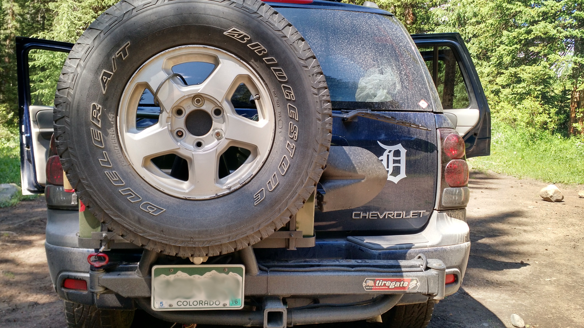

Here's the view from the back. The shovel straps on nicely between the jerry cans and the tire gate.
back view

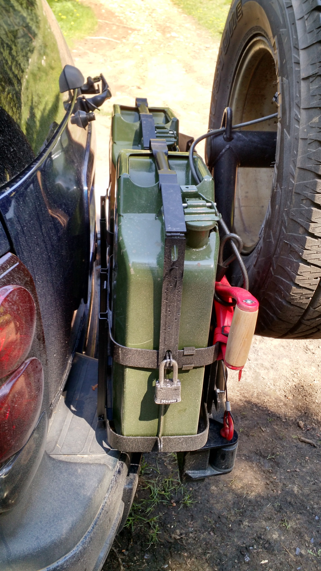

side view

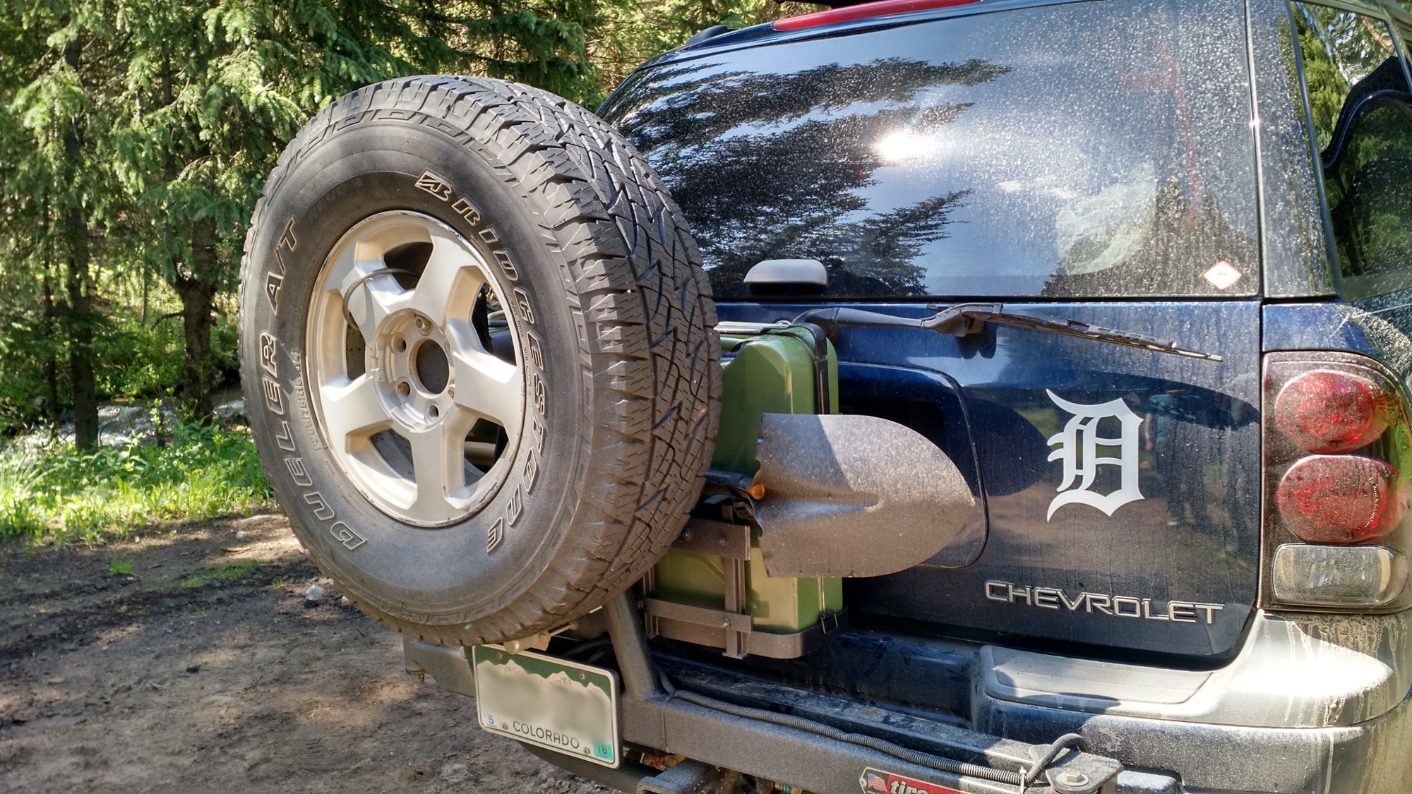

From the back and to the passenger side.
back and side view
