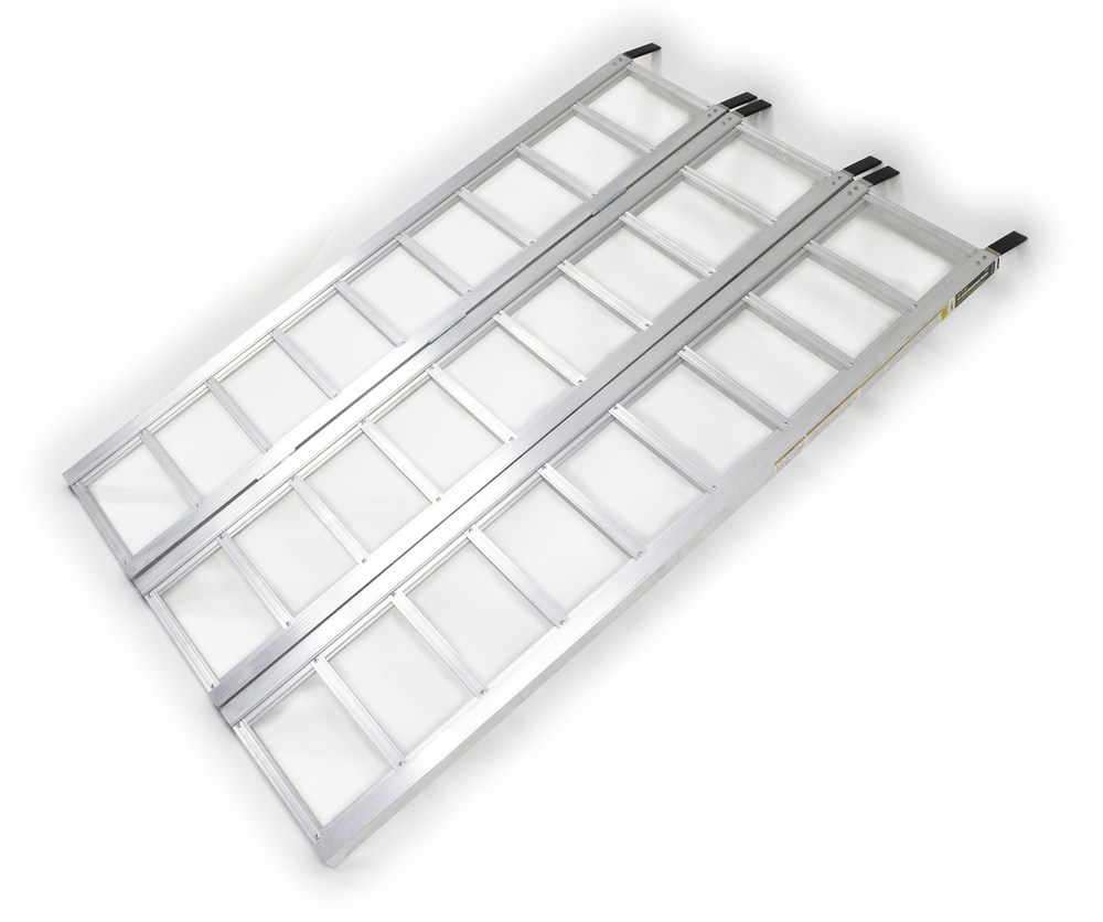

Just like the subject says how strong is this stuff? I went Kyle's route with the Tri-Fold Ramp for my roof and now that im getting too many of the "WTF" stares from my fiance about wind noise I'm looking to fix the problem.
My original plan was a sheet of Plexiglass cut to fit and bolted to the standoffs on the rack. I was a little nervous that Plexiglass wouldn't hold up to the wind (looking at .220 thickness 48"x24" for around $25) so I ended up buying a Yakima fairing from Dicks that was too small in length and just as thick and flemsy as the Plexiglass.
Anyone have a knowledge of the Plexiglass that can say it would work? The standoffs on the rack are roughly 45" from end to end and roughly 11.5" apart from each other so it would be braced in the middle.

by Trail X » Sun Dec 15, 2013 8:02 pm
You've gotta have something for it to tie down to on the roofline, right? How are you making that connection/attachment?
Posts: 9935
by Blazintrails03 » Sun Dec 15, 2013 8:54 pm
This is as close as I can find. It just isn't the harbor freight model. The plexiglass will be mounted black parts on the end. There will be a gap between it and the roofline just like most fairings and baskets.
Blazintrails03
Posts: 359
Location: VA, Manassas
by Trail X » Sun Dec 15, 2013 11:53 pm
I guess I thought most were a little more supported. I think the plexi will be a bit too flexi without another support lower on the faring, but it also greatly depends on your dimension, 4" or 12" is a big difference.
Posts: 9935
