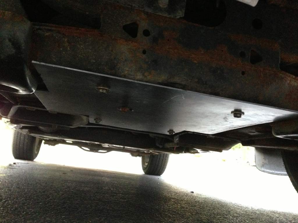

Mocked up under the truck with cardboard. :woot:
Transferred to steel.
All cut out.
Drilled, I still have to make bigger hole for the oil plug. Got to pick up this up 1 1/2 drill bit or maybe try this one since it is cheaper. Step Drill

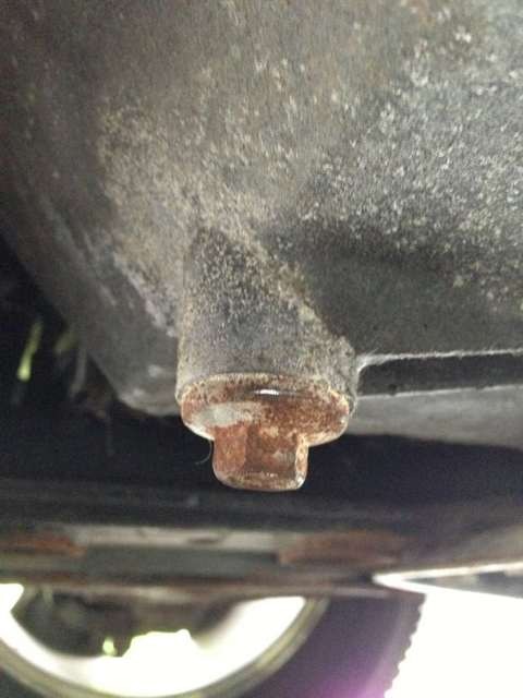

Looks familiar. Just make sure you have enough clearance around the oil drain bolt. My first design would hit under acceleration, later made another "step" and no issue anylonger.

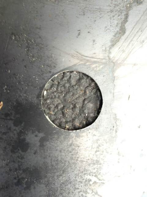

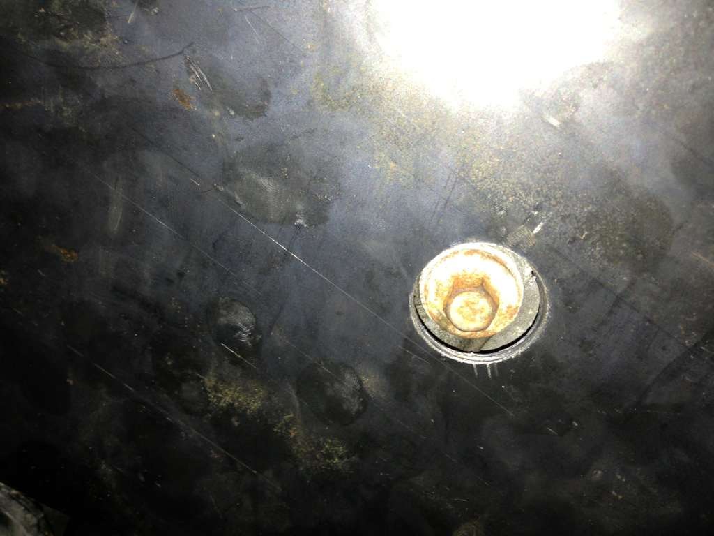

So I picked up the step drill from HF and drilled out a larger hole under oil drain and test fitted the skid.
With the help of my son we started the TB and rev'ed the engine a few times to see if the oil plug would hit. I did not see or hear it hit but will drive it to work and see. Hole is a little off center might need to take of more steel on the one side. Did not really measure the holes or anything. :-)

by bartonmd » Tue Jul 09, 2013 9:54 pm
You won't see it hit until driving it, likely. Worst case is 4LO, back and forth between high load and engine braking.
The other issue is when there is something (a rock) pushing the skid up onto/around the aluminum post that holds the drain plug, and you shock load the drivetrain in 4LO. The hole needs to be at least 2", IMO.

Is the thickness of the plate alright?
Posts: 1762
by bartonmd » Wed Jul 10, 2013 6:49 am
TBYODA wrote:Is the thickness of the plate alright?
The plate is 1/8". I make mine out of 7ga, which is just a hair less than 3/16" and it still gets a lot of its strength from the pyramid in the middle. It's certainly better than nothing, and if you do the larger hole and pyramid right, it'll be better and stronger than the stock plastic one.

Well took the plate off and it did hit a little, will be making hole bigger. :wallbash: :angry whip:
