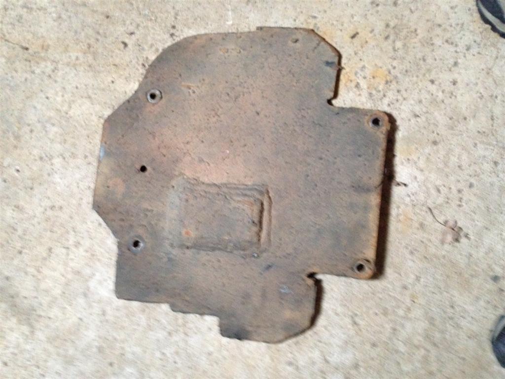

Thanks everyone for all the great input here on the skid plate. I had every intention of completing this build remaking from 3/16". However a opportunity fell in my lap in the form of completed skid from fellow member that I could not pass up. :happy whip:
