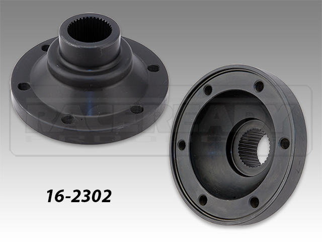

There are some 930 adapters that would probably work alright, just need a splined shaft with a bearing surface made up to plug into the adapter and front diff... or maybe cut up a stock tripot and get it welded to the adapter. From there a 930 CV bolts on. Then an axle that has 28 instead of 27 splines for the inboard side completes the package. I'm reasonably sure you could do it for a good bit cheaper than your low price. It would depend on what you could get the shafts made for.
http://www.racereadyproducts.com/transm ... n-flanges/
http://www.appletreeauto.com/TYPE-1-TO- ... -AC525105/
It would get you more angle, not sure if it's worth the effort when we're still limited by the balljoint and shock.
