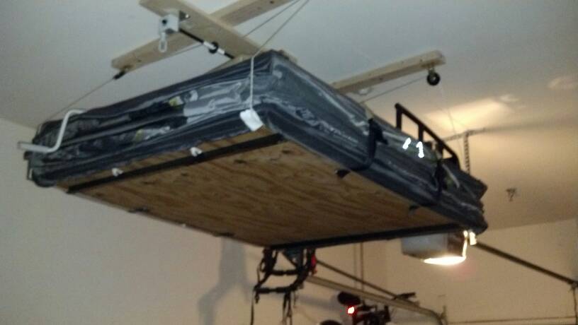

by Trail X » Wed May 30, 2012 5:49 pm
Finally got the hoist up in the garage and the rtt off. Seems to work great so far. Allows me to even store the half rack on top if the rtt.
Annoying part is that I have to remove the cover and ladder to fit the truck w/ rtt into the garage. I do need to get more rope though... i'd like to be able to lower the tent all the way to the ground if needed.
