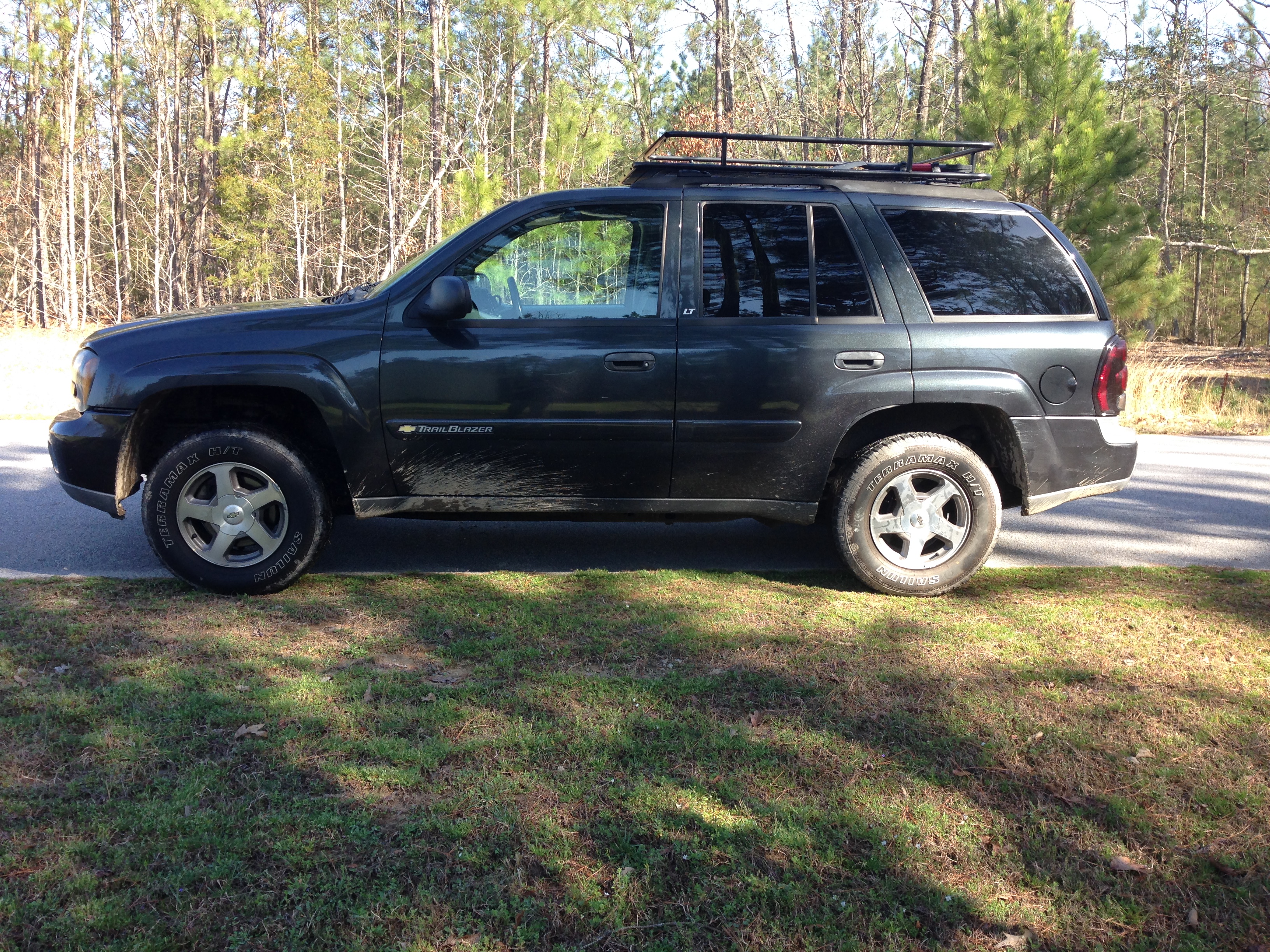

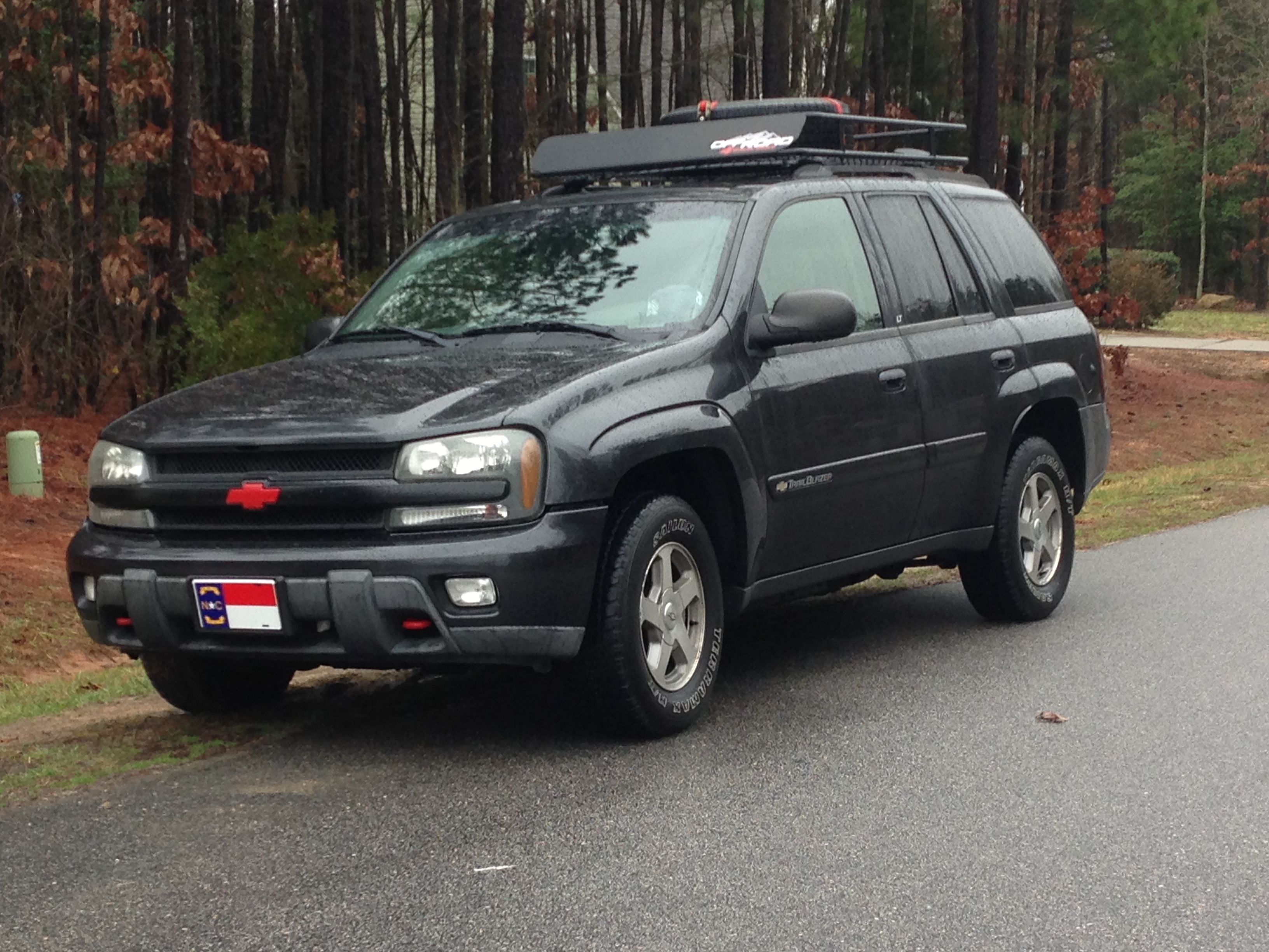

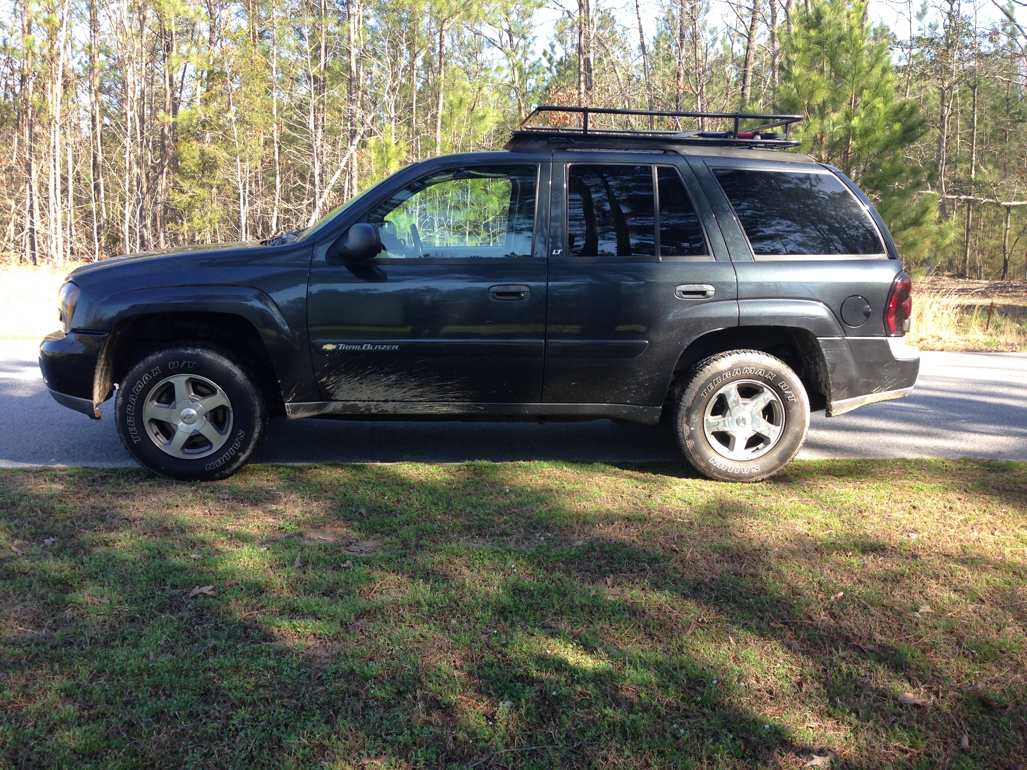

My name is Avery, and I am from Youngsville NC. All I have done to my 2003 Trailblazer so far is add a 2 inch leveling kit, add a roofrack, and some painting.
I plan to add 1.5 inch spacers soon and go to some bigger tires. I am a college student so progress is sow as incoming money is slow!
I am new to vehicle modifications so I am a little out of depth here, but I feel like I can get a lot of help and have some fun here!
