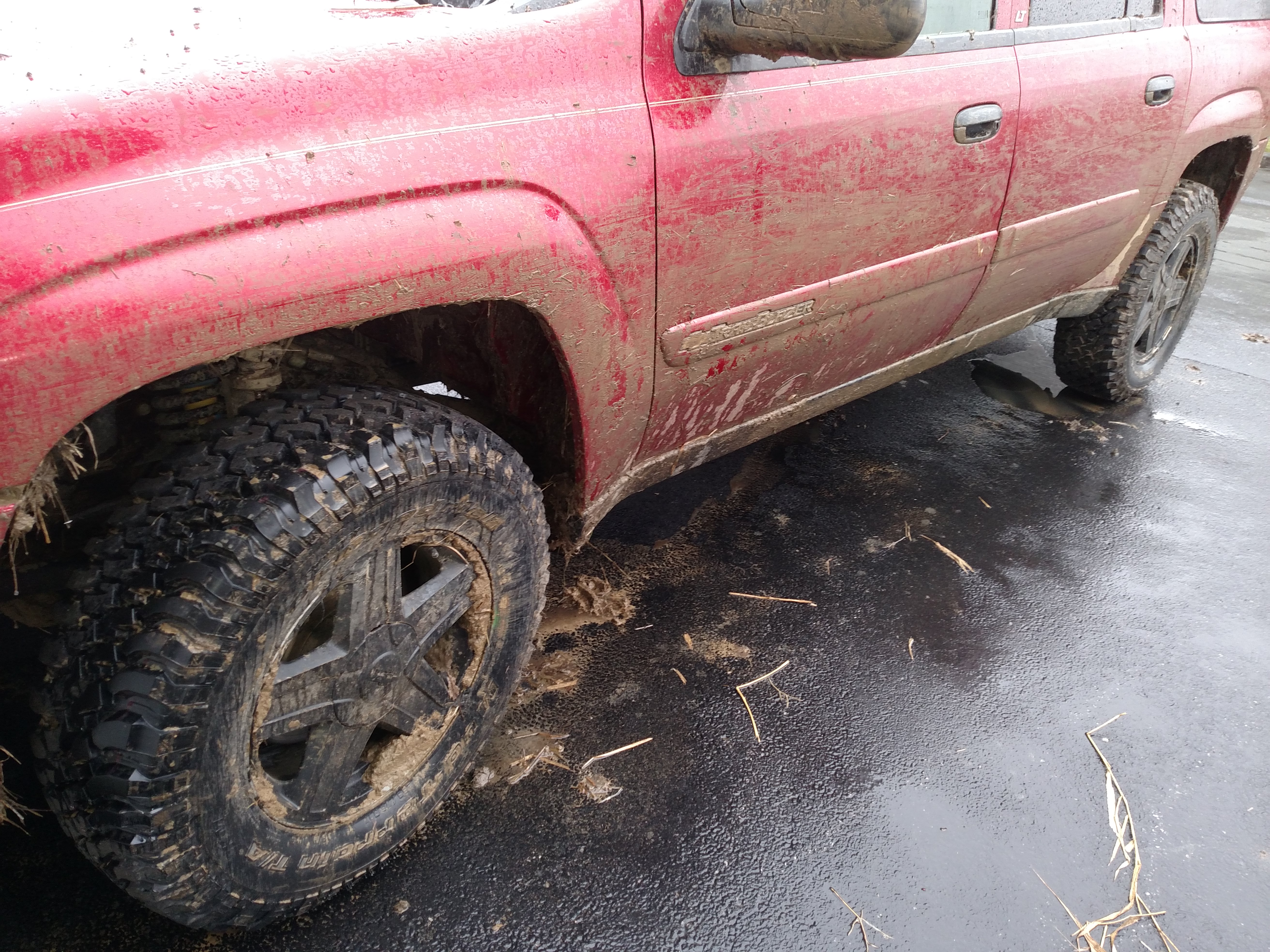

by Mrandersonxd » Tue Dec 29, 2015 11:05 pm
Had a little fun on Christmas

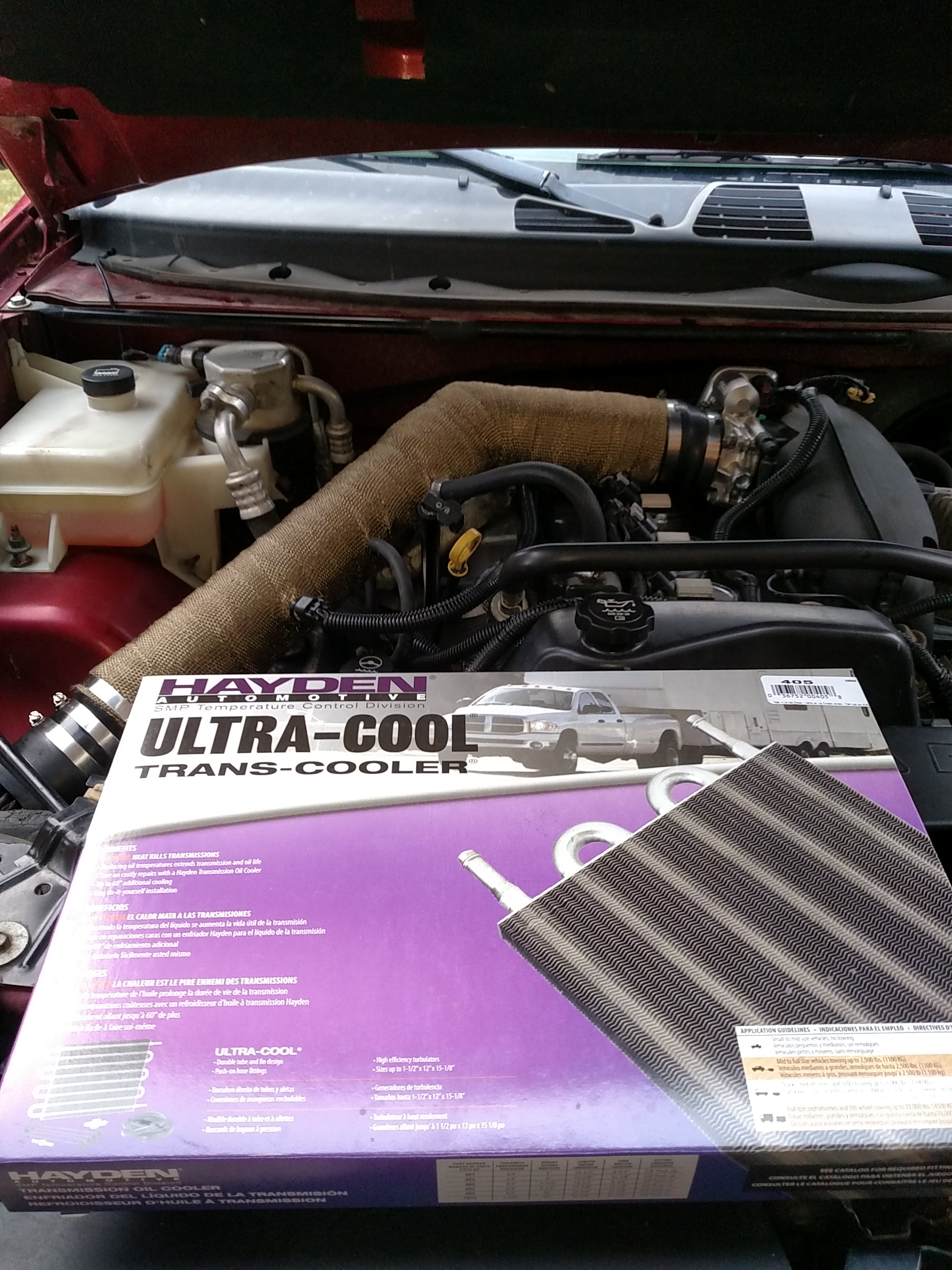

Updates:
PCMforLess tune
New custom made cold air intake
Hayden trans cooler
Rear AC delete
Looped rear heater lines
Had a 5v reference short and chased it down to pcm(tune!)
New throttle body
New fan clutch
Removed washer fluid reservoir and relocated to rear(used the rear fluid line and ran new wires to a universal tank(will post a write up when I have time)
New brake pedal switch(brake lights were stuck on unless I got under and moved the switch around)
Next projects:
Junkyard rear hatch(my 3rd brake light and trim flew off on the highway and I have bad rust)
New tail lights(cracked)
3.42 -> 4.10 gear swap
CV axles +4wd disconnect

The trans is very nice. Put around 7500 on it so far. The trans fluid looked like it was straight out of the bottle when I cut my lines for the trans cooler.
The hardest part of the trans install was getting to the exhaust bolts. I used a long extension with a joint in it. I lowered the trans a bit on the trans jack and once I caught it on the bolts I attached my impact and pulled them out. Getting them back on was a real task. Maybe someone has a better method but I needed to get it done in a small window of time... didn't look on the forums at all.
My cooler lines are what failed and caused my trans to fail. I would recommend replacing them and not put the "shields" back on. The leaks were inside the shield.... great design. Pretty much traps all the salt and rots away the lines. I used 3 cans of trans flush for the radiator. It was clear halfway thru the 1st can but I wasn't about to take any chances. Use the recommended trans fluid as well!
I did it in 2 days after work.
